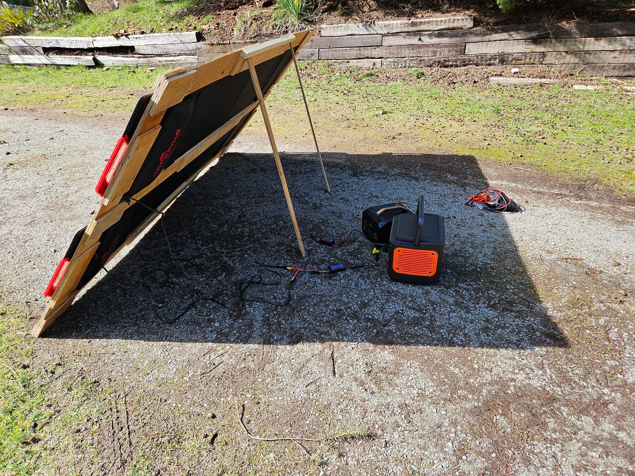

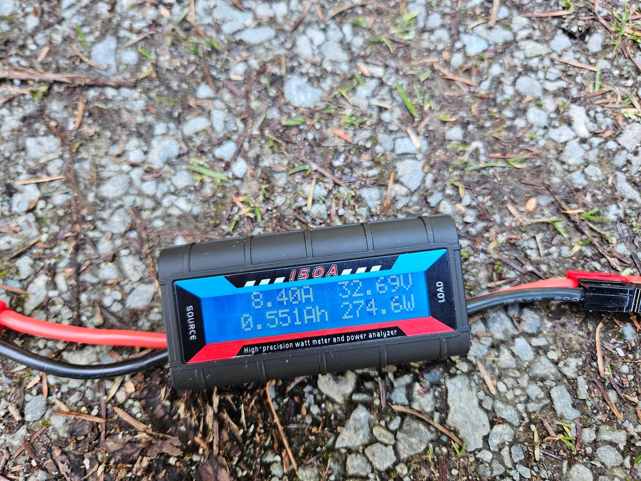

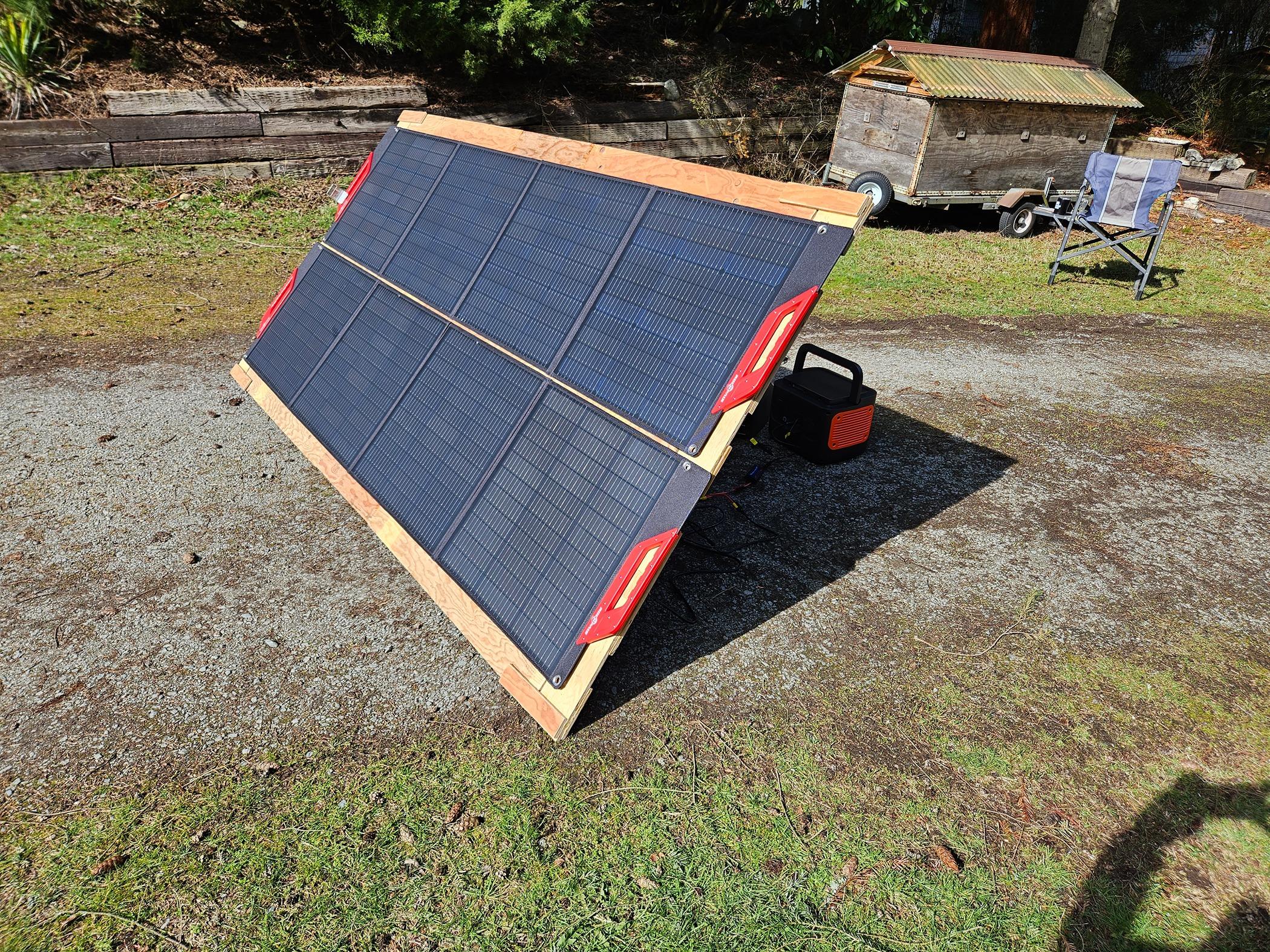

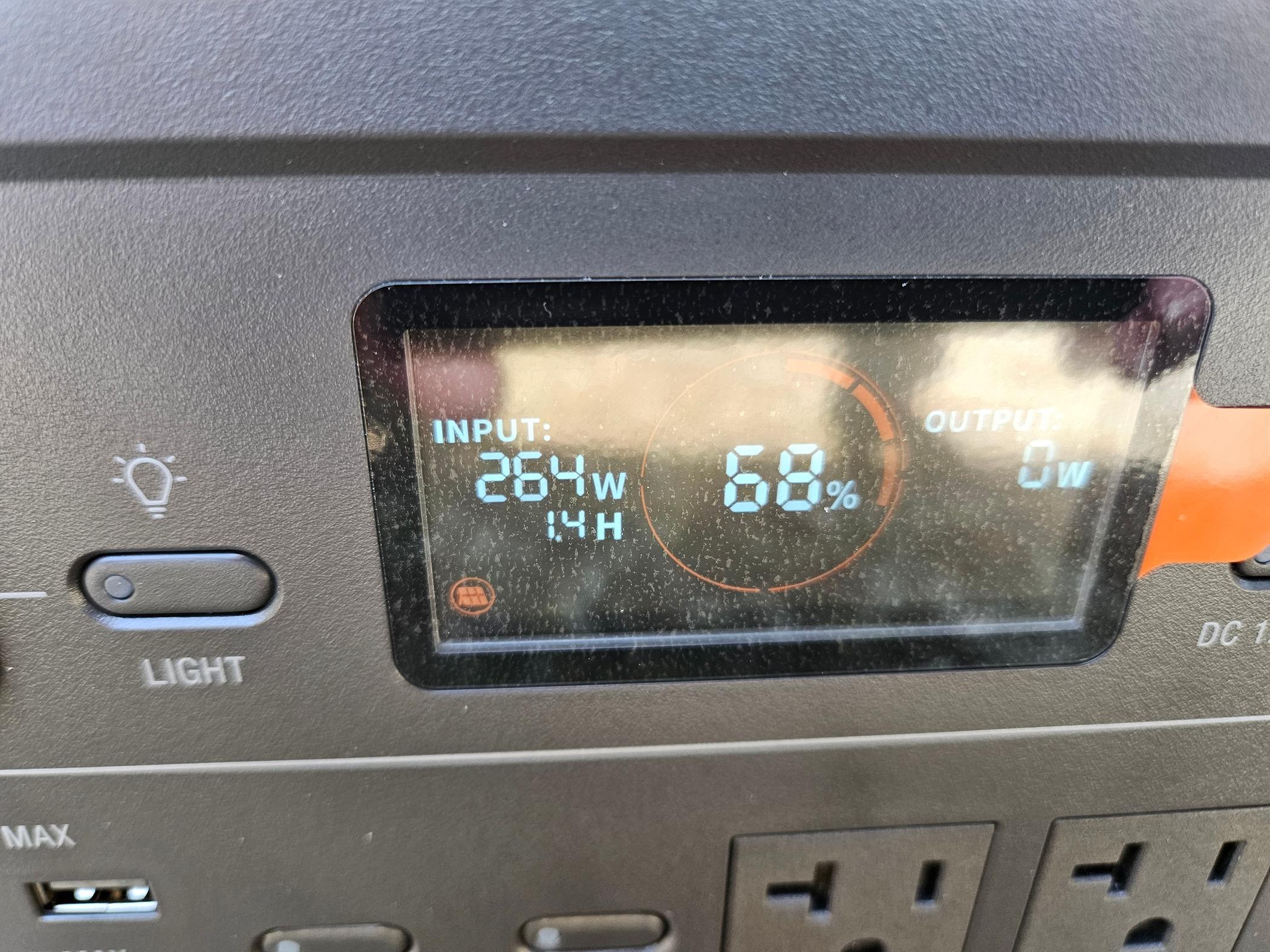

I'm a little late getting to this thread. But let me throw my own opinions. I own two of the Rockpals 200W Solar panels. I have a Jackery 1000 Plus Power Station to go with it. I use this as more of a SHTF, or Ham Radio Field Day setup. So how well a CT will take the power from whatever system is used, is beyond my knowledge. But here's a few interesting things to know about using Solar Panel with a Power Station:
1) Getting the panels setup and in the right orientation to the sun is not trivial. My 200W panels fold nice and compact. But I need both setup to be of benefit. And doing it solo is surprisingly more of a pain than it S.B.
2) to solve that, i built a framework to setup both panels together. I'll attach pictures. The frame breaks down Relatively small. but it weighs 30 lbs. Each Panel weighs only 23lb. The framework ends up being about 4' x 8' area. So I'm moving around a setup that's 75 lbs for 400W of panels.
3) I tested mine in March, at 47 degree Latitude. So the Sun was at a lower angle than ideal. I was getting 300W total from the 2 panels I put a meter on it at one point it was 274W, 32.69VDc, 8.40A. When a contrail passed a slight shadow, power dropped about 10-20W. Shadows from Trees would make a huge drop. So picking the right spot matters.
4) I agree with using a "Solar Generator" as a pass-thru makes sense. But It's easy to get big losses from the Invertor in them. Internally everything is DC. So getting 120VAC out has losses. I ran a CPAP off 12V, and it lost 190 Whr in 8hrs use. I then ran the same CPAP on 12VDC, it used 22Whr in 8 hours use. I believe the design was made for high current devices running for relatively short time periods. Like microwaves and such. I don't really know what the losses would be on a Pass-thru situation charging CT.
5) As someone else posted in this thread, Theft of your setup is something to keep in mind. Even if the solar panels are bulky until broken down, the Solar Generator is a high dollar, portable device. Mine weighs 32 lb and cost $900. the panels each cost $300. So if you just want to hang around camp, not a problem. but in my experience, around folks at ORV parks there are wheelers who will steal if they think they can get away with it. If those same folks go overlanding, nothing is sacred.
