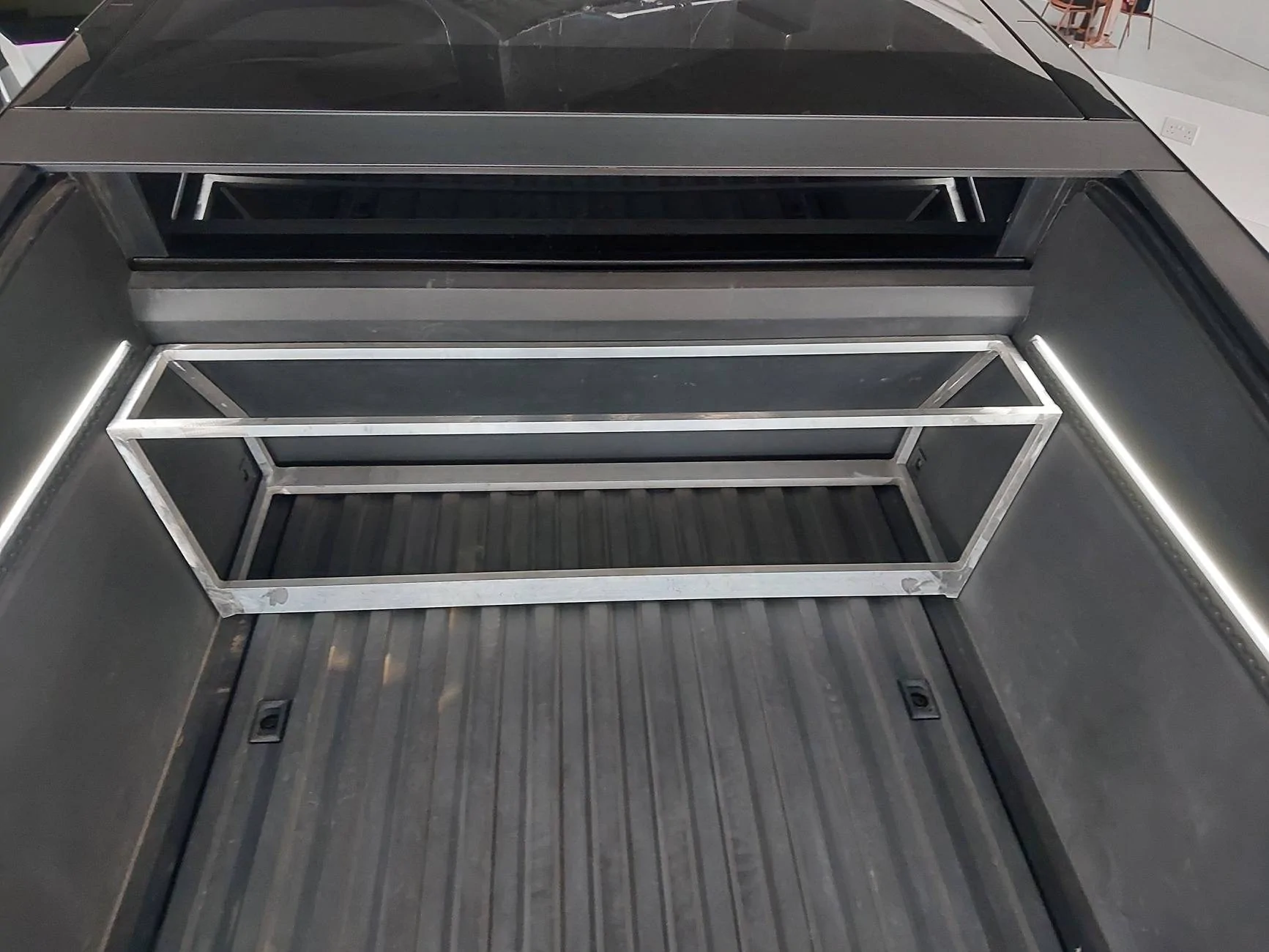

Hi everyone! We are working on removable power bank for cybertruck for camping sites / last mile recharge option with supply 220vac max 5kw to mobile connector. The battery configuration either 14 kwh (which can be handled without crane tools by 2 men) either 28 kwh - need a portable gooseneck crane for lifting into the truck bed. Composed with 12kw peak / 5200 w continious output inverter and charger.
Device in a development phase, all components have been tested and shown a good performance. We plan to accomplish the fully working prototype within a month. All drawings and details of will be available upon completion.
A picture illustrated the frame position in the truck bed.

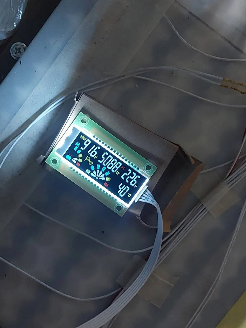

First test performed to charge the truck from powerbank prototype using mobile connector at 220v, 5kw/21A 90-20% approx (average cell voltages 4.09-3.34 v for 24s bank ) resulting to 40kms of range added. Still working on fine tuning on inverter cutoff voltage to maximise the battery potential. For the prototype a model 3 standard range battery module in use 14kwh capacity.
Remaining tasks are to produce@ seal the enclosure with face panels and route/fix all loose wires, install a few accessories and prepare for test run. Hope to get it done within a few weeks, as this is a free time project ;)
