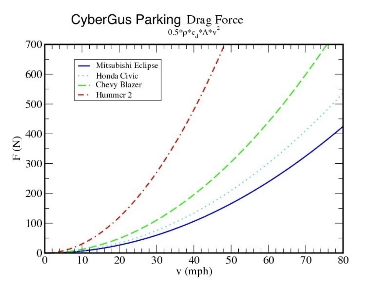

7,153
13,769
My M3 can get better than the stated 205 watts per mile. My city average is 185 watts per mile.
my highway average is 267 watts per mile at 80mph and 250 watts per mile at 75mph.
case in point of
Specifically, people familiar with Tesla sedans shouldn’t be too quick to think that your experience to date will tell you everything you need to know about the CT.
again:
Tesla Cybertruck Range for AWD Cybertruck 200-250 miles after many real world tests 7758652B-CBDB-4548-8E72-3567D4ABDBA0
plus tires, plus gearing differences, etc., all amounts to a BEV truck is going to behave very differently from folks previous experiences with Tesla sedans

case in point of
again:
All you are doing is showing the effect of different drag coefficients on the vehicles. There's nothing here of Trucks vs Cars. The Cybertuck has an awesome drag efficient of about 0.34.
Tesla Cybertruck's Claimed Drag Coefficient Of 0.34 Put To The Test (insideevs.com)
No, it's not as good as the Model 3 of about 0.23.
But significantly better than that of the Ford F-150 of 0.44 and the Hummer EV of over 0.50

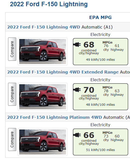

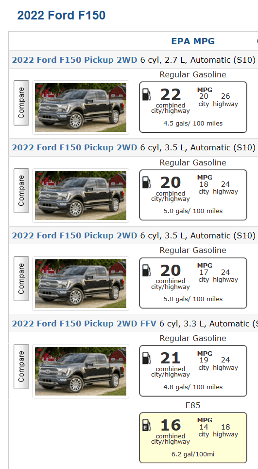

ICE vehicles also use less at lower speeds.
Specifically, ICE are worse at stop and go type traffic in cities, where the car is stationary with the engine idling. EV's only need to run their electric Air conditioning and heat pumps, just like hybrid cars.
ICE use less, but they still use more per mile. And stoplights kill them, hence the reason why so many manufacturers are using stop-start at traffic lights.
A Model 3's range peak around 35mph. ICE numbers are well above there.
From fueleconomy.gov
Tesla Cybertruck Range for AWD Cybertruck 200-250 miles after many real world tests 1704044361923
Every number is much better on the highway than the EV below.
Tesla Cybertruck Range for AWD Cybertruck 200-250 miles after many real world tests 1704044292213

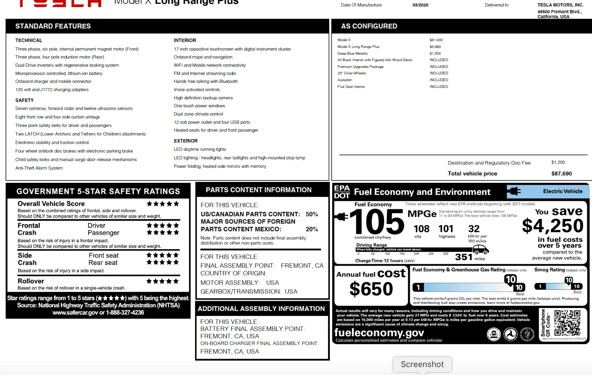

7,153
13,769
If Tesla is really using City EPA range only (which is dumb on various levels in my book)
no, because they’re reporting only a single figure, it’s is almost certainly the blended EPA headline number - the “combined city/hwy”
see eg this Tesla Monroney
Tesla Cybertruck Range for AWD Cybertruck 200-250 miles after many real world tests 5777840B-8D39-49B2-A45C-861E8D23BFAC
note the headline EPA figure of 105, blended, but off to its right the sun-year figures for city and hwy
Point being, using eg the Foundation Beast (on AT) tire data we have - 301mi, that figure is almost certainly the extrapolated resulting range from the EPA’s headline blended figure, and not yet even the EPA’s pure hwy figure for the CT on ATs
Here’s a parallel example:
When talking about the Lightning ER, people always cite the blended EPA of (all ER trims, except of Platinum): 320 miles
But the EPA’s hwy-specific figure is 283.1 mi
While the EPA’s city-specific figure is 350.2 mi
This range of outcomes, eg 70mi delta, is a full 20% of the EPA blended headline number of 320mi
speaking in generalities, that delta is as large as it is because we’re here talking about a truck on large tires - one wouldn’t expect such large city vs hwy vs blended deltas out of a BEV sedan because
Tesla Cybertruck Range for AWD Cybertruck 200-250 miles after many real world tests 3FF73F86-9603-410E-BF92-8A70A65FA17B
Which brings us back to the CT.
The 301mi figure we’re seeing from Tesla is almost certainly the EPA blended. Using the Lightning as a baseline for trucks on large tires, we might expect the CT’s epa hwy to also be ~88% of the epa blended, or 264mi
(while the CT has eg better aero than a Lightning, the Ct has bigger/worse tires for range, so net-net…)
Now remember the EPA hwy test speed is only 48mph
So 264mi at avg 48mph, only goes south from there, exponentially, as speeds get higher.
and that’s at idealized EPA test conditions.
So yeah, when Tesla reports 301mi range on Beast with AT tires, people agile with EPA figures (and BEV trucks) should be able to immediately extrapolate that one could very easily see only ~200mi max range in real world hwy conditions, and driving styles
