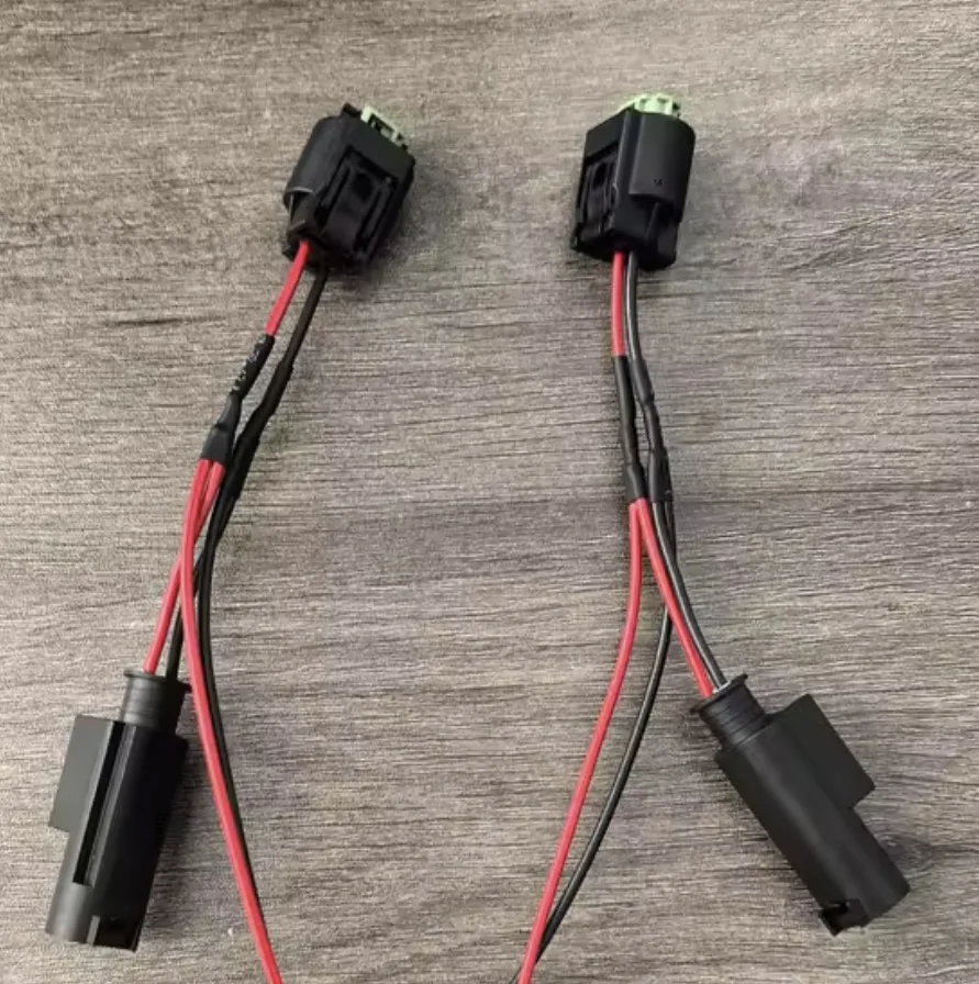

The reserve lights are 12v not 48. Have plug and play harness for the reverse light, simple easy morimoto boost bar add on.
How hard is it to get to the reverse light wiring?
F150 it is two bolts on the side and super easy, not sure on the CT but could sure use more light when backing up and that Morimoto looks like a nice option.

Did you just mount it to the license plate?
Just curious why you made 2 adapters? Or is it just one and you showed both ends? Just don’t understand why there are 4 total connectors? I feel dumb :(
The kits came with 4 so I just made another adapter for my brother’s CT

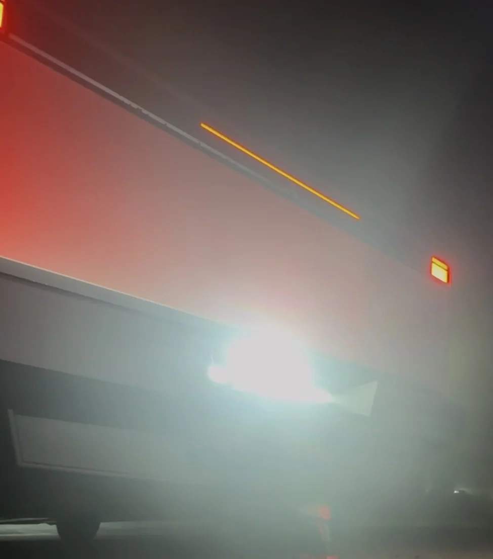

Defiantly a nice plug and play upgrade! No trailer light and no errors.
