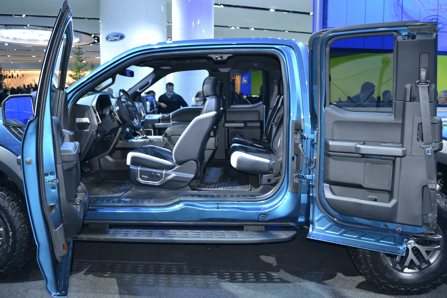

Image is from a quick Google image search of "rear hinged doors".
This is common on “quad cab” or “access cab” configurations of trucks. The body on frame architecture and smaller opening allows for a deletion of the B pillar. I highly doubt cybertruck will get this because They’ve only shown CT crew cab configuration, you never see rear hinged crew cabs, my suspicion is the ergonomics of full sized suicide doors are not ideal for parking egress and crew cabs need B pillars for rigidity. CT will especially need the most rigidity because “the body is the frame”.
