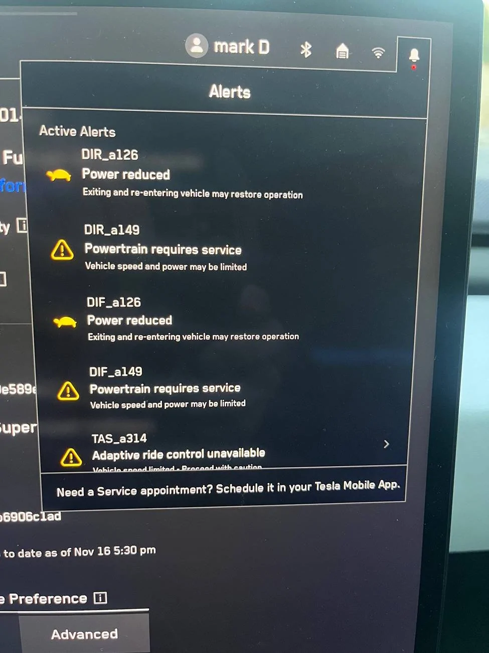

ogdobber
Mark
Jul 16, 2024
51
Mine is vin 14xx, delivered in feb. Failed yesterday, truck still drove but this morning truck is completely dead. Getting towed to service center in the next hour
