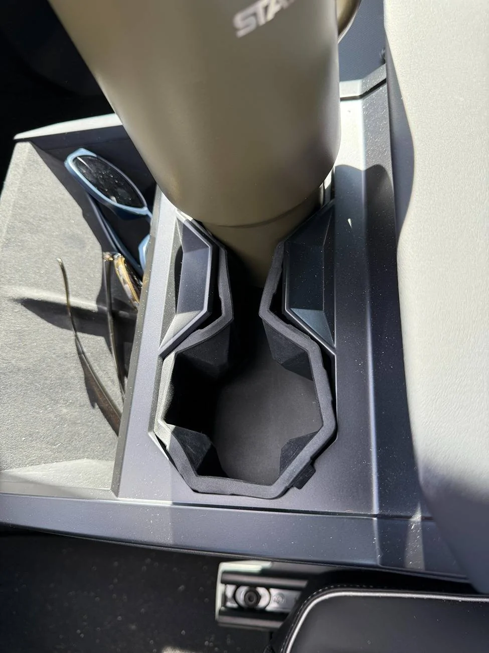

Side note: WTF is up with the cupholder liner? Mine just collapses in whenever I put something in there.
That's not a thing. My cupholders have spring-loaded sides, but I assume that's not what you mean by "collapse"

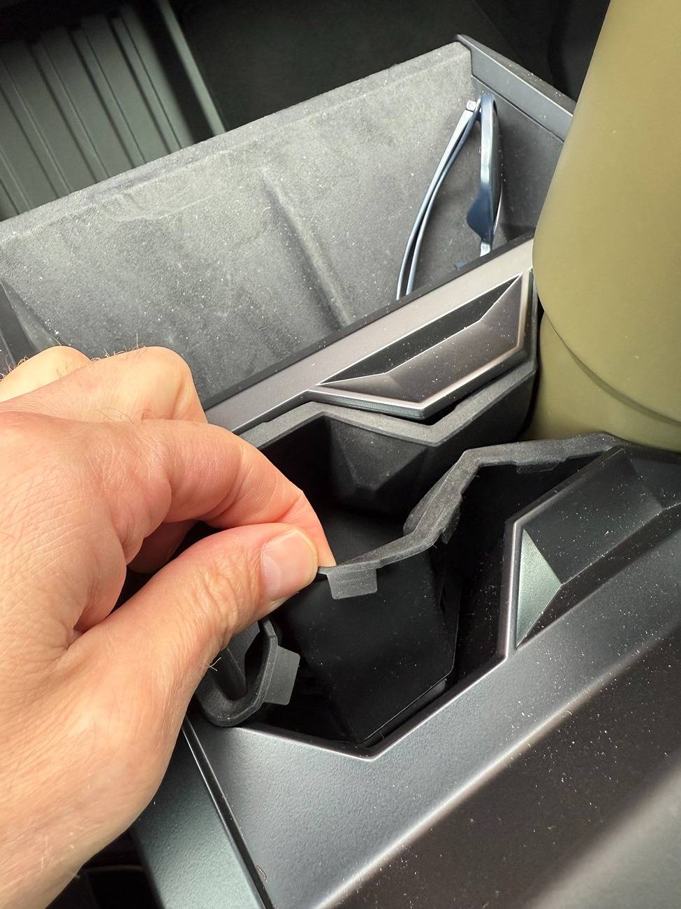

On the cupholders, yours sound awesome. Mine just has a silicone liner, with little tabs that ostensibly hold it in place...but they don't. I'll send a pic.

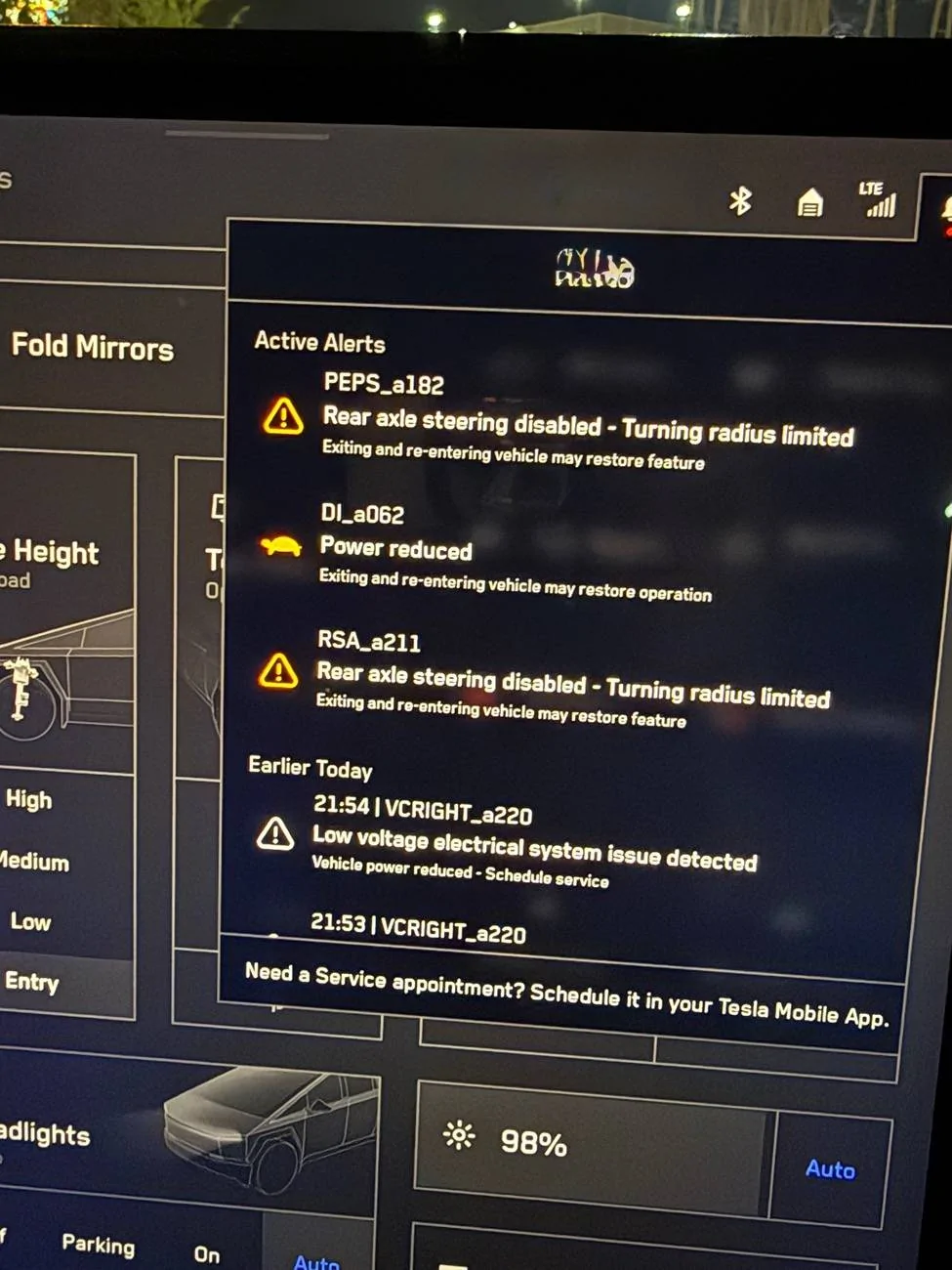

I have the same issue that has been becoming more frequent in the last 2 months.
However,my critical alert is related to the low voltage when using the outlets in the cabin or bed. Seems like an issue with the PCM (Power Conversion Module) that converts DC to AC and when that module is faulty, it seems the rear steering actuators are also connected some how, causing the Critical errors.
In my particular case, I tested it without using any AC outlet for a week, no errors whatsoever so ever.
The day I am driving it in for service I try to plug something into the AC outlet. It eventually gives me a critical alert, pull over immediately. I have also tried it with multiple devices such as a compressor fridge, Ecoflow Delta, Ecoflow Wave, all with the same result.

Thanks for your response! I may see what warning, exactly, was given, on mine, but I think it was the "rear axle steering disabled," as yours was. Are you taking yours in, then?

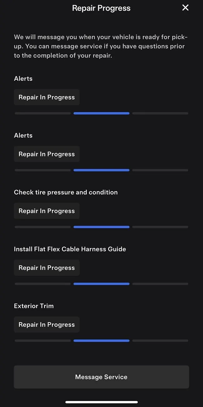

I have. It’s been in service for about 4 days.

This is what my cupholders look like. Pretty terrible.
Ah, man. Now I see what you mean. I think it is an easy fix with a plastic pry tool maybe- but even easier the next time you go in for tire rotation, take it to SC maybe. But in all honesty, when the cup holder works as designed, it death traps your drinks in them to the point that I flip my Dunkin' lids and feel like I'm going to dig through the sides of styrofoam cups.

The cupholder just 'clips' in with little rubber tabs along the top, but they pull away easily if you put something larger than a regular soda can or water bottle in there. Yours looks the same as our @HeWasaLonelyGhost , or at least, the same when my wife's driven it, and before I patiently tuck all the tabs back in. Tesla is pretty good at a lot of things, but cupholders, rain sensing and phone charging are not a strength.

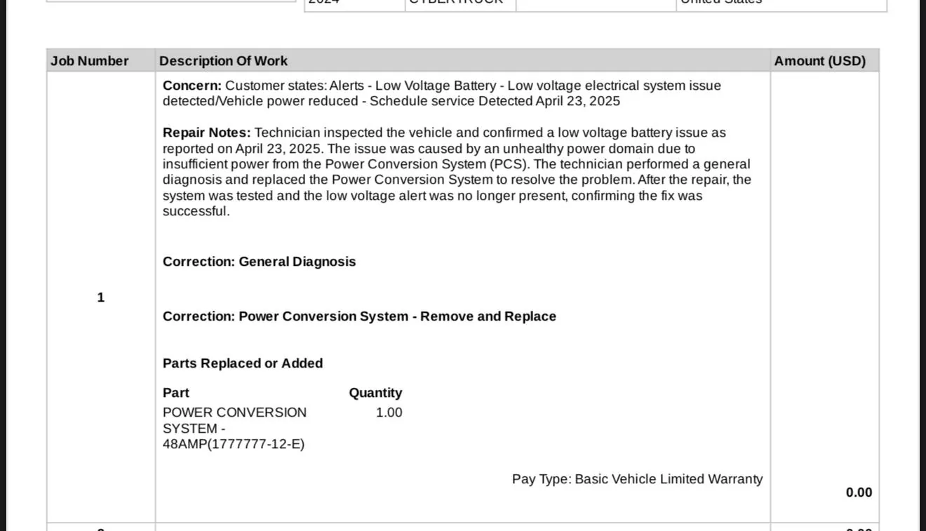

Just received a message in the app that the repair was completed. The PCS was replaced by the service center which say resolved the issue. I haven’t picked up the vehicle yet to verify.

? Okay, I think that's all accurate. I do put the little tabs back in, and I've also tried just taking the whole liner out (works well enough...but is too large of an opening, and everything slides/wobbles around), but within a day or two, they're back out. I'm looking at aftermarket inserts, but it's hard to tell what would be an improvement.
Nice! Seems like a decent turnaround time. Hope that fixes your issue.
