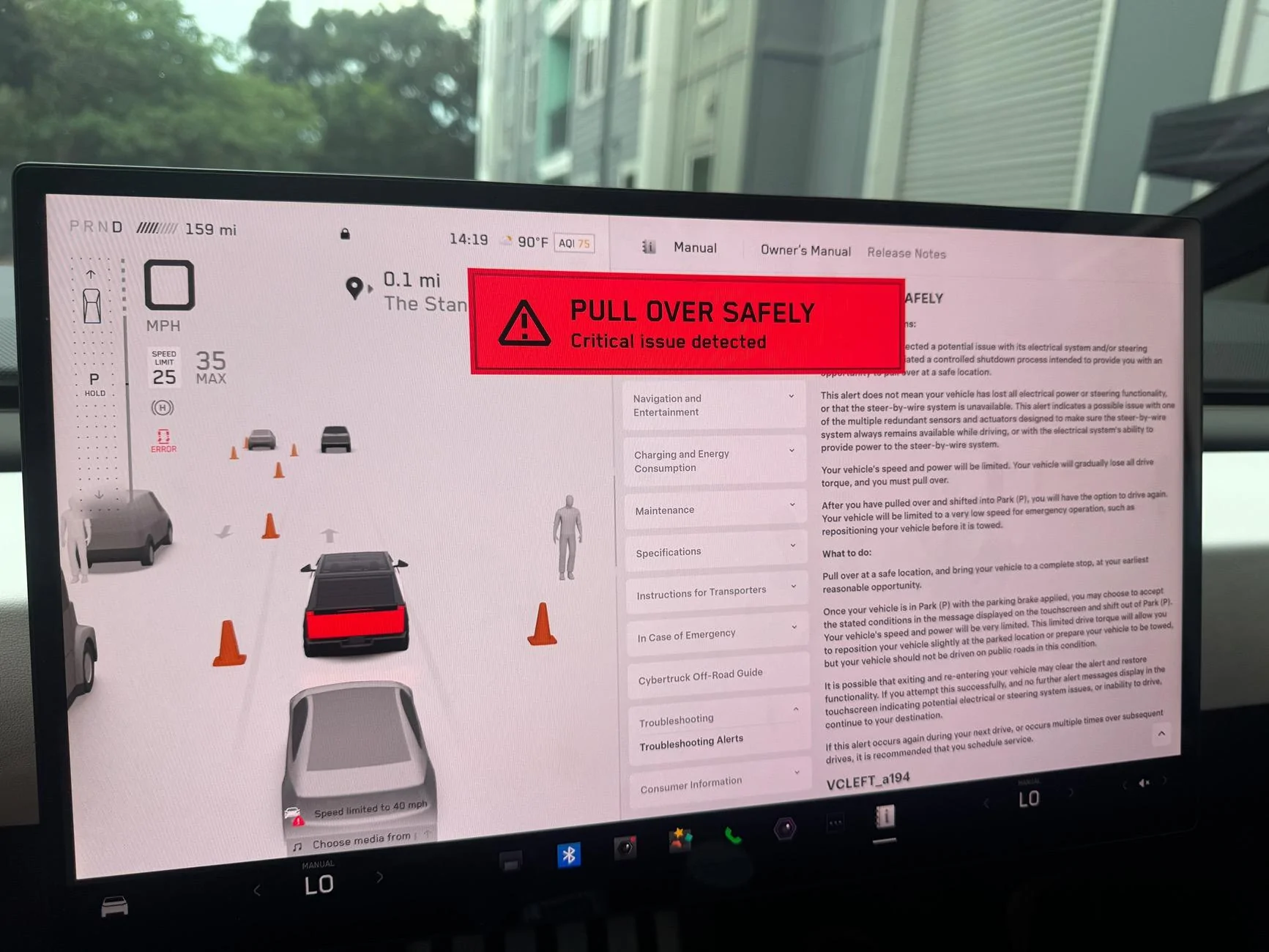

I only have anecdotal evidence, it's true. And I understand that happy CT owners aren't posting as much as those looking for help/info on an error. But, if there are 5 or 6 or 10 people on the forum who have experienced a "critical error detected" problem, that's still 5 or 6 or 10 out of the pool of ~25000 trucks, which seems like more critical drivetrain errors than there should be. And that's just those who bother to create an account and post here, so there's an unknown multiplier on the error count.
I'm guessing Edmunds didn't post about it here, but have you seen the latest Edmunds Cybertruck Review?
Don't get me wrong - I love the thing, and it's my most favorite thing to drive by far. I'm just not going to fully trust it until I get a few more thousand miles and a few more months on it along with all the other early adopters. I fully believe it'll be rock solid, but I also believe Tesla is still learning things and tweaking this brand new platform and build process.

This happened to me last week after an hour drive on a redlight. I was able to move to safe location, got out of the truck, waited for 10 mins and drove back 70 miles to Service Center. The technician thinks ot maybe firmware bug they decided to keep the truck and gave me a loaner.
it has been a week and I haven’t heard back from them yet, i am assuming it is part related and they don’t have the part in hand.
while enjoying my 2024 model s loaner with fsd, i am still hoping to get my truck back soon.
posting this for awareness.

Another update. Power Conversion System replacement didn’t fix it so they are continuing diagnostics.
Oh man, I am so sorry to hear that. Mine is just entered the 4th week at the service center. Master Technician is working on it. It says September 6 pickup but that has changed so many times, i still have no hopes.
Thanks for updating your case. I'll do mine too.
It says waiting for parts on my "repair progress" on app.

I also told them about 2 NHTSA recall letters, which they will change wiper motor and Replace LH and RH Sail appliques

Hey i think this issue is so rare. I know all the other CT owners traveling and driving all the time. Even as we all know 3 owners went to Arctic Circle from Miami. I just went 70 miles north. Less than 3k miles on my CT, it has been in service almost 4 weeks. I am hoping they'll diagnose and fix the issue. Since this is my 3rd Tesla, i know they will find the RCA but its just a luck i guess. Also being so new they dont know a lot either.

Update on my CT service. After 25 days CT being in service center. I did receive a call and talked to Master Technician who worked on my CT. He said they could not reproduce the issue but check all the components of the truck which all components were not faulty. They’ve replaced the ribbon cable that connects from front to back all bus communications. They’ve asked me if they could take the Ct to long road test and ask for permission. It is still in service mode but it is on the road and Thanks to TeslaFi and Tesla App i can track the car. If it passes the test, i am able to pickup my CT tomorrow afternoon. Great news. But they can’t guarantee if i am never gonna have this error again. If it happens, he said they will replace most components.
i can’t wait to get my CT. Pretty happy. I am hoping that ribbon cable was the problem.

Update on mine. Neither the new power conversion system nor the new harness fixed it. They’re consulting with a Tesla engineer now trying to figure out what’s wrong with it
