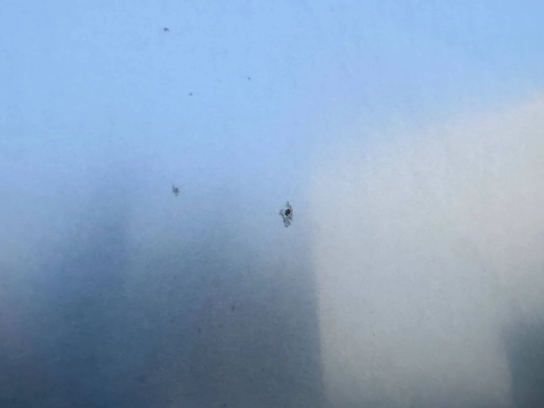

Obviously different than a wrap, but I had a 2’ magnet on my door for a week (advertising a league I run) and it left rust or something in the metal. Couldn’t be removed by washing or ironx. Used BKF and was able to get most out in a couple rounds, but if I went far enough to get all the way out I would have had to really work it on all panels, so left those spots more buffed than the rest and still have spots in the metal.
