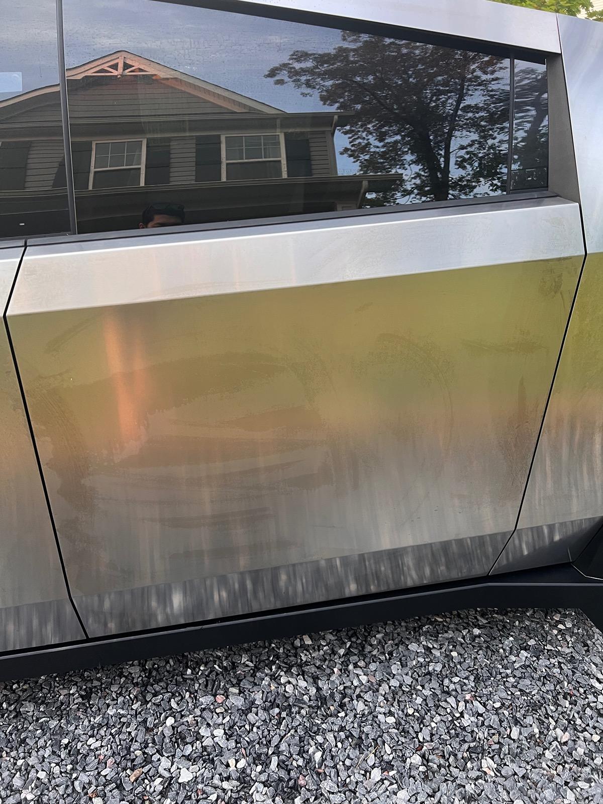

Just picked up my CT and it was not detailed for pickup. Gave it a was and noticed a lot of these streaks and dark spots. I got some citisurf and that didn’t seem to do much. Without having to go to BKF, any idea how I can make this not so crazy looking?

I’d try the Citrisurf again, and use the blue ScotchBrite pad. I had similar discolorations and it took multiple applications, since I was treading lightly.
BKF liquid is similar, but is a bit more aggressive. In either case, don’t let the product dry, and rinse thoroughly to remove.
Citisurf with some elbow grease definitely worked. Took way more work than I realized ha. Not sure wha the blemishes are but it was definitely a pain to work out
