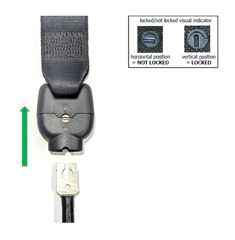

Hey all. I just got my 2025 CT back from service yesterday. I had a cosmetic issue with the front passenger seat where the seatback wasn't installed properly at the factory.
Today, my daughter and I were out running errands. At one point, my daughter got out of the truck before me. I noticed the seatbelt she was using looked a little odd. I walked to the passengers side of the truck for a closer look and saw what's shown in the attached Pic. I love my truck, but im a little freaked out what could have happened if we were in an accident.

I would report this to Tesla and ask them to check the rest of your seatbelts under warranty.
Weird, that is in the locked position
Tesla Cybertruck Seatbelt Issue - SAFETY - Please Check Yours GUID-555F527F-8D8C-4B67-9E41-9759EB0335A6-online-en-US
Wonder if they took the belt out for the repair you had and then didn't properly reinsert?

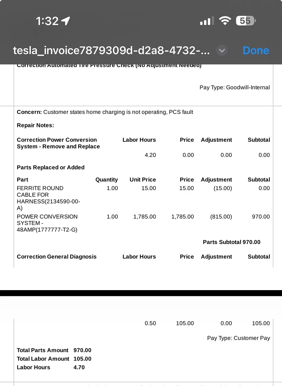

nice man, I’m not hating it sorry if I’m coming off negative. Just insane to have so many issues is all, I know it’s first gen but still, I now have the pcs issue myself, super uncomfortable about it. What if it happens again when mine is out of warranty you know
its 1,075$ for the pcs and a harness, its not too bad cost wise. and if you on a trip supercharging still works if your software is 2026.2.9.7 or greater (that’s when they updated it to allow supercharging if it fails). they give you 90 days free supercharging too, so if you put miles on it, take trips to cedar point etc, you can break even or close to it. I travel a lot with mine, should be able to spend 1k on charging alone.

I'm telling you man how the hell are some of the people at the service center allowed to ever work on cars... You turn the seat belt screw in the unlock position and put it on and THEN pull it as hard as you can to make sure it doesn't come off, that is what the tesla service manual says to do EVERY single time when you remove a seat belt
