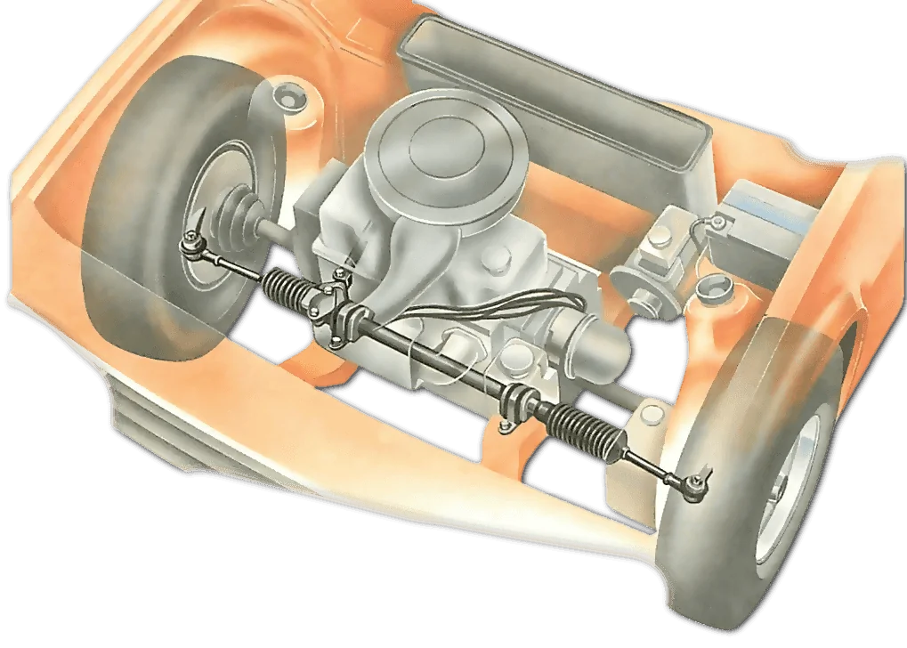

A steering rack has no parts on the sides of the wheels, it's all inbetween the wheels parallel to the axle and barely takes up any space. The side sails likely fold upwards like a hatchback.
I don't think the rear-wheel steering on the Cybertruck will use a traditional steering rack. I think it's more likely that the steering will be driven by independent electric motors, one for each wheel. There is a lot of potential for clever engineering here and we have no idea how Tesla will implement it. Rather than rack my brain and figure out ways Tesla could come up with innovative solutions, I think I'll just wait until the first tear-down is published. If I had to guess now, I would say they might use linear actuators that they manufacture in-house for the specific application.

The main support for the bed was always the inside bed wall, not the outside wall of the CT. So even now with the cast it can open storage outwards. There's about 3-400l on each side that they can't use for anything else. Regardless, the storage is not gone because of the steering parts, there are absolutely NO steering parts in the sail areas, and I can't imagine technically any reason to put the steering in there at all, there is no geometry that works to actuate the wheel steering from there. A simple rack and pinion, likely drive by wire, will suffice and be the cheapest option by far.
On every new model, Tesla is becoming their own supplier for an increasing percentage of the entire vehicle. That's less parts to spec out to suppliers, less parts to ship, and less parts to purchase. This is a primary reason why Tesla is able to offer new vehicle buyers more value than any other manufacturer. None of the rest are willing to innovate in such a bold manner.
There is no reason whatsoever to have a non-Ackermann geometry and linkage and go with individually steering wheels. There's also not enough wheel clearance inside the wheel wells for enough angle to do diamond steer or any other fantasy people might have.
There is also no way to actuate the wheel steering from around the corner from the sail area, without using a steering rod that has the right geometry to follow the suspension stroke precisely, to avoid bump steer. If a steering mechanism is incorporated in the wheel hub on the wheel itself, it will add to the unsuspended mass and be subject to more ride harshness, so would have to be built even tougher. Besides both wheels need to track eachother, Wheel alignment is nigh impossible, let alone compensating for failures.
