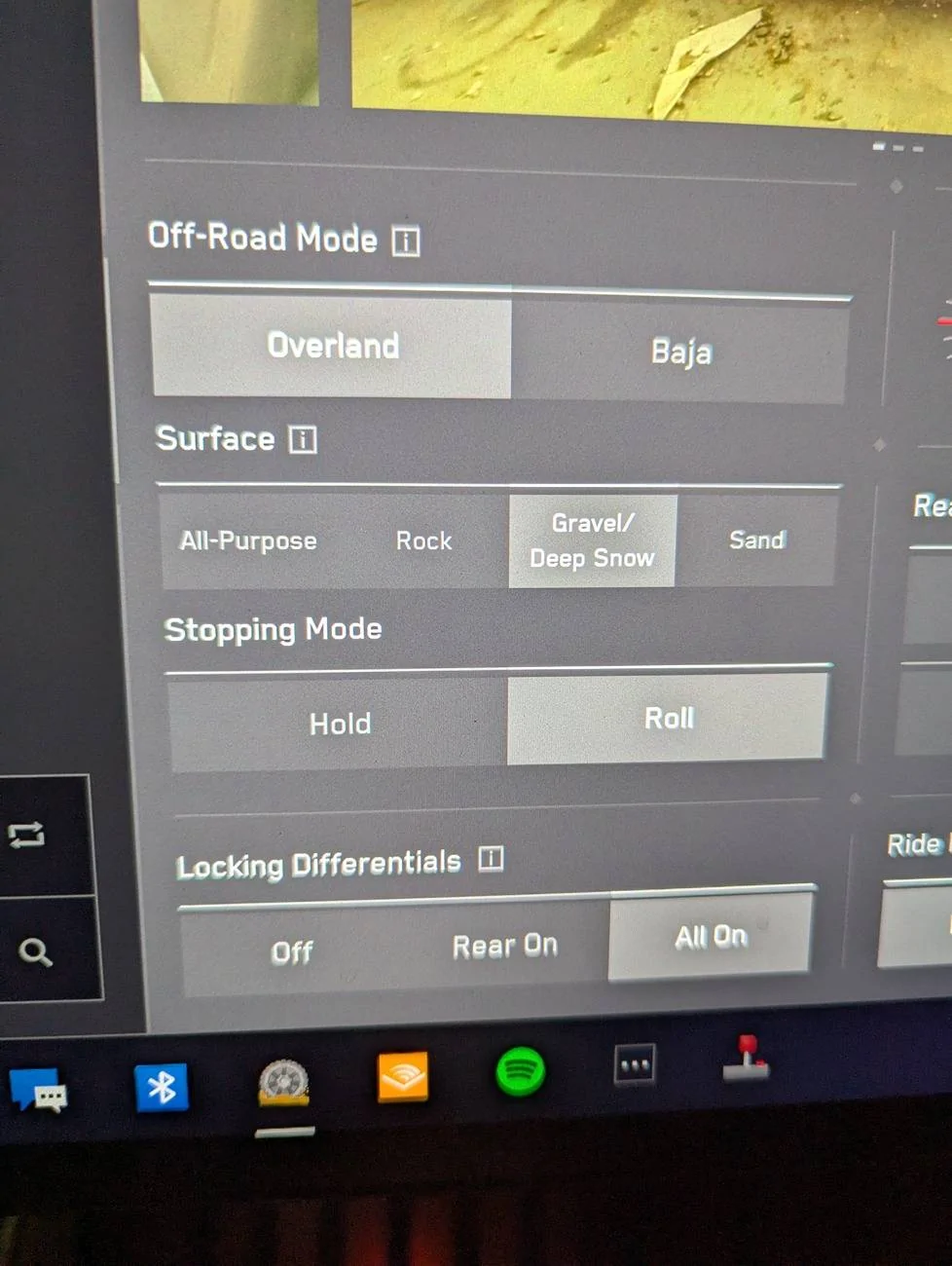

I'm a little confused by this, in snow offroad mode you just set stop to "roll" and that goes away entirely...

Wow... Uhh well here you go anyway, let me know if this helps you. These are the settings you're looking for to drive as you described.
Tesla Cybertruck Settings for Snow Driving PXL_20250103_193502396

What’s the difference between roll and stop? Sorry not sure if I understand them.
Thanx. I forgot about this!

Yep... regen on an EV is the same as a jake brake or auto air brakes on diesel trucks. The number one rule for air brakes/jake brakes is turn them off in snowy/icy conditions because they may cause you to slide uncontrollably when they engage. I am hoping the offroad setting for stopping mode roll turns it off, because yes, regen can be dangerous just like a jake/air brake.

Stop is regen mode and roll has no regen.
Not true.
Hold
Applies the brakes automatically when Cybertruck stops, without you having to put your foot on the brake pedal. Whether stopped on a flat surface or a hill, Vehicle Hold keeps the brake applied, provided your foot remains off the accelerator and brake pedals.
WARNING: Never rely on Hold to adequately decelerate or fully stop your vehicle. Many factors can contribute to a longer stopping distance, including downward slopes, and reduced or limited regenerative braking (see Regenerative Braking on page 87). Always be prepared to use the brake pedal to adequately decelerate or stop.
Roll
Allows Cybertruck to roll freely when close to, or at, a complete stop, like a vehicle in Neutral. Therefore, if stopped on a slope, Cybertruck will roll downward. The brake does not engage, and the motors do not apply torque (until the accelerator pedal is pressed).

so...roll - no regen, hold - regen,

Regen is on in both settings.
It just has to do with what happens when you come to a stop. It's either on ROLL, which is similar to being in neutral and your vehicle will roll if not on flat ground, or HOLD, which even when on a slope, will keep your vehicle stationary until you press the go pedal.
