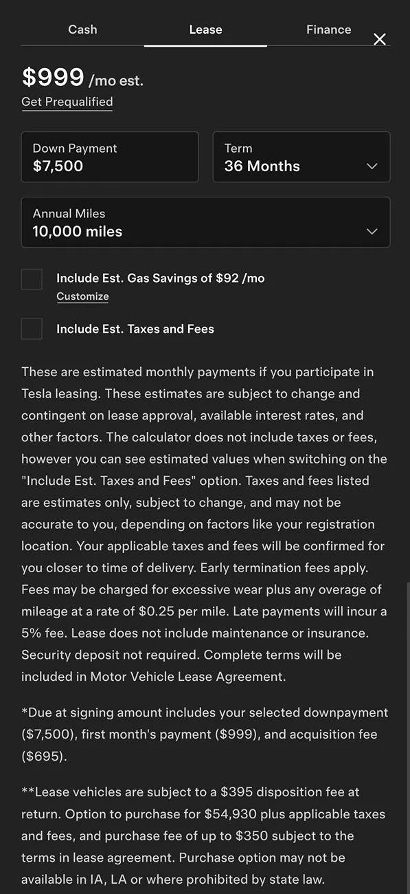

I will lease and buyout in a month or two. Leasing for 2 years is insane. You pay $22K in interest (because the MF is basically 18%) and only $5K in depreciation because of the high RV. I think 3 year leases are slightly better with 14% equiv MF but still terrible.

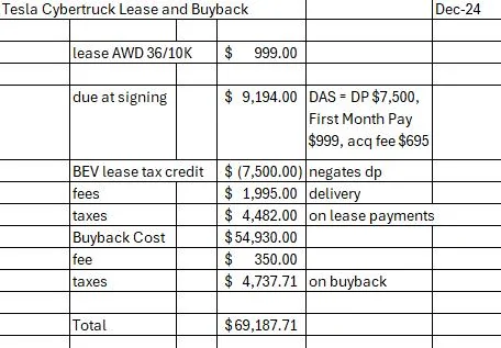

With the current lease buyback offer, can someone check my math?
scenario, lease CT AWD with immediate buyback to capture the $7500 fed EV lease credit
I’m pretty sure the buyback number is after all payments are made…

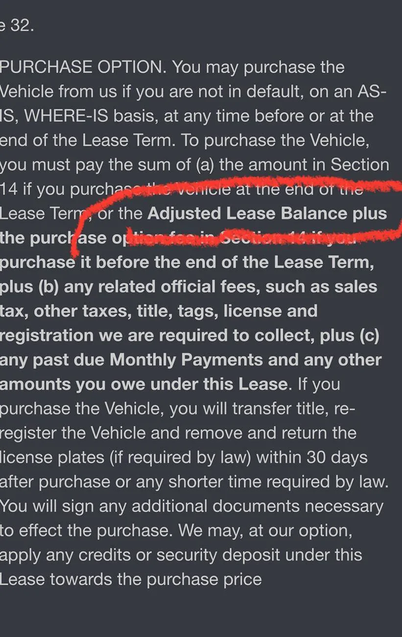

I am not sure you could do buy back in a month or two, unless they expressly said so.
Clause 32.
  1. PURCHASE OPTION. You may purchase the Vehicle from us if you are not in default, on an AS-IS, WHERE-IS basis, at any time before or at the end of the Lease Term. To purchase the Vehicle, you must pay the sum of (a) the amount in Section 14 if you purchase the Vehicle at the end of the Lease Term, or the Adjusted Lease Balance plus the purchase option fee in Section 14 if you purchase it before the end of the Lease Term, plus (b) any related official fees, such as sales tax, other taxes, title, tags, license and registration we are required to collect, plus (c) any past due Monthly Payments and any other amounts you owe under this Lease. If you purchase the Vehicle, you will transfer title, re-register the Vehicle and remove and return the license plates (if required by law) within 30 days after purchase or any shorter time required by law. You will sign any additional documents necessary to effect the purchase. We may, at our option, apply any credits or security deposit under this Lease towards the purchase price

Key statement, feel you need to have Tesla give that number for 1-2 month lease
Would be interesting to see that number.
Fix my spread as I used the section 14 number of $54K, it’s higher but what is it?

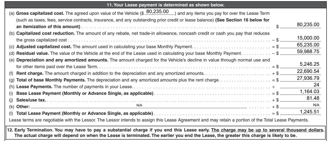

It's all in the contract
" (3) Adjusted Lease Balance: The Adjusted Lease Balance equals the Adjusted Capitalized Cost minus the sum of all accrued monthly Depreciation for each Monthly Period before termination of this Lease and the Monthly Period in which this Lease terminates."
The adjusted cap cost is listed in your contract
Tesla Cybertruck Should I lease or finance? 1732940052284-rg

Can we do a quick estimate? 2 months of depreciation

Just leased a Beast instead of financing because Tesla just enabled lease buyouts. So I get the lease incentive of 7500 off. Then I can buyout the lease. Wife and I do not qualify for the 7500 federal tax rebate, so I figured this lease incentive off plus a 2k dollar referral code made sense. Then I can decide if I want to keep the CT for longer than 3 years, in which case I will buy out the residual. I also maxed out the lease downpayment which was like 24k. I pick it up on MoNDAY....so excited.
You do not get the $7,500 credit directly, Tesla does and the lease numbers already reflect their adjustment due to it. 45W commercial credit not 30D point of sale.
If going full 3yr term, a $80k AWD costs $100k with buyout:
54,930+695+395+7,500+(36×999).
