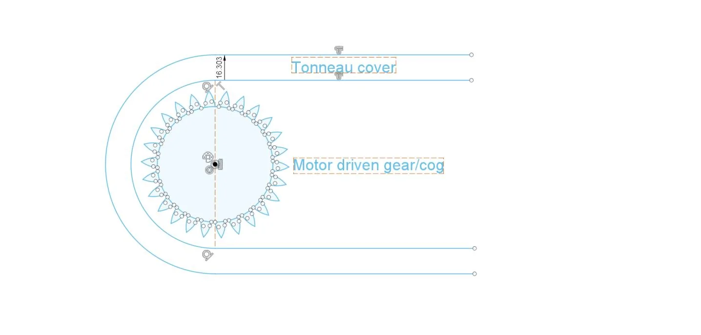

As a followup to what I trying to explain earlier, here is a quick and dirty diagram of what I think it would need to be to have the cover retract under the bed and stay flat, as opposed to being rolled up around a drum. In this scenario, the motor driven cog is stationary and the tonneau cover simple travels "along" that cog. When closed, the bottom end of the tonneau cover is at the cog. When open, the TOP end of the cover is at the cog. By definition, the cog would need to be located in the center of the total travel length so that it can engage to both extremes (open and closed). You would want one cog an each side of the cover to make sure nothing binds up. There would be matching teeth on the cover as well to engage the gear, but I don't have time to model that as well.
Anyway, I don't the point in spending much time speculating on this, I'm sure Tesla engineers went through all this before presenting it to the world.

I like your drawing... but I very much hope that you are wrong on the design. Cog driven seems doomed for dirt and wear. I would much rather it be a cable loop so that the cover is always pulled and never pushed. The advantage of a cable loop is dirt impervious, softer start. The cable could be returning from the back of the bed... but this kind of drive precludes a rolled door.
I liked his diagram as well...but your vision. And agree, my idea of "This will give the Tesla engineers a great opportunity to do something outside the Box/vault".
