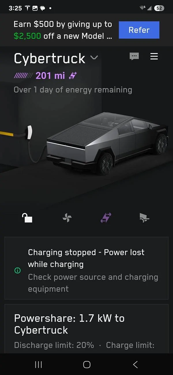

I don't have a Tesla solar array. I have an old enphase system. I think that is why it doesn't say anything about solar. But it does show at the bottom of the previous picture that the truck is being powered while in PowerShare mode.

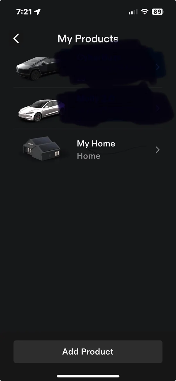

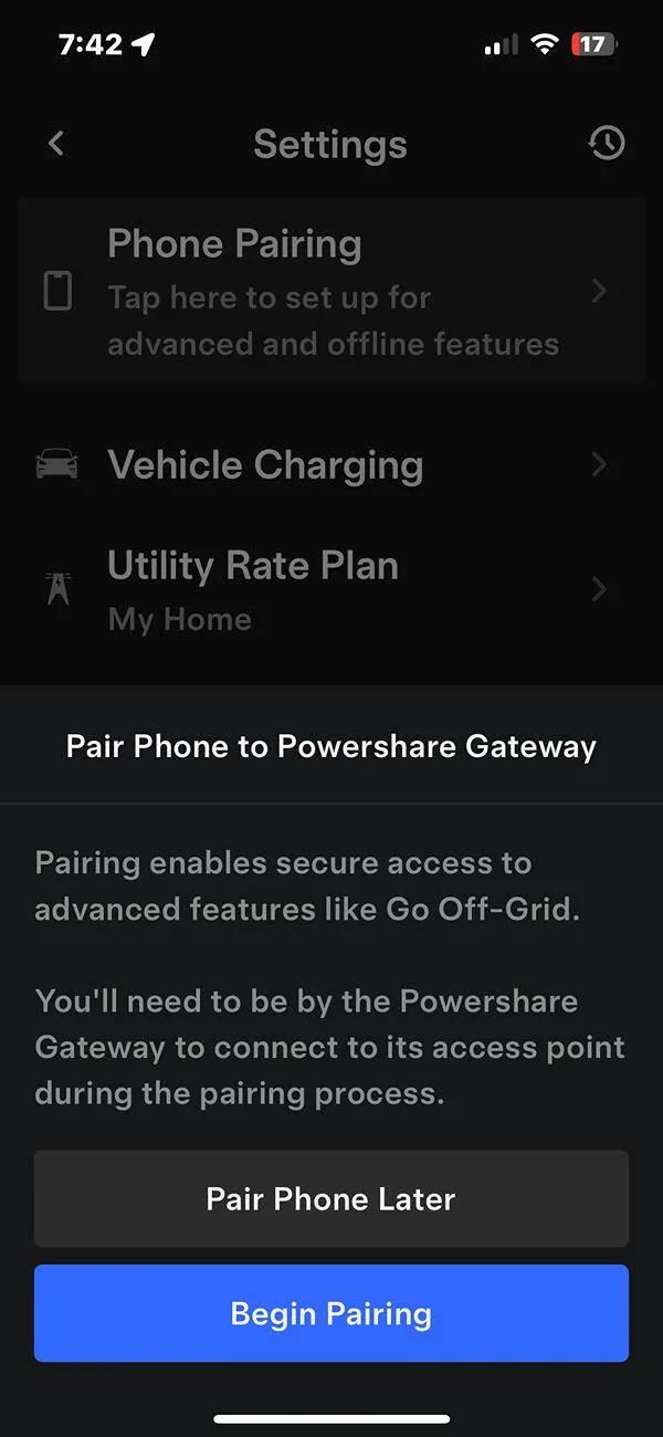

Also - do show anything else besides “Home”, like the attached (ie it actually says “PowerShare” beside under the “Controls” setting?

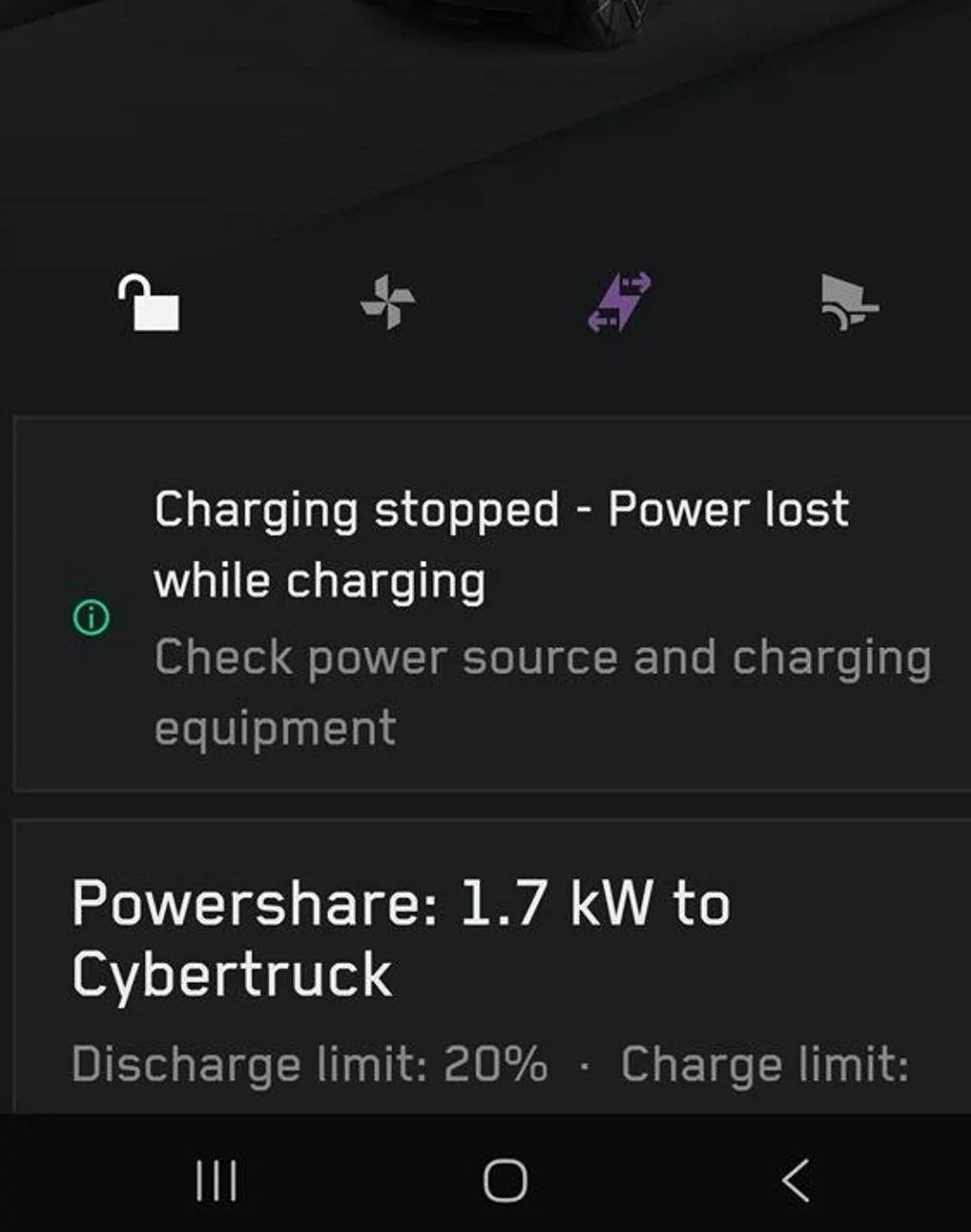

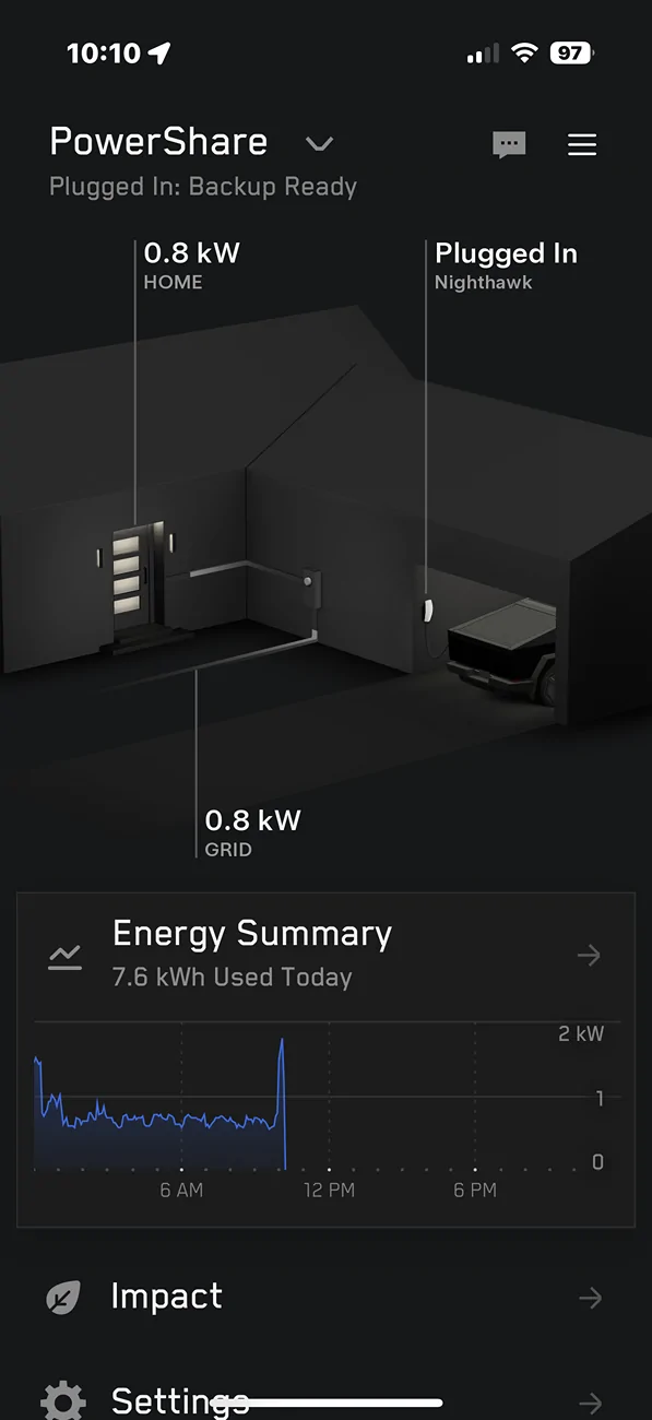

You should have a view like this, you can also swipe left on your cybertruck to get to this screen. When the electric company was setting up my PowerShare this screen was showing I had power going to the grid, but could never get it to activate because of that, they had to move the solar connection out of the PowerShare box, and back into the main box, where it shutdown the inverters when the power goes out. They left the breaker and wires running to it so it’ll be really easy for me to change it back once the update comes out to update allow solar. That’s why I’m curious to see that screen. Also that screen under setting > My home info. It’ll have the firmware version your on.

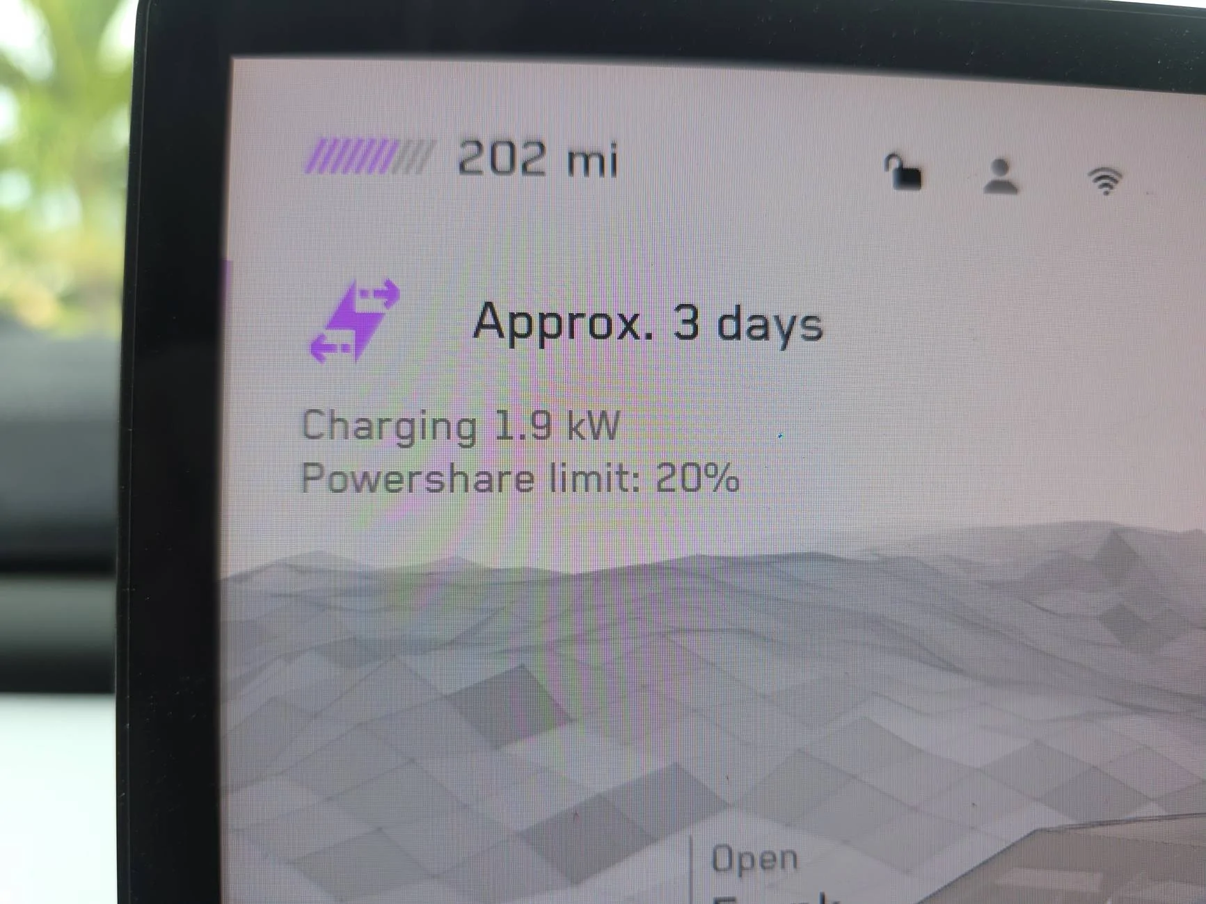

It doesn't really acknowledge the solar yet it just shows that the truck is being charged.
Does your PowerShare box(Gateway) have any breakers under the breaker for the universal wall charger, i.e. for the solar panels?
