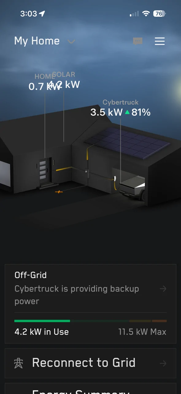

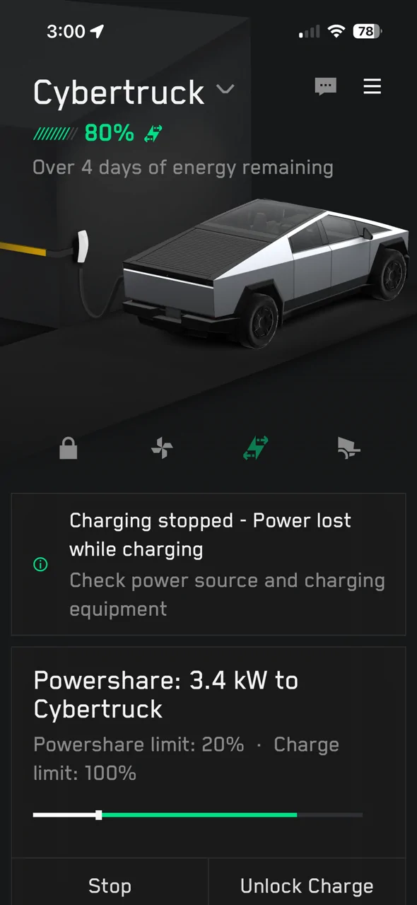

Mine is all working now. So cool! The app isn't perfect - the home/solar numbers overlap and the "Charging stopped" alert doesn't go away when charging from solar, but the system is up!

Great to hear so you have a non- Tesla solar and a Tesla gateway. Could you explain how things are connected at the gateway and if there are any additional monitoring devices installed on your non-tesla inverter?
There's a 60A breaker in the gateway and the solar is wired to that. The solar is SolarEdge, and it has its own app via wifi, so the only monitoring gizmos are Tesla.

Cool. Have you tested going off-grid and does the solar keep producing while in island mode? Thanks that I'm hoping to accomplish I have a similar setup.
