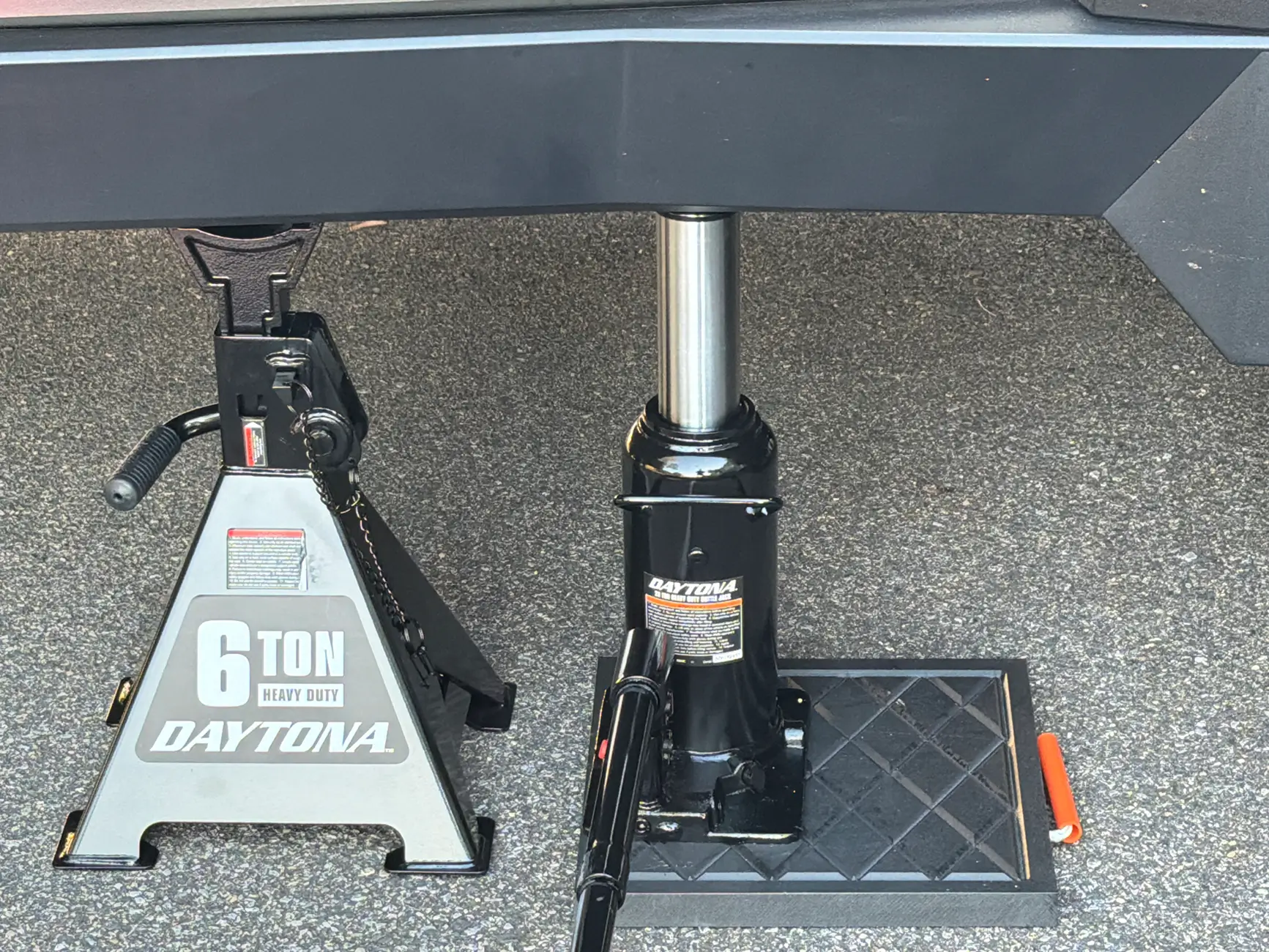

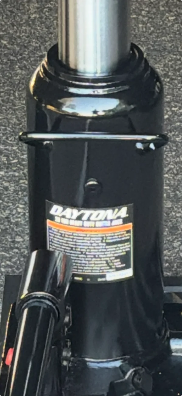

What kind of jack jack stands and jack pads did you get?

Steps for jacking are important
Raise rhe truck for the jack and pad to fit
Then jack mode to lock the suspension, prevents it from lowering
kpanda17
Jun 8, 2023
988
1,002
Memorize the jacking spots underneath
Practice before you need to do it for real

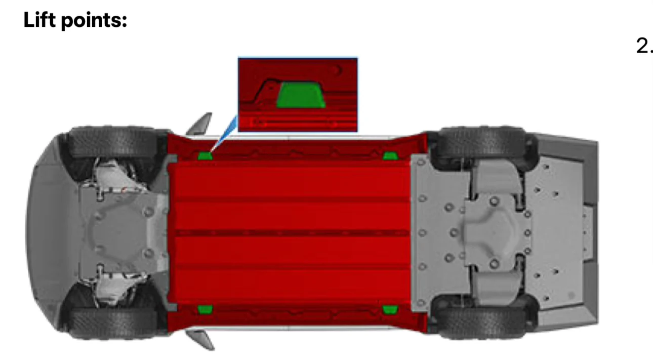

Jack lift points

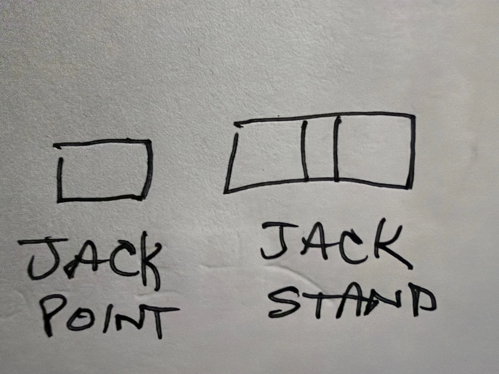

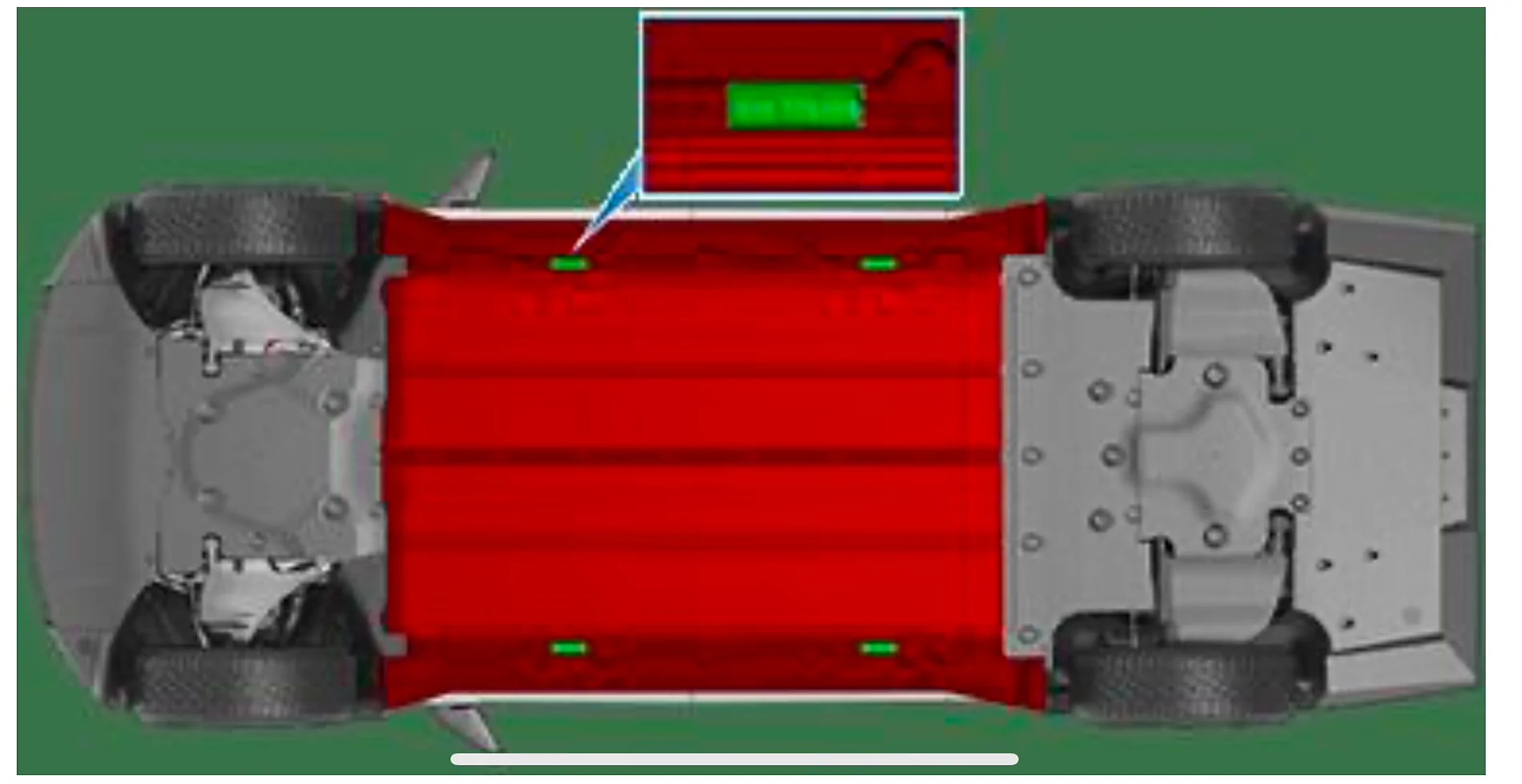

Jack stand points
Steps
Under frame
Tesla Cybertruck Spare Tire setup for first roadtrip 1779939783731-l2
Tesla Cybertruck Spare Tire setup for first roadtrip 1779939783771-p5
Tesla Cybertruck Spare Tire setup for first roadtrip 1779939783837-gy

Paste screwed the order, you’ll figure it out
