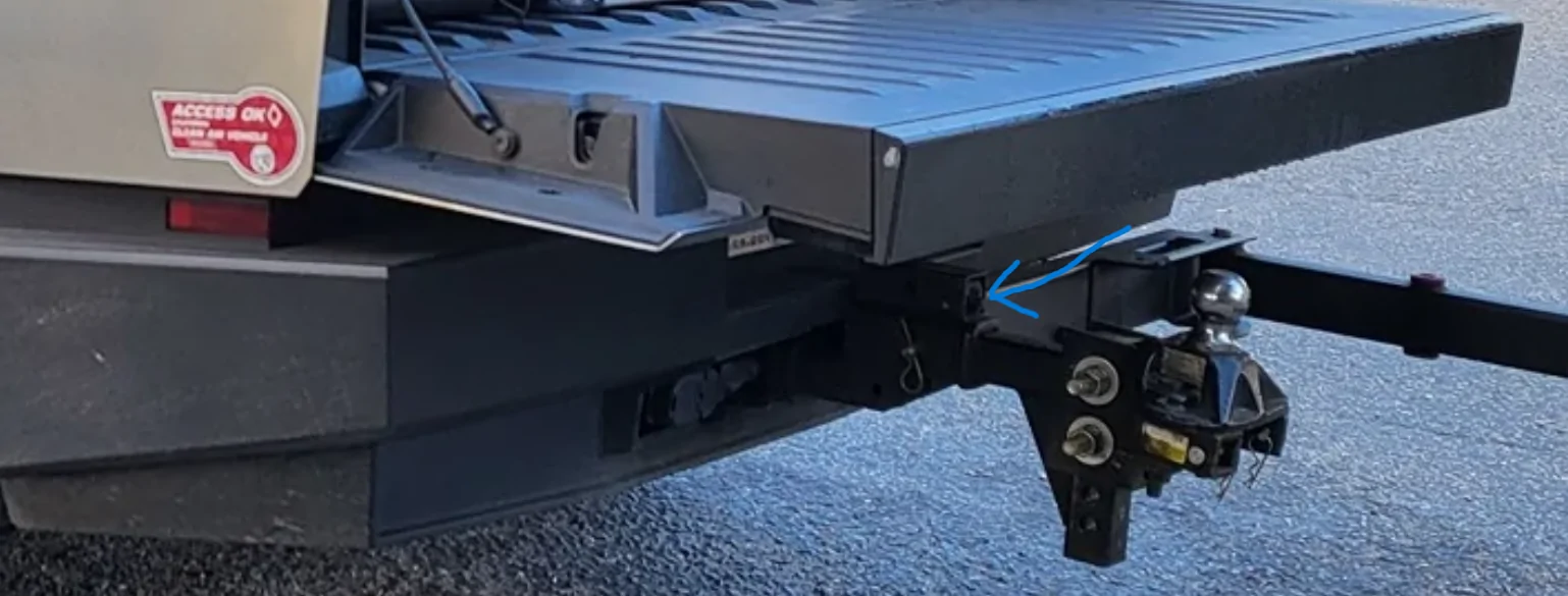

do you know how he did it ? Extension cable, recalibration etc?
I moved my camera when I installed the Wilco Offroad spare tire carrier back in March 2024 by just disconnecting camera and rerouted the wiring harness which is long enough to reach the tow hitch and made a permanent mount on receiver which works with no calibration, issues, faults of any king and FSD works great still. Theres a post about it all somewhere here but it was easy to do.

That’s really nice. Can you show some more detail of the camera relocation please?

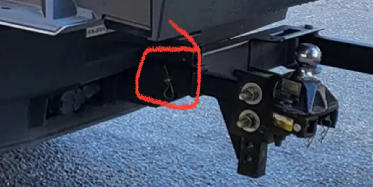

I moved my camera when I mounted the Wilco Offroad version of tire carrier with bike rack mount back in March 2024 to the top of the receiver using a 2x4 inch square stock steel tubing and put camera inside that to protect from basically anything. No need to add wire, just re routed the wire harness to the new location.
🙏(high five)
you'll see the 2 inch steel square stock I put the camera in on top of receiver if you zoom in. It was easy
