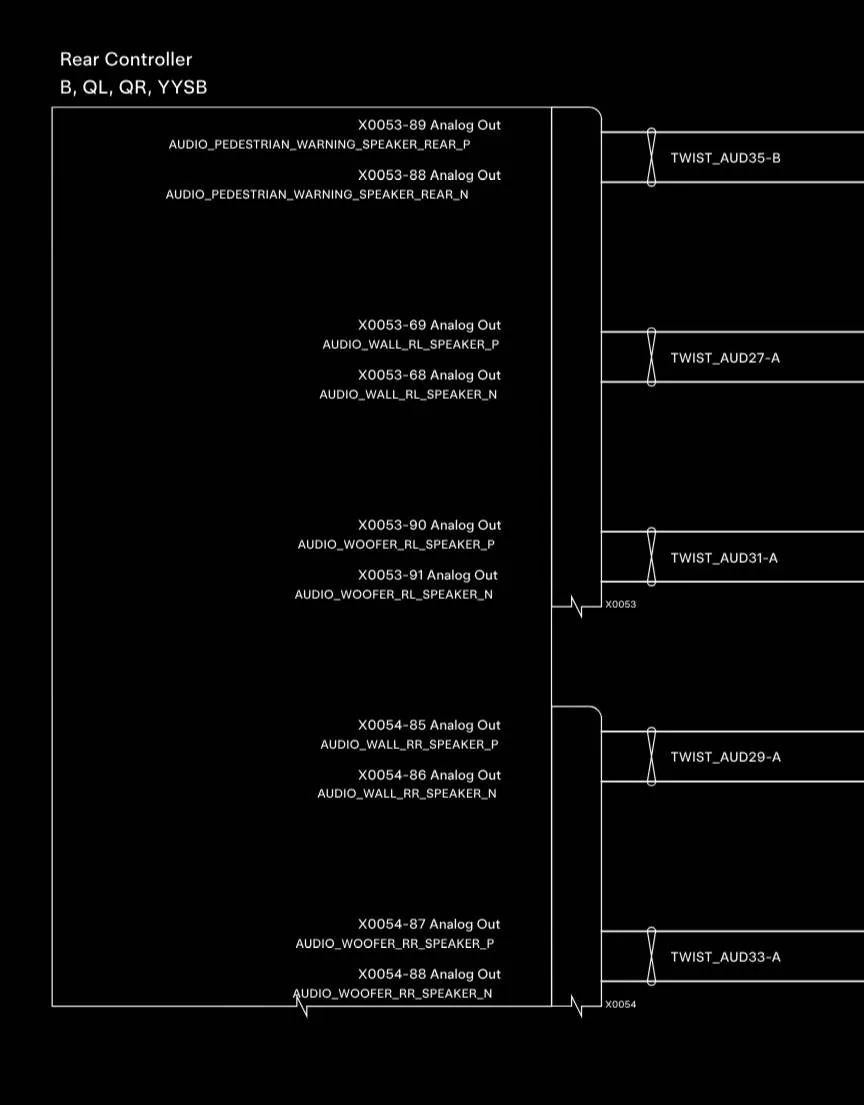

It's distributed into the body modules, not the speakers themselves.
Amps are in the left, right, and rear backbone controller nodes with no analog wiring other than the amplified feeds to the speakers.
The crossovers are digital.
Very helpful to know, thanks! I don’t suppose you have any knowledge about how the audio signal is encoded and accessed digitally by the factory amplifier? I believe I’ve seen projects on other cars where the audio signal is accessed via CAN bus with a raspberry pi and a CAN bus interface module. I think Tesla uses some higher bandwidth protocol, but that’s about as far as my knowledge goes on it.

It’s done over a “A2B” bus. Requires a hardware decoder and hardware to split up the channels to RCA outputs.. Not something a pi/arduino can do on its own.
And that's after the packets make it through the Etherloop

Yeah I’ll leave that job for someone else lol.
I’m happy with the speaker level outputs from the factory amps.. Still kinda sad because I will have to run wire to each speaker since the factory wire is too small for some speakers.
