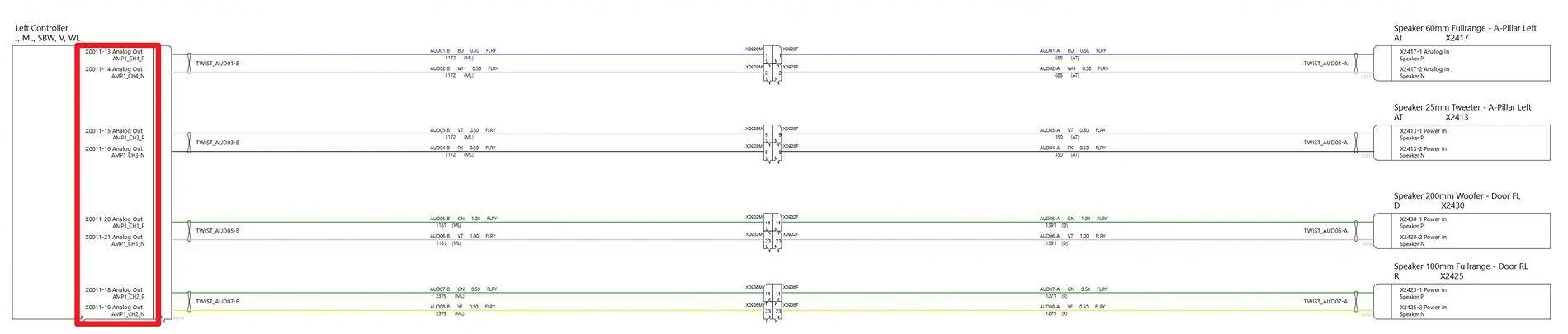

In the diagram, the signal output from the Left Controller is already an "Analog Out", which is directly used to drive speakers. So I infer that they have integrated the amplifier chip into the network micro, bypassing the use of conventional audio bus.

The controller PCB has both the network interface and audio amplifiers on it, but that doesn't mean the DAC is built into the micro. That might require an ASIC or multidie package which would likely still have a bus type link from the two domains.
I'm not advocating for any specific bus, was initially calling out that any audio goes via Etherloop (even if only as a wrapper around another protocol).

Yeah, I agree with you. As far as I know, this kind of bus is usually TDM or I2S.

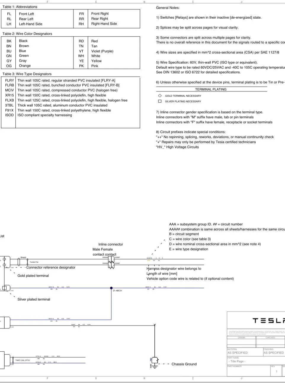

It's on the first page of the schematic
So much good info in this thread. Thanks for posting!

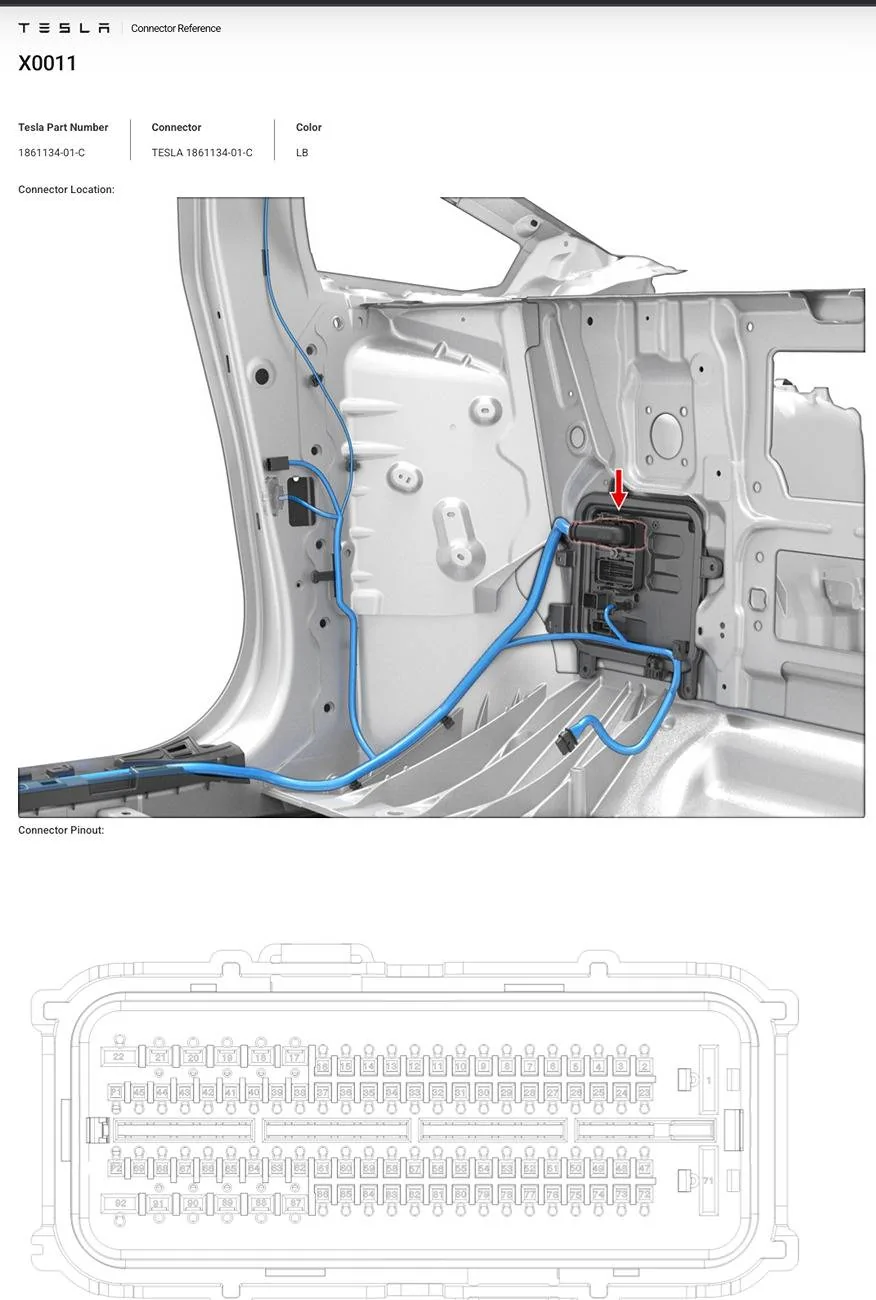

Are there any vehicle photos that identify the distribution modules that would need to be tapped for the sub and midbass? The subwoofers can be tapped right at the connectors to the enclosure, but I'd rather tap coming out of the distribution module if possible, and I'd certainly rather tap the midbass at the source and not in the door to avoid running wires back and forth...

Pages 4 and 5 of the schematic have the other speakers which are fed by left, right, and rear control modules. Take the connector number and look it up here for position:
https://service.tesla.com/docs/Cybertruck/ElectricalReference/prog-242/connector/x0011/
