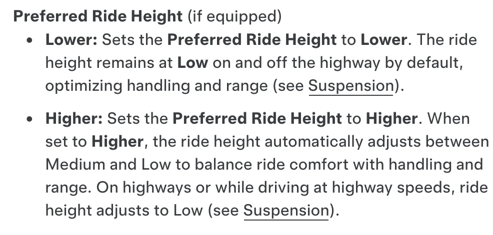

It only switches height based on speed or if you previously changed height and created a location based height change trigger.
25 MPH is the trigger point. Lower suspension mode would avoid height changes, but may result in clearance issues.
If you are in "higher" it should switch between low and medium.
Tesla Cybertruck Suspension overheat warning AISelect_20250922_064946_Firefox
You could switch to off road mode which allows you to stay in high.
https://www.tesla.com/ownersmanual/cybertruck/en_us/GUID-9C572163-DB86-44AC-9842-AB6EE84D6441.html
