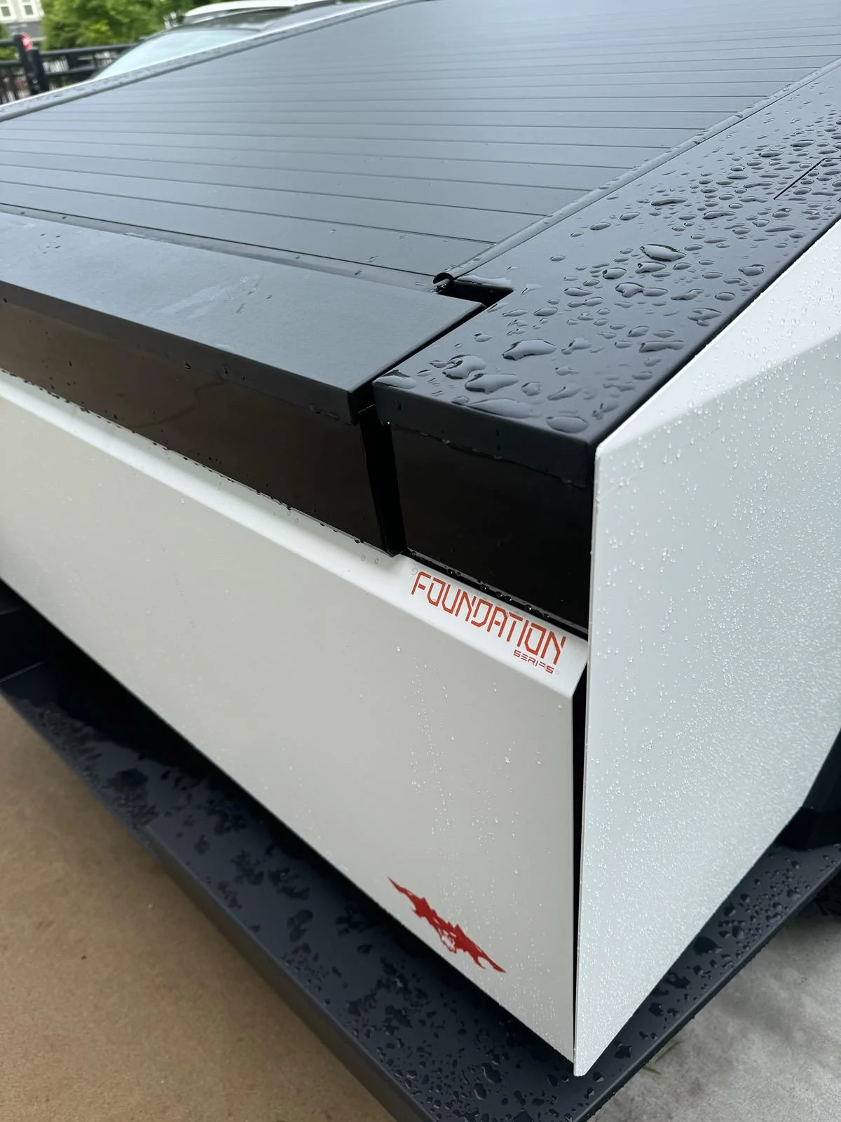

It latches but won't pull itself flush anymore. Any thoughts?
Tesla Cybertruck Tailgate latches but not pulling flush anymore IMG_1222

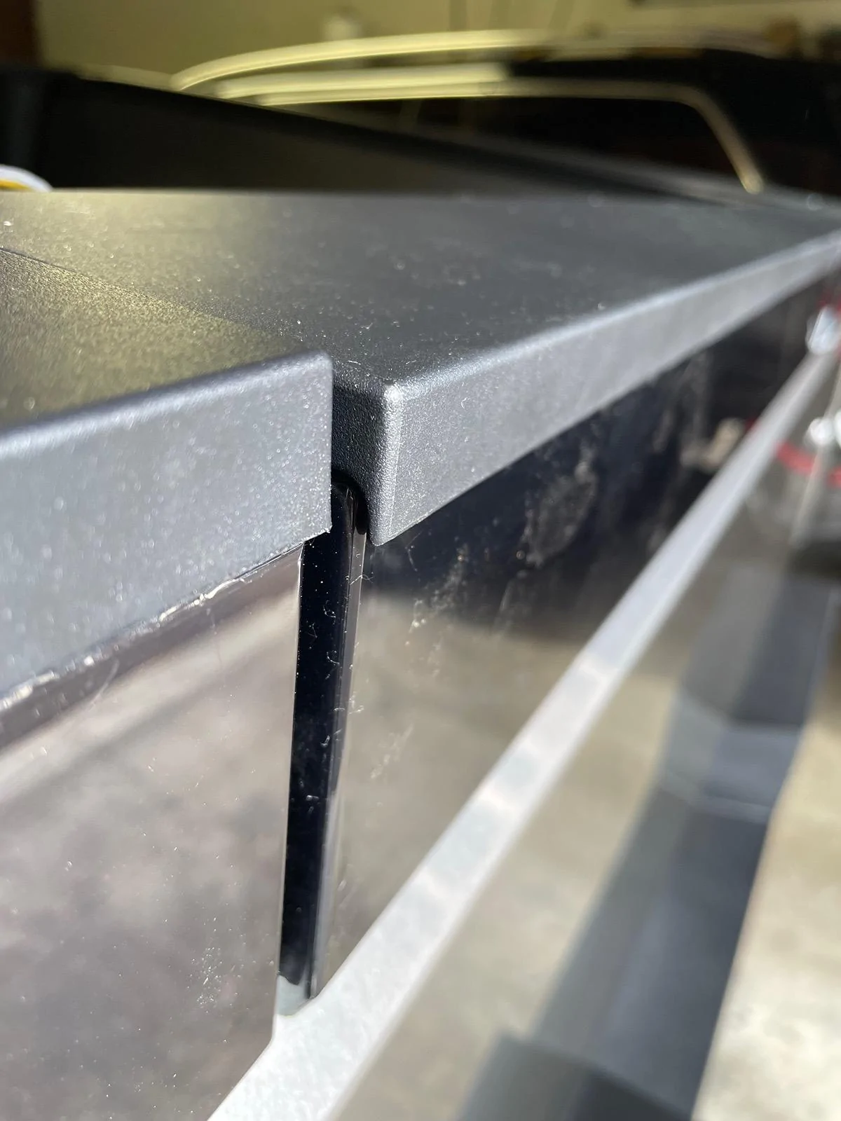

Mine not even totally flush to start with. Opened the service request but not sure it is "in spec" or not. I am not too much concern about this
Tesla Cybertruck Tailgate latches but not pulling flush anymore IMG_6266

It's supposed to pull itself closed. If a reset doesn't help, it's probably the motor or a sensor, so you'll need service.
Reset as in hold the two buttons down or something in service mode?
10,236
33,888
Power-cycle.
https://service.tesla.com/docs/Publ...UID-76C3CAB5-8F3F-4F0A-93F4-966DB3E67FEA.html
Basically:
  1. Shift into Park.
  2. On the touchscreen, touch Controls > Safety > Power Off.
  3. Wait for at least two minutes without interacting with the vehicle. Do not open the doors, touch the brake pedal, touch the touchscreen, etc.
  4. After two minutes, press the brake pedal or open the door to wake the vehicle.
Mine is not flush either and I try to ignore it and pretend it is ok but I cannot. I was hoping it was something I could adjust on my own, but I will see if service can address it. Anyone here have any ideas?

same with mine but only on the left side so the cover does not touch the tailgate and it leaks (and lets dust in) on this side.

Yeah they fixed mine a week or so after that. Now my sail trim is falling off, have an appointment for that next week. Still no PowerShare gear or light bar so I filed arbitration.
