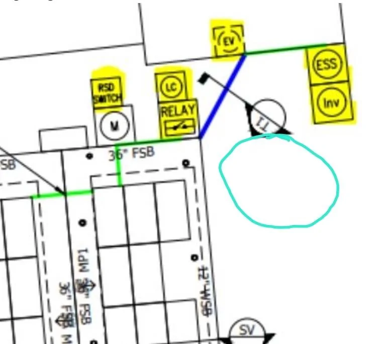

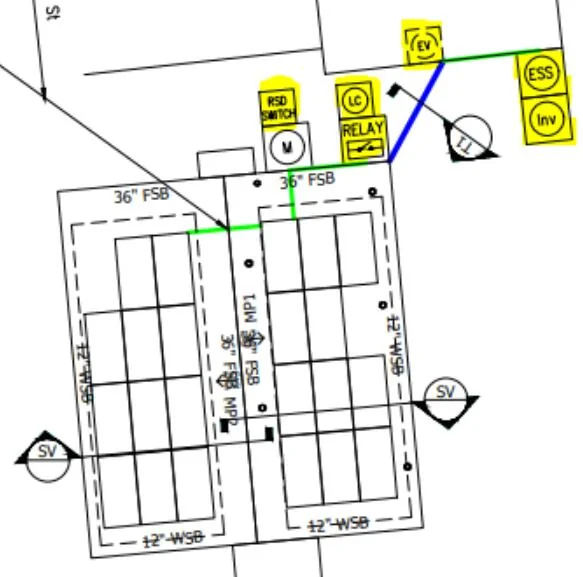

This is all outside. They want to leave the existing Load center as is, Install a new one on the other side of the door (I guess they will move all the circuits into it) with a gateway and run a bunch of conduit, then install another load center on the outside of the garage even though there is one mounted in the wall of the grange.
The backup switch seems like it would help but they are not using it. PG&E is my utility so I'm not sure what requirement I'm missing.
Tesla Backup Switch
This is their current plan. Not sure why they want the Powerwall on the garage and trench wire to it.

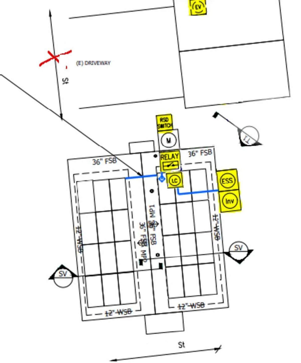

But I want something more like this.

I asked them again but they refuse to answer the questions I have as to why.
"Please be aware that we plan on using a gateway instead of opting for backup switch. I hope this information is helpful."
But the backup switch should make the install easier and not require the extra load center and gateway. Why spend more money and add more unneeded boxes. Documents for the backup switch had already been included in the project?

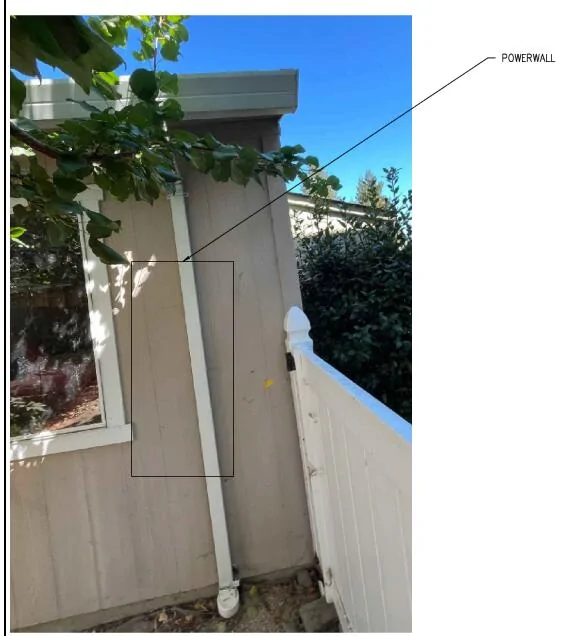

New electric code has more restrictions on how close Powerwall can be to doors and windows, thus mounting it to the garage.
Tanquen
Dec 9, 2023
38
396
235
I thought that was if it is living space. If it's a utility room that should not be an issue?
Also, there is a down spout and gate where they show it on the garage. They just told me I'd need to move it. To where? They just waste tons of time by not running anything by the customer.

Ok, that is an interesting situation. I'm guessing the window requirement supercedes the idea that the window is known a utility room. I also question is a utility room which is specified as having 5/8 fire drywall installed on walls and ceiling can have windows. Basically, the window is not as fireproof as the walls should be.
https://www.nfpa.org/news-blogs-and...residential-energy-storage-system-regulations
https://isaksensolar.com/understanding-nfpa-855/
Powerwall is going to stop that gate from swinging... Are there windows all the way down it?
Yes, the gate would hit it when you open it. Also, I don't have another location for the downspout, it is there for a reason.

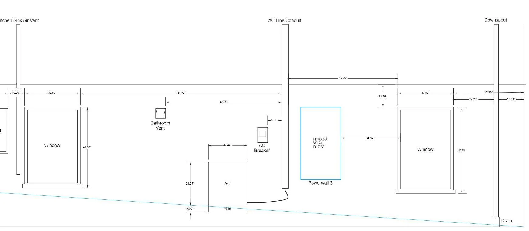

Anything going on in this area? It could get mounted 3 feet away from the house on its own (or along the fence? )
Possibly mounting at a right angle would allow the needed window separation.

That is a small side yard and I'd not want it there and there is currently a tree in that spot.
"Note that if the locations are fire-separated from the dwelling part of the home then a window into that location does not 'directly' enter the dwelling."
https://forums.mikeholt.com/threads/battery-to-garage-window-distance.2581121/post-2921159
There is no opening from the inside the utility room to the rest of the house. I'd maybe, be more interested in giving up the window if needed. But as it there is room to place the battery 3' from the windows. I'm guessing that is edge to edge?
Doesn't the utility room have a normal door to the rest of the house and non-fire rated drywall though? Or is it only accessible from outside?
3' edge to edge seems correct.

That could be an option but it seems like there's enough room as is. I don't know why they can't just put it on the side of the house.

They might just exclude the house because windows are usually too close. Your proposed location seems fine.
