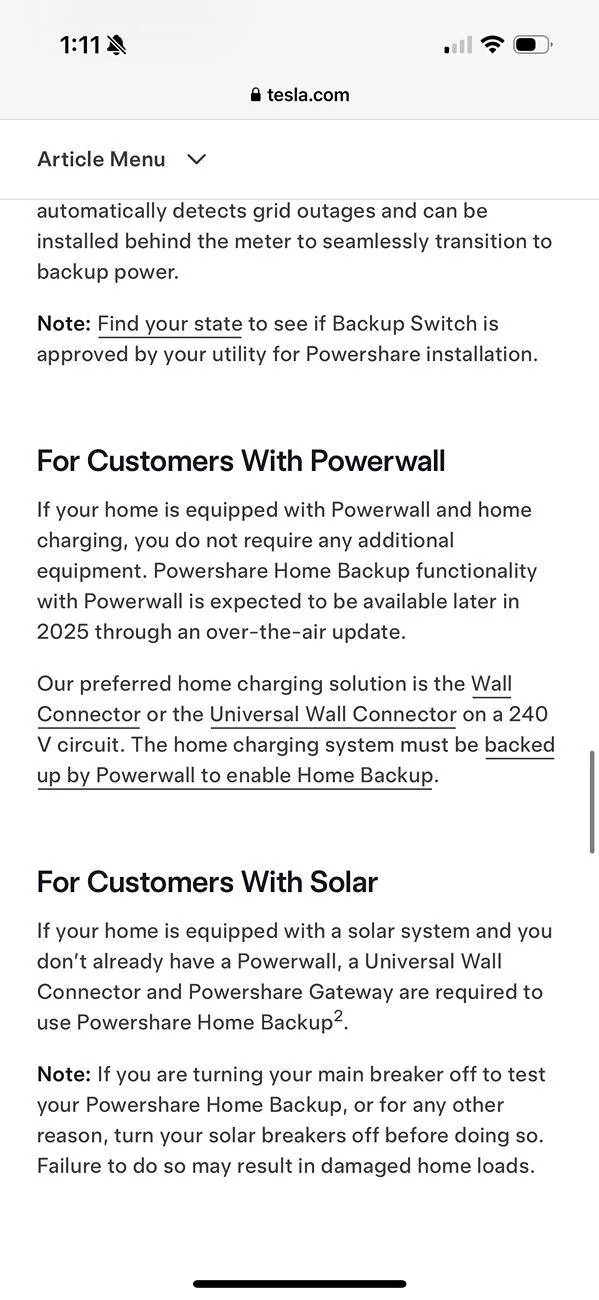

I’m not sure why people are saying you need a backup switch if you have a Powerwall 3.
Based on Tesla’s documentation, it clearly says all you need is Wall Connector or UWC + Powerwall.
Tesla Cybertruck Powershare update: Home Backup enabled for Solar + Backup Switch IMG_5063
Also, this was the most recent post from @Cybertruck on X
So, the way it’s worded, I don’t see any need for a backup switch if you have Powerwall + WC gen 3 or UWC.
The Powerwall 3 itself requires a Gateway or Backup Switch. It's inherent in the installation.
So, when adding Powershare to Powerwall, the only extra piece needed is the WC.
