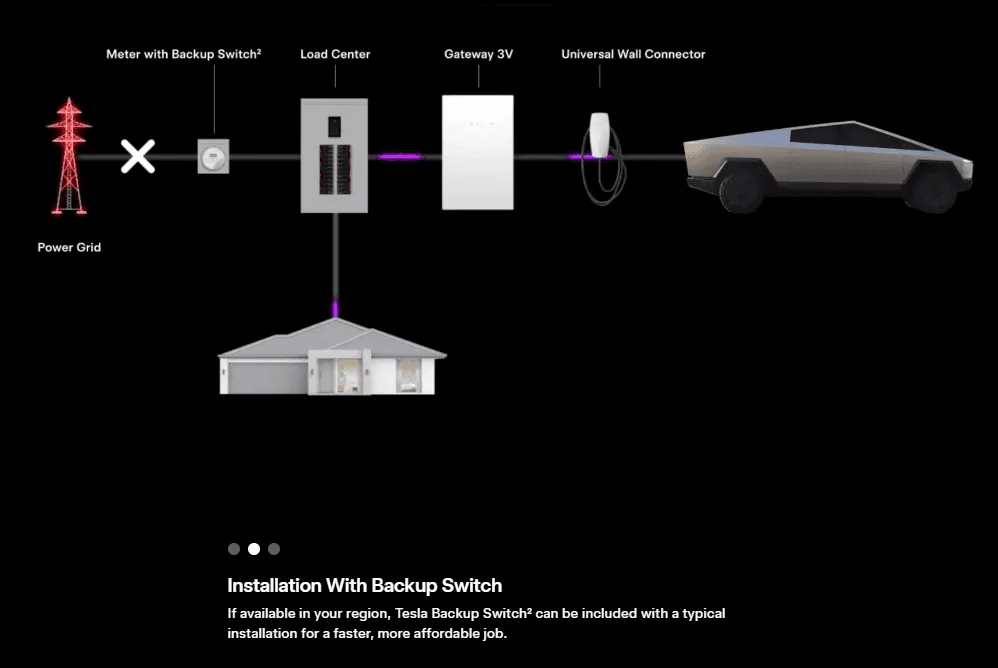

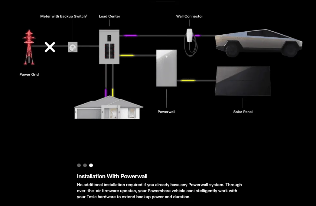

Thanks, I hadn't seen that before. My concern is that I do not have a Powerwall. I do have the Tesla PV inverters though. My setup would look like the bottom image with the solar going to the Tesla inverters and then to the panel.
It seems like my config should be supported, but it is concerning when it isn't directly depicted. It should be a dead simple install with only the backup switch (pending SCE approval) and Wall Connector needing to be installed.

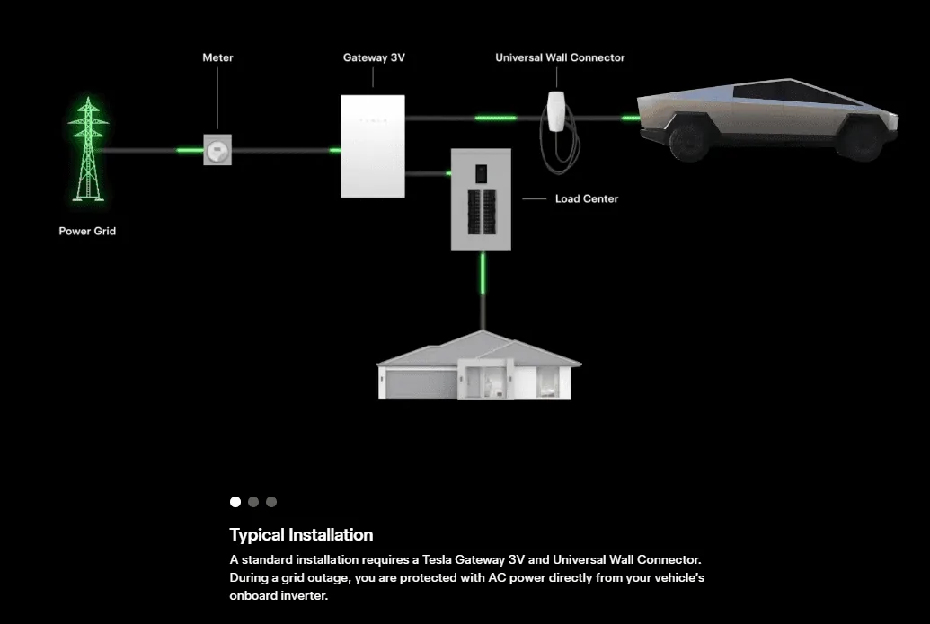

If that's the case, it would probably look like the second image except with solar connected. During the day the solar would offset loads and Powershare would pick up any sack to include through the night. If it can't accept charge while in Powershare mode....that would be a bummer, but might be on purpose to prevent people from trying to go off grid for weeks-months.
With this setup, the truck would only provide power above and beyond what solar is producing. Not terrible and I could make that last for several weeks as my consumption between sunset and sunrise is <10kWh/day.

There is no second image with solar. Solar only appears in the Powerwall diagram. This is NOT an accidental overlook.
