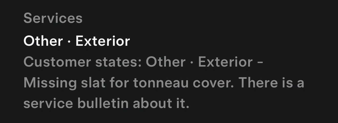

missing tonneau slat added on my May '24 AWD.
I have a March '24 built truck (delivered in April due to the pedal rivet delays) and I need the missing slat as well - did you submit the request under 'other'?

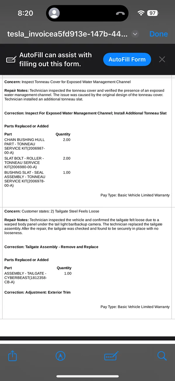

Necessary part numbers in case you need them:

Thanks. If the invoice has the part number I'll create another service request...and wait six weeks for the next appointment.

I had a service appointment last week, status of items:
- cant rail - parts not available (despite appointment scheduled a month earlier), being released in batches by VIN. No ETA despite what the recall letter said.
- extra slat in tonneau - added and fixed! no water ingress during our last downpour in NJ. Previously it leaked quite badly at the top of the roof.

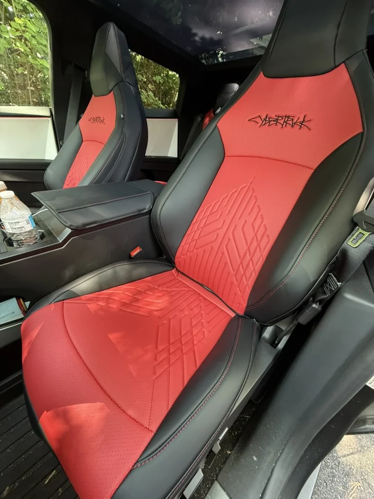

So does this make it easier or harder for people to talk themselves into seat covers?
as in “this feature is already meaningless, I may as well” or “man, this barely works so maybe I shouldn’t throw another 1/4 inch of stuff on top of it.”.
Easier decision for me. I was getting tired of the all black interior after a year. Not much difference in cooled seat performance at all but at least the seats are more comfortable and, arguably, have more visual flair. Could do without the stitched Cybertruck graffiti font, but I don't hate it.
Those look good. I actually don’t mind the graffiti logo. It looks good on there.
When you get in the car do you immediately obviously know they are seat covers?
they look fairly seatlike.
I'll give you two honest answers:
- seat covers, to me, are always obviously seat covers
- these seat covers are nicely designed -deviated stitching on seams, seatback pocket, blow-through areas for the side airbags and tuck-in points to hide all the edges and make sure they look as OEM as seat covers can look
I still have them on my truck two months later, so that should tell you something.
Here is a quick video which will give you more perspective on installation, seams, edges, fit and finish, etc. 19 mins but you can run it at 1.5x and slow down where you want.
