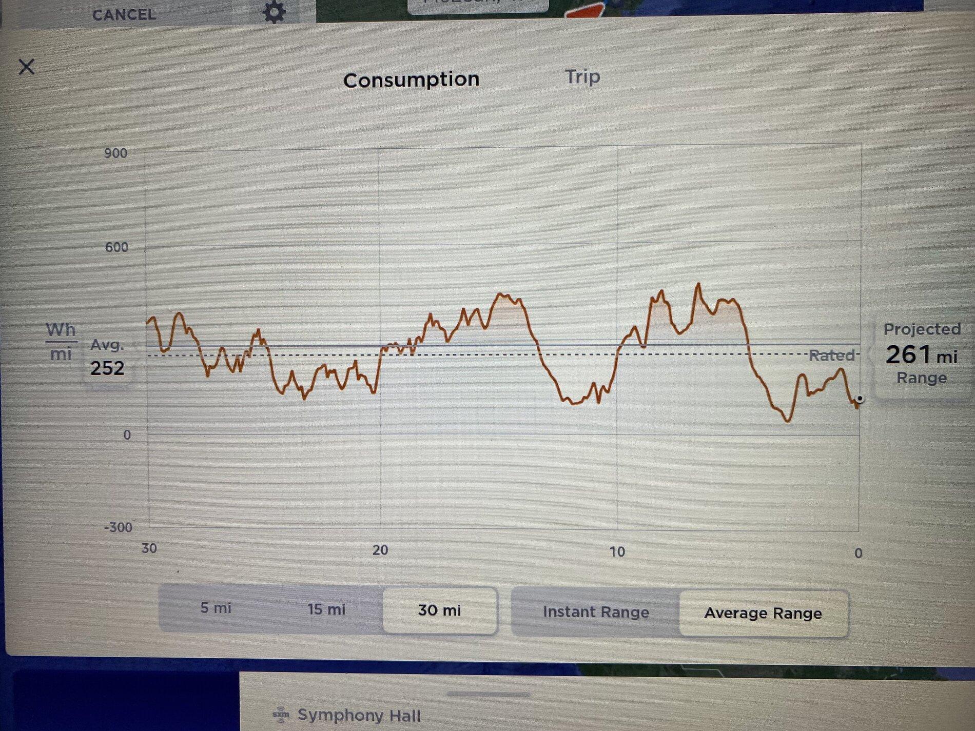

You have grabbed on to the wrong conclusion. What you should have taken from that video is that consumption is determined by a lot of factors the most important of which is the details of the individual drives over which it is measured. e.g.
wow, lifetime avg on my m3p is 316 wh/mi....so diff traffic, weather and driving styles do make a big diff
I do get 260 on my X in Virginia in the winter but up in Quebec during the summer it is more like 285 (in direct conflict with the assurances that I have been given that I'll lose 20- 30% of my range in cold weather). It definitely depends on how, where and when you drive but, of course, it also depends on the vehicle parameters. The six loads are drive train, inertial, gravitational, rolling resistance, slip and drag. To calculate their absolute and relative magnitudes (and signs) you must know the vehicle mass, slip coefficient, rolling resistance coefficient, drag coefficient, temperature, effective frontal area (not the actual frontal area), airspeed, velocity and first derivative of velocity and grade. Thus in order to calculate the energy used in a trip you must have the vehicle speed history, The speed history is obviously complex influenced by such things as slowing down for traffic and stop lights, accelerating to pass and so on and it tends to be, except when on auto pilot, complex. The picture below shows recorded Wh/mi for the most recent 30 miles I've driven.
Tesla Cybertruck Tesla Cybertruck is Really Efficient! [Nxt Garage Analysis] IMG_1418
The total energy used in those 30 miles is represented by the shaded area under the curve. That energy, divided by 30 miles, is the average consumption (252 Wh/mi). The high frequency oscillations are from speed adjustment. The slower trends relate to terrain. The graph represents a 10 mile trip to a destination and return over the same route some of which was on freeway. The trip involves going up a hill (higher than average consumption) followed by going down the hill (lower consumption - regen was on).
The point is that the actual Wh/mi used would be virtually impossible to calculate even if I had a terrain profile because of inability to predict traffic conditions, wind, wet pavement etc. And so the best we can do is speak in terms of averages. On the graph the heavy horizontal line labeled "Rated" represents the average consumption Tesla measured during a prescribed (EPA) test. Although I cannot find the numerical value attached to that line documented anywhere it's value can be determined from the graph as 272 Wh/mi. Multiplying by the 351 mi rated range of this vehicle we find that the available discharge battery energy for this version of the X to be .272*351 = 95.47 kWh.
If we go to ABRP and select Model X LRP we find that ABRP thinks this vehicle's consumption is 332 Wh/mi at 65 mph. That is, in our experience, a bit high. In any case the rated consumption (determined at lower speed) is 81.9% of that. Now assuming that ABRP is reasonably skilled at doing what they do we look at their 65 mph prediction of 485 Wh/mi for the TriMotor CT and apply that same 81,9% factor to it to get an estimate of 397 Wh/mi for the rated consumption of the TriMotor. Since the CT is obviously going to be a bigger vehicle and as the drag goes up as the square of linear dimension and as the drag is the largest load given regen we feel comfortable in the gut with that number. But since gut feel is not very certain we think we should probably attach at least 10% uncertainty to that and think about 397 ± 40 Wh/mi. This leads us straightaway to battery size estimates of 500 times this or 198.5 ± 20 kWh. So 180 to 220 kWh for the TriMotor. This estimate is based on nothing more than how an exisitng X performs and a WAG as to how the CT might differ. If I do elaborate calculations of the 6 loads based on Monte Carlo trip models I come up with about the same numbers. Take it or leave it.
