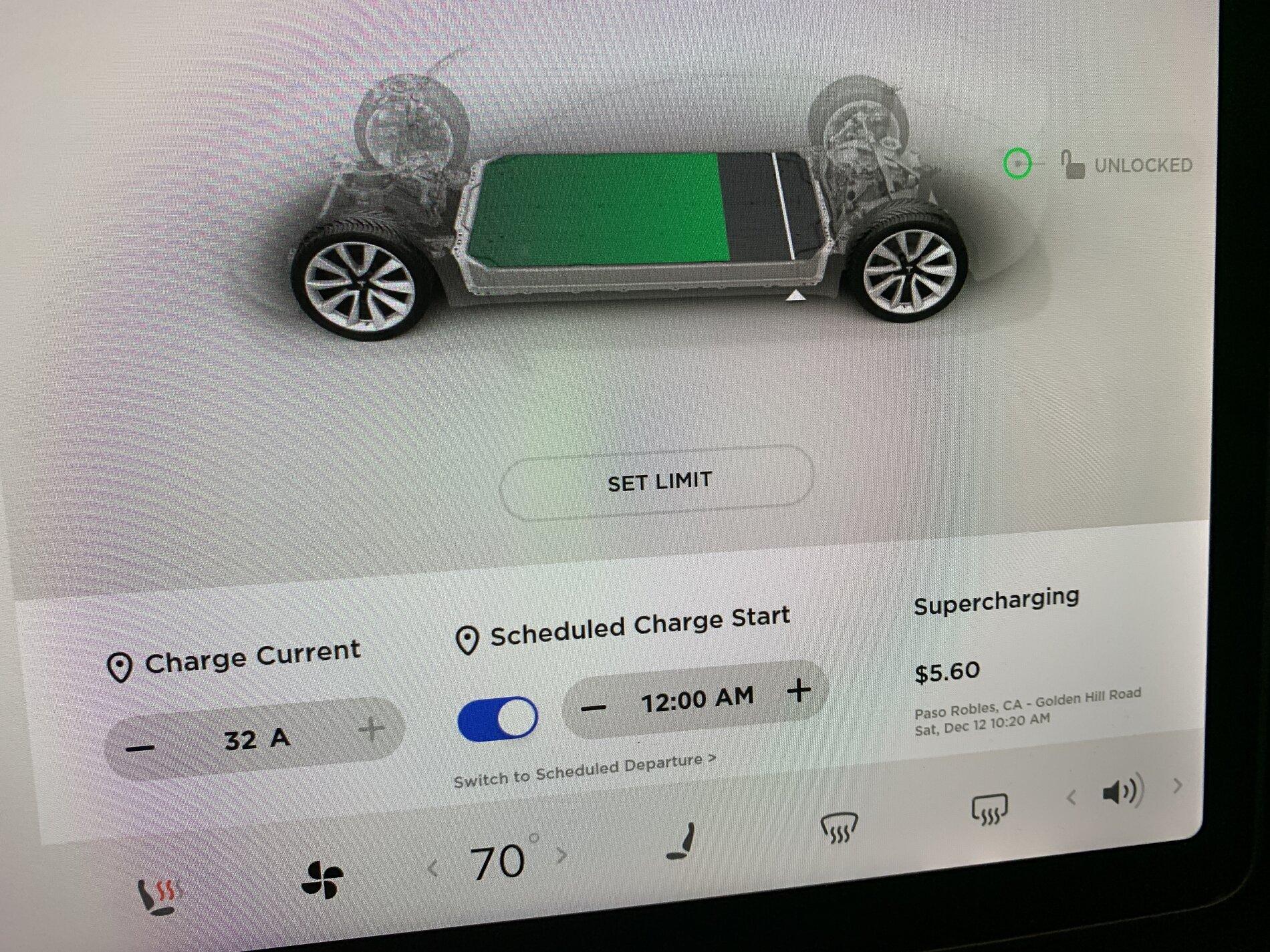

Sometimes our rates are as low as 5 cents per KWh. I wonder if there is a way to determine those times and only charge preferentially? I don't drive a lot so it would be feasible if possible on a fairly automated basis.
Of course.... it is a setting on the charging screen when you open the charge port. Your cheap rates should be on a fixed schedule published by the utility. Our "off peak" starts at midnight, so we have have the cars set to start at that time. You can also tell it your "leave by" time, and it will figure out when to start so your car is ready by then, but I don't find that very useful.Sometimes our rates are as low as 5 cents per KWh. I wonder if there is a way to determine those times and only charge preferentially? I don't drive a lot so it would be feasible if possible on a fairly automated basis.
