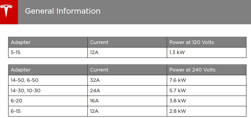

The Tesla Wall Connector Gen 3 or the Universal Wall Connector both should be designed to survive installation at houses/buildings/destinations that lose power frequently so my suggestion for RV at campground should be similar. I think the wall connector are more efficient electrically and can more fully utilize 240V 50A circuit .
https://www.tesla.com/sites/default...ng/Gen3_WallConnector_Installation_Manual.pdf
circuit 240V 50A, output 240V 40A 9.6kW
Tesla Universal Wall Connector - 11.5 kW / 48 amp output (On 50A circuit probably have to to de-rate to 40-45A 9.6kW).
https://shop.tesla.com/product/universal-wall-connector
Tesla Mobile Connector Gen 2 ( max 7.6 kW)
https://www.tesla.com/sites/default...bile_connector_owners_manual_32_amp_en_US.pdf

No and yes. EVSEs aren't really more or less efficient; they're just extension cords/receptacles. But yes, it can more fully utilize a higher amperage circuit.
However, the Wall Connector is designed to have the amperage set when it's installed, while the Mobile Connector is designed to know what it's being plugged into, and if I recall, you can fiddle with how much it's drawing in the car's UI.
