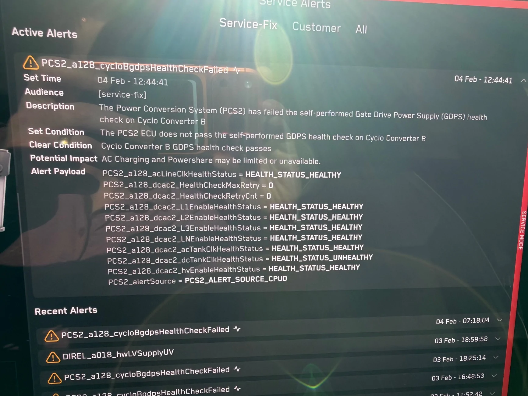

All,
I noticed recently that my truck only charges at 24A on my AC home charger. I went into service mode and found this PCS code. I have seen similar people post similar codes on this forum but not this one. I scheduled a service appointment but it's not for 3 weeks. Does this mean that I most likely need a new PCS? Thankfully I only have 44k miles on it so it's under warranty. Any advice is appreciated!

Possibly. Pcs is a complex electronic with many fail safes, redundancy and critical vehicle interactions. Hard to know if its a replacement fix without tesla techs looking into it but if you are having charging issues it will likely require replacement.

This is almost certainly a failing PCS. If it was me, I'd supercharge only until you can get in for service. Schedule it now as it's a part that has availability challenges from time to time.

FWIW -- When mine failed the symptom that I first noticed was 48A charging dropping down to 24A. The error message more or less tells you the problem, one of the two onboard Cycloconverters as failed.
