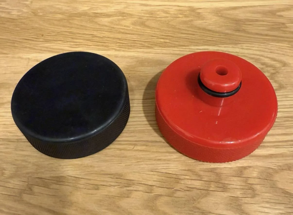

I am yet to rotate the tires on the truck. I have two 4 Ton hydraulics jacks. Rotating tires on the Y is a breeze.
I am gathering there are 3 key differences:
1. Using hockey pucks vs Tesla specific lift pucks.
2. Placing the truck into “jack” mode
3. An extra lug nut, per wheel.
The cybertruck does not require pucks.
