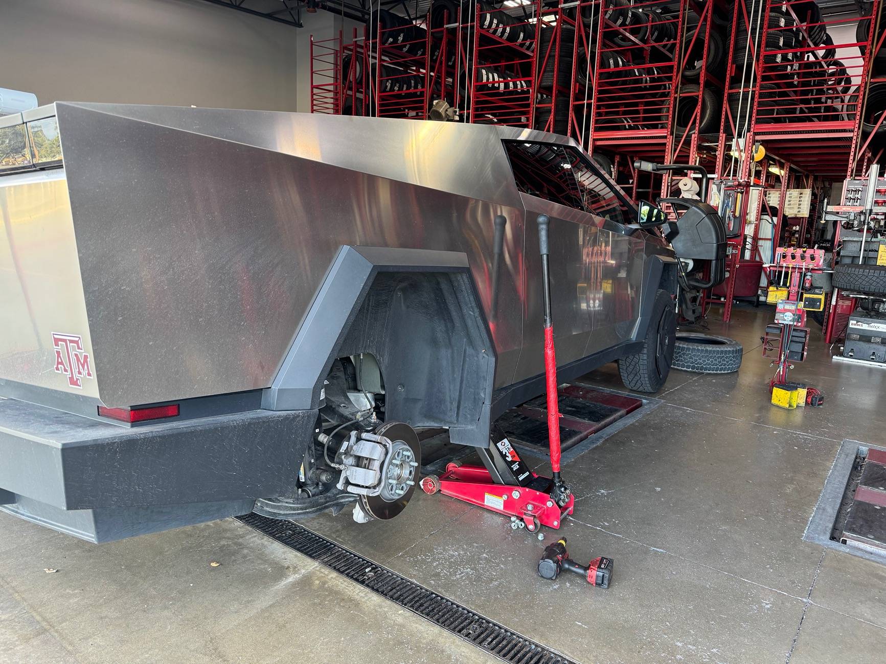

I took my CyberTruck to Discount Tire for a slow tire leak. They found a metal rod near the sidewall and ordered a new tire. I had purchased road hazard for the tires and got the tire replaced for free. They've had no problems with puncture repairs on my CyberTruck. They also swapped the OEM tires to new wheels, with no problem. They always have a few Teslas out front waiting for tire repairs.
