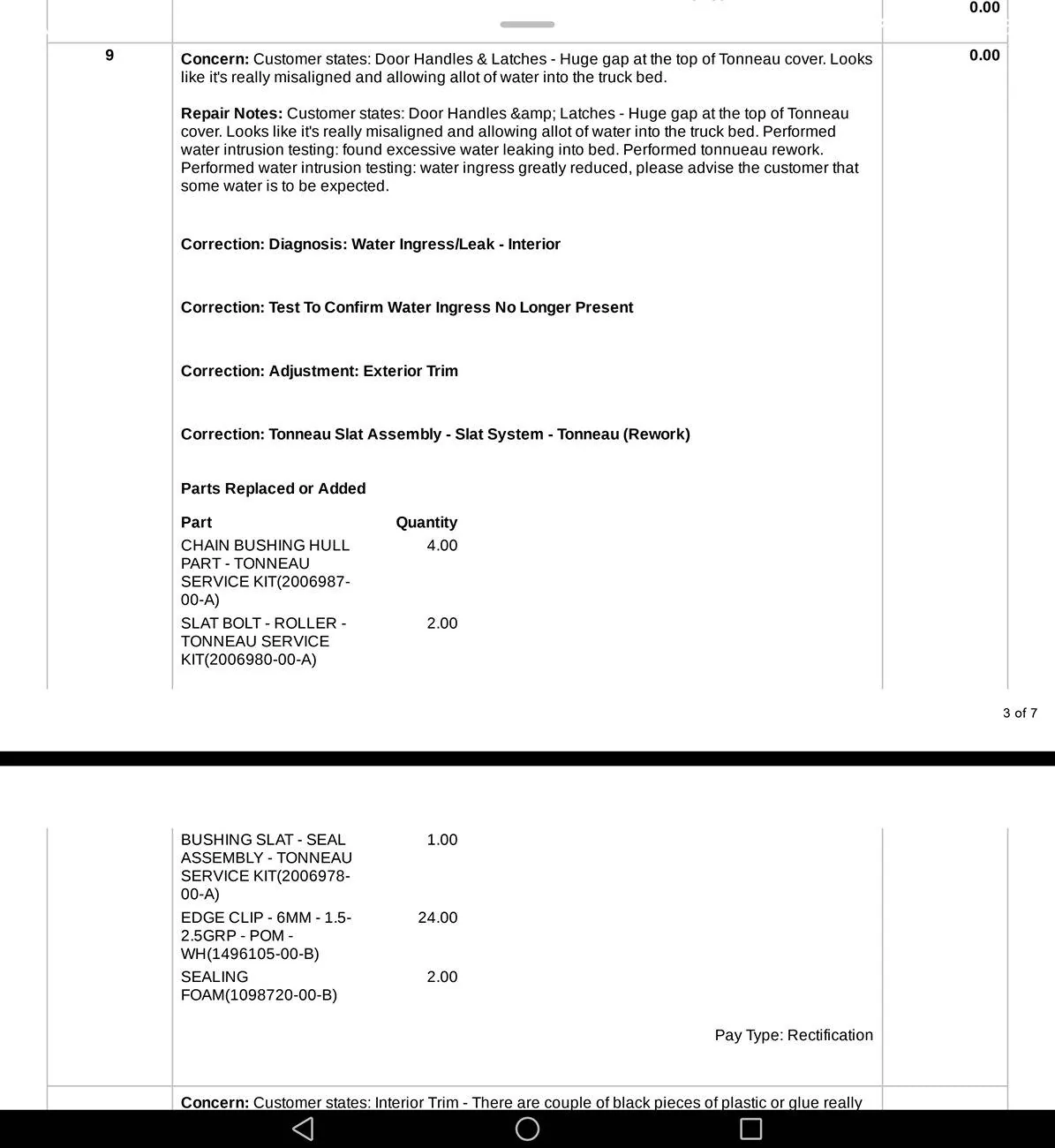

Tonneau cover gap issue fixed by Service Center under warranty

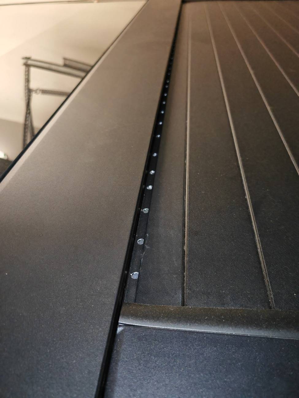

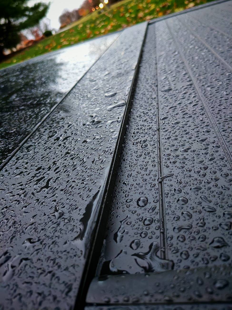

Can water still get out?
Very easily, they're loose flaps, only adhered to bed side, not tailgate side, but so little water is ever there now :). If tonneau is closed, entire bed is almost bone dry
