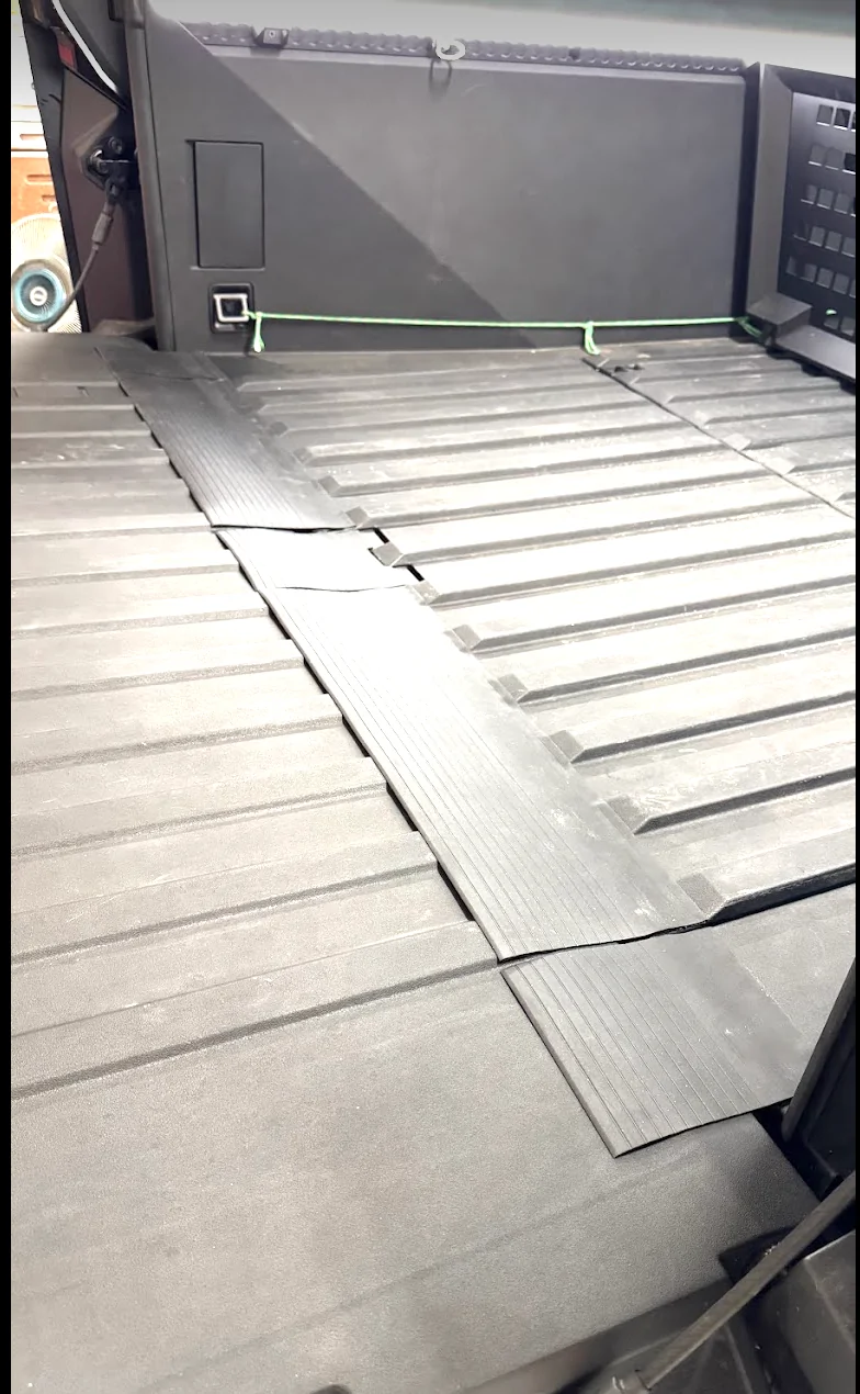

I got mine done yesterday by the Jacksonville FL SC. Everything they did so far looks good and it is working fine. No more leaks in the vault ether (I tested). I had much water leaking in before fix. Pics of invoice also for this fix. They started fixing at 11:00 am and finished at 1:00 pm.
Before slat fix done:
After slat fix done:
Water intrusion before fix:
Water intrusion after fix (pretty much none):

I just had the slat added and still have leaking :/
There are two points it can leak. Where the tonneau cover comes out and up between the top glass and the metal plate before the tonneau cover. The part right below the glass has had the material under the metal plate go bad on people.

Yep. I did this, even without slat fix and now mine pretty bone dry

So I had the rework done and they added one(1) slat. This helped mitigate the amount of water a good bit, but I was still getting more than I would have liked. I could still see where the water would run down the back window. Upon inspection I found where some water was gaining entry because of the appliqué. I then decided to put a bead of clear silicone across the entirety length of where the appliqué met the cab. This fixed the majority of the water in the bed. It still gets some, but only when I take it through a conveyor car wash.

Yeah, honestly, it was never really the water management slat. I still have it the old way. What almost 100% sealed it up was the replacement of the seal they placed under the applique. This video referenced the fix and once it did it, been almost bone dry every rain.
I also covered the gap between bed and tailgate and that vastly improved the dust and road debris from being sucked in like a vacuum. Gap shield. https://www.ecoological.com/gapshield.html#/
