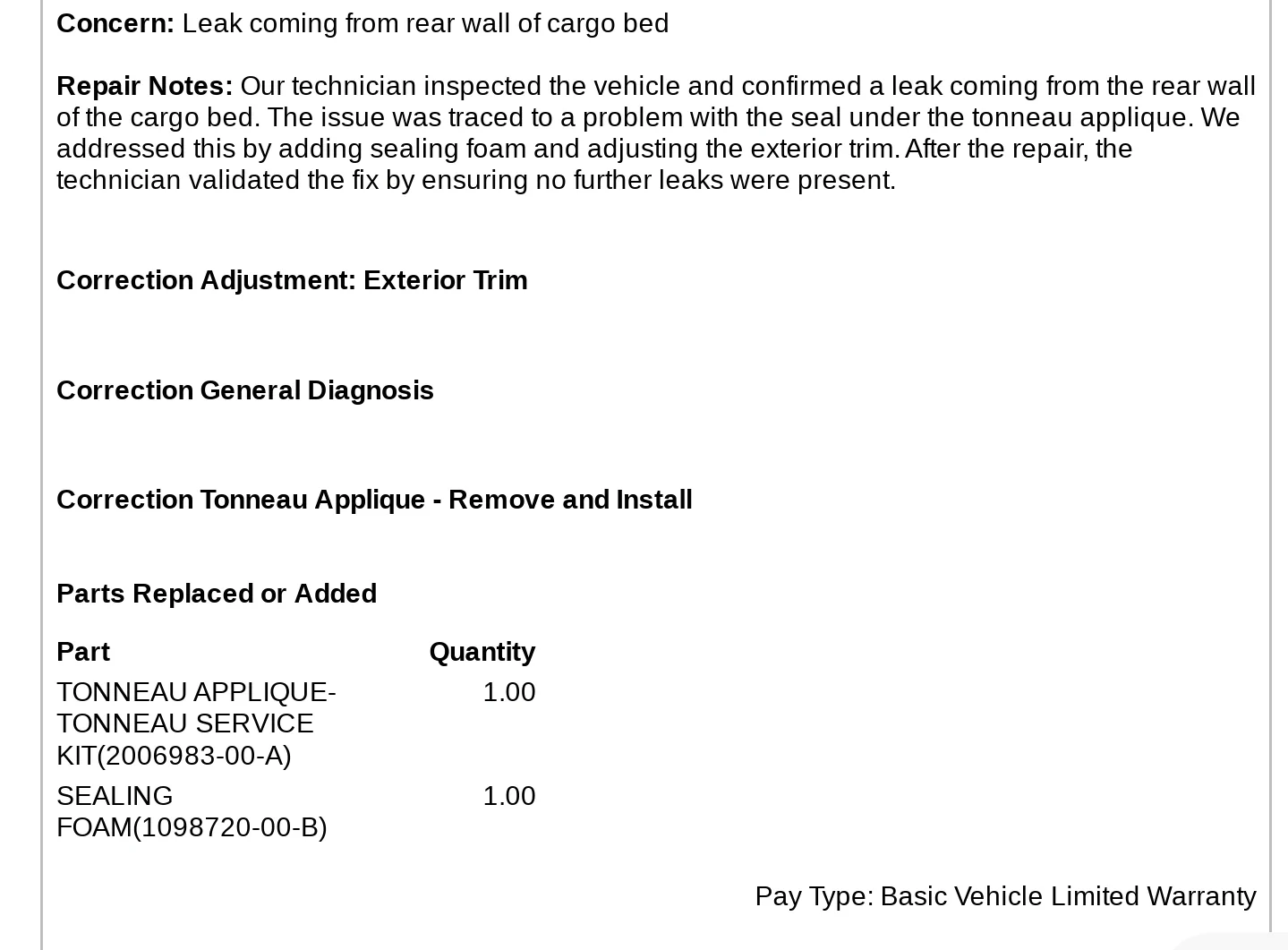

Tesla Cybertruck Official Fix: Tonneau Leak Foam Seal Screenshot_20260509_192922_Adobe Acrobat
Got mine done a few months ago. Had a 2024 model I took in there 3 times to address it and they said no. I gave up. Within spec. Never advertised as waterproof etc.
Took my 2025 in and just casually asked about it. One tech heard me and said wait, there's a new bulletin for that now. I'll take a look.
Addressed big difference. It still leaks but at high speeds while raining. I don't think I can avoid that but parked it seems waterproof.

Thanks for sharing. I have a FS AWD 13xxx and had the tonneau slat added. Still got some water intrusion. Was told essentially the same thing…‘not water proof’.
My CT is on Day 2 at the SC to fix connectivity and frunk issues. I just messaged them to see if they can add this concern and possible fix while my CT is there.

Good luck. It's not coming from the slats/tonneau. It's the plastic trim piece from the glass roof to the plastic piece that's leaking.
10,340
20,778
Guys, do you know how this "foam" is installed?
Yes, it's self-stick foam, like weatherstripping. The only thing special about it is it collapses very easily under pressure which means it wont cause the tonneau trim to bulge up in the center.
AFAIK this is the same foam strip that was applied at the factory from 2023 on (but wasn't always applied correctly). I took delivery of my Cybertruck in April of 2024 and it had twin waterfalls into the middle third of the bed (right under the tonneau trim piece). I removed it and noticed there were two gaps in the foam strip right where the waterfalls were. I pinched off some excess from either end (of the existing foam strip) and applied it to the two gaps and then re-installed the tonneau trim. Hasn't leaked since. It took 15-20 minutes.
