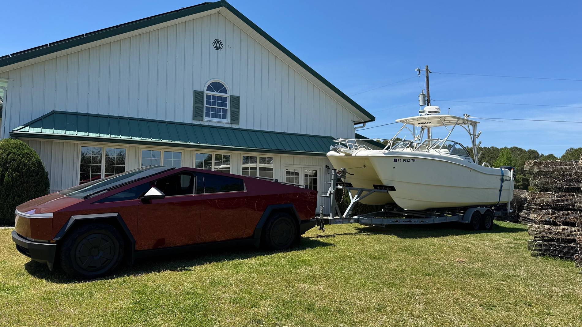

One thing I’ve been doing that makes life much easier when launching and retrieving - disable rear wheel steering.
4WS makes it kinda crazy when backing up, especially if you have a smaller trailer because the truck simply turns too tightly.
Launch OffRoad App, Turn off Rear Steering. Works like a charm.

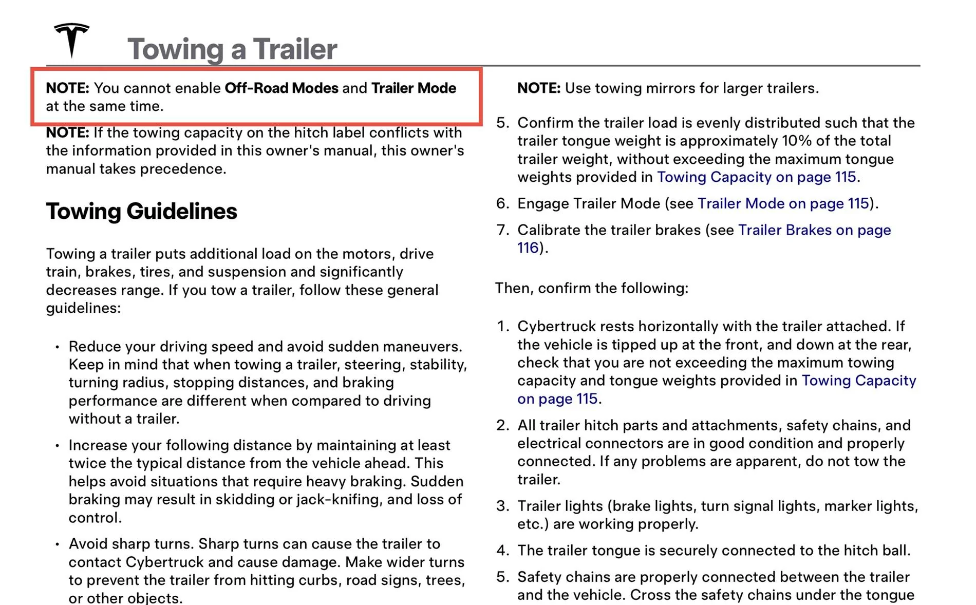

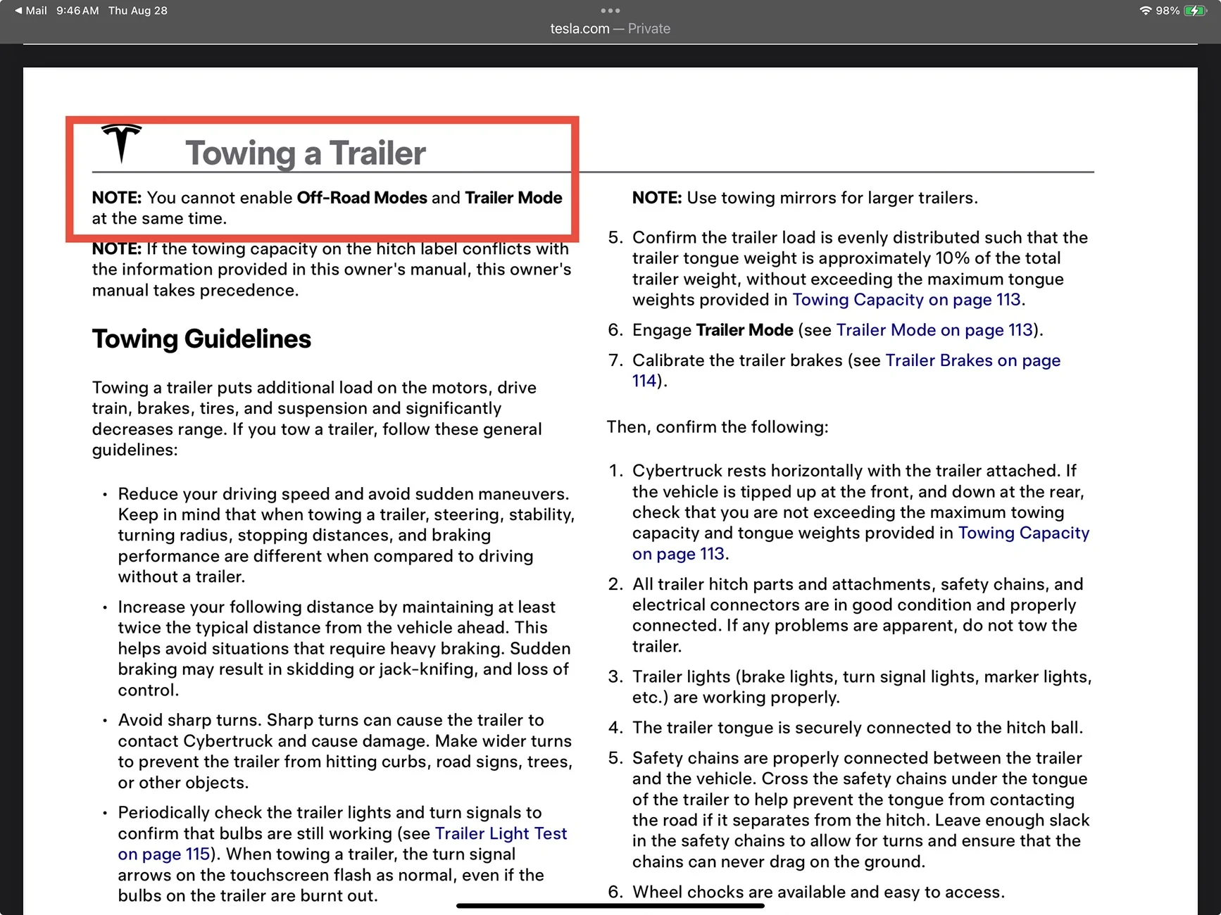

You can tow a trailer in off road mode, trailer mode just won't be active... So I guess no lights no brakes?
I might be incorrect in saying this, but if your trailer has electric brakes then I believe trailer mode must be activated so the Cybertruck will be able to use them.
But I suppose you could toggle things off & on as a work around. I don’t like doing that personally but we each have different levels of comfort when it comes to things like this.
