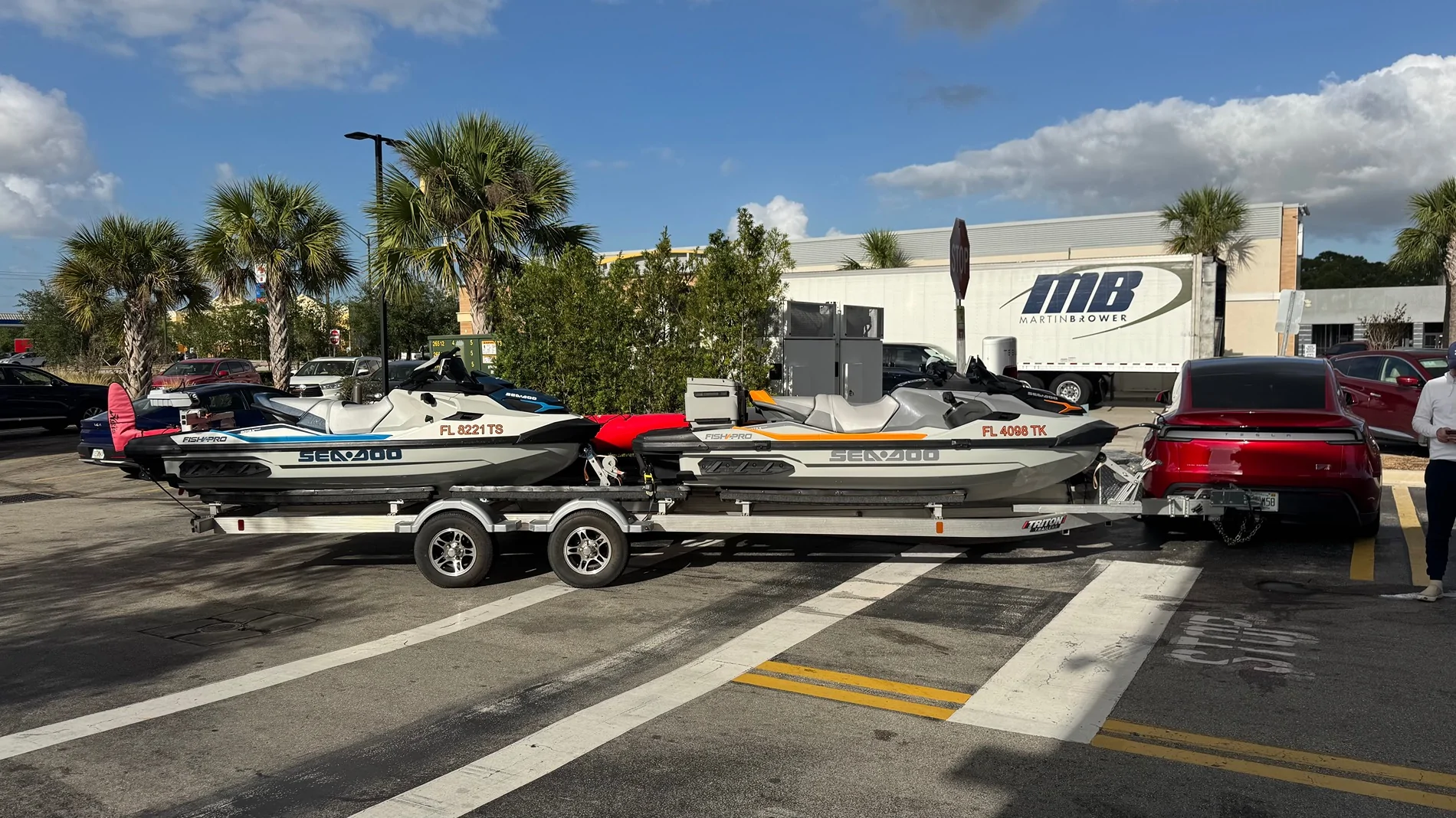

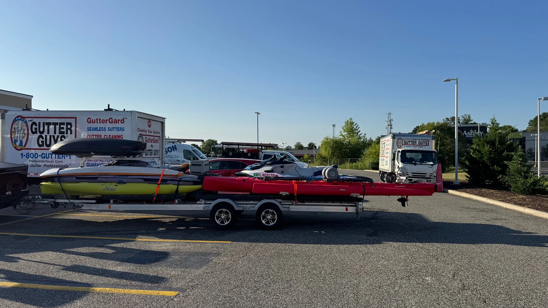

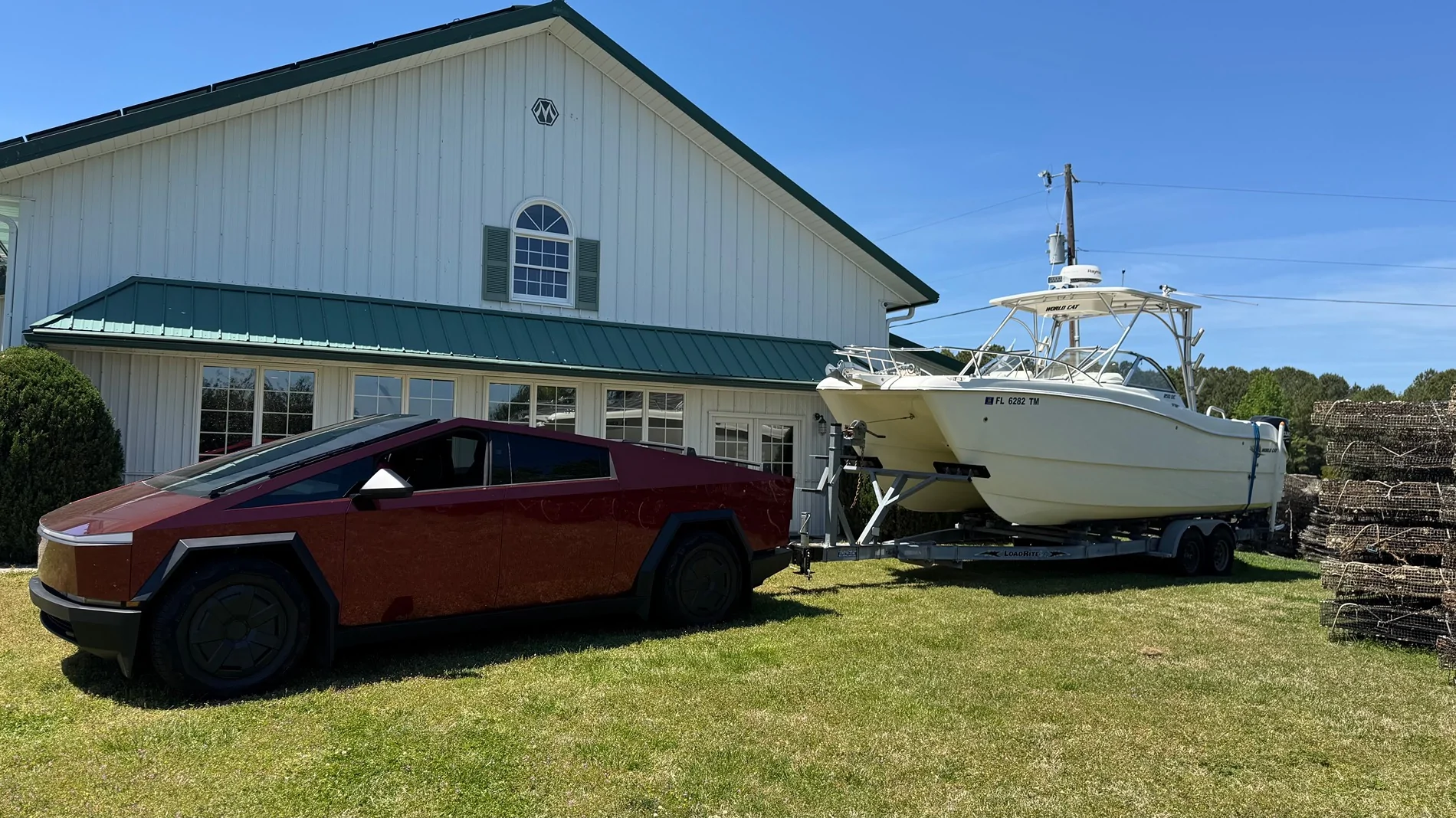

One of my boat trailers requires going deep into the water because
Tesla Cybertruck Towing a Boat/Dropping in Water Advice IMG_5385
Tesla Cybertruck Towing a Boat/Dropping in Water Advice IMG_4568
the boat sits above the trailer wheels. So I must put it in up to the bottom of the CT’s rear rims. The other is a four-place jet ski trailer, which all has to go far into the water to get the forward vessels off. That has a short tongue, so with a shallow ramp, I pull back to the point the water is at the back corner of the drivers door, but I can step out dry. In no case does the water affect mechanical or battery parts at the rear underbody or above. I do not elevate the suspension, but could do so if needed.

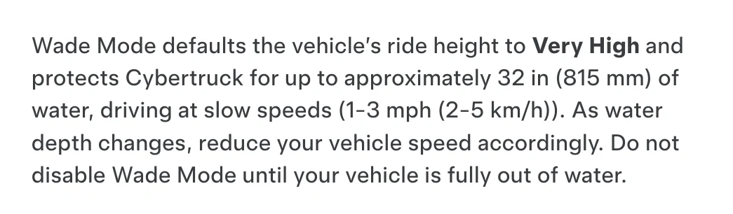

Wade mode doesn’t lower the vehicle. It can be used at any suspension setting. It pressurizes the battery so it can be submerged. Shouldn’t be necessary in any trailering scenario.
May 27, 2024
4,669
5,672
Wade mode raises the vehicle which causes the tail of the trailer to lower.
Tesla Cybertruck Towing a Boat/Dropping in Water Advice SmartSelect_20250827_142403_Firefox
the trailer's rear end will be significantly lower depending on how long it is.
