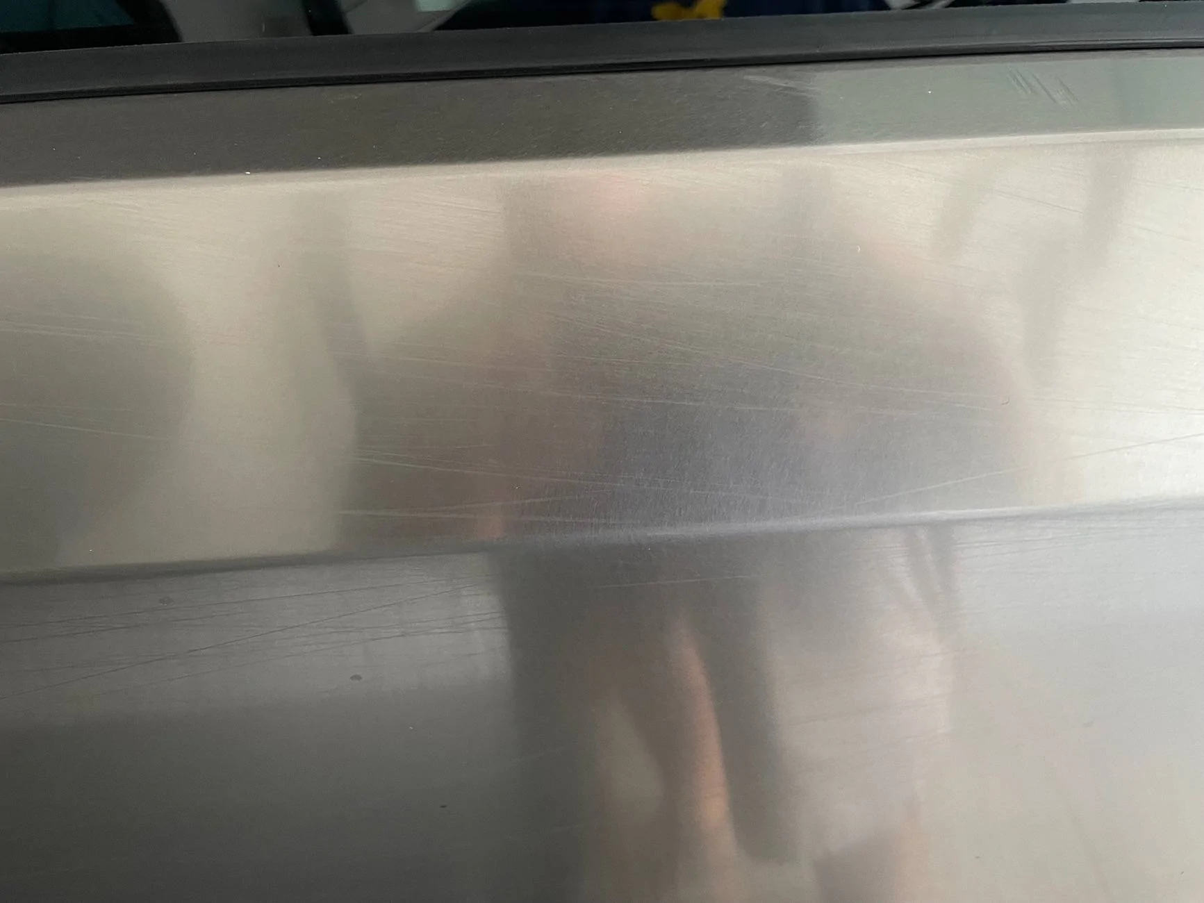

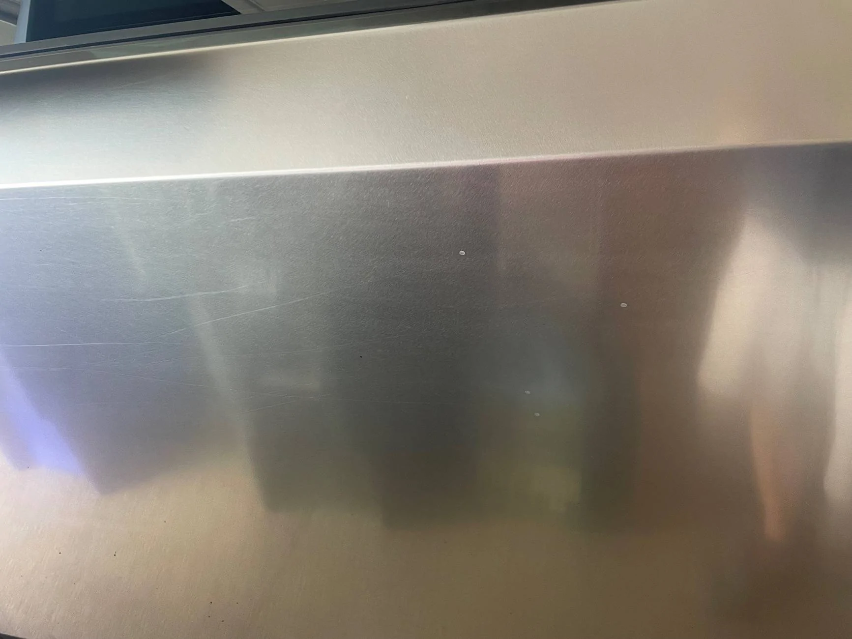

Had a great time going off roading today. Some trail rash on the stainless steel. very fine scratches similar to a car with paint. Any tips to remove them would be appreciated. If nothing can be done it’s a badge of honor.

bar keepers friend and a buffer. Not the high speed buffer, a small 6" bonnet dual action. then wash it or use spray away. it will be like new.

Thank you. I have bar keepers friend. I will grab the other items.

Since it's a sanded finish, does a buffer work? I have them from washing it?

Good thing you weren't driving a painted truck. Here is the link to Tesla service on how to fix scratches on the CT. There is a right way to follow for best results.
https://service.tesla.com/docs/Cybe...UID-D33D78C9-9BCD-46CB-885C-52B4F482852C.html
