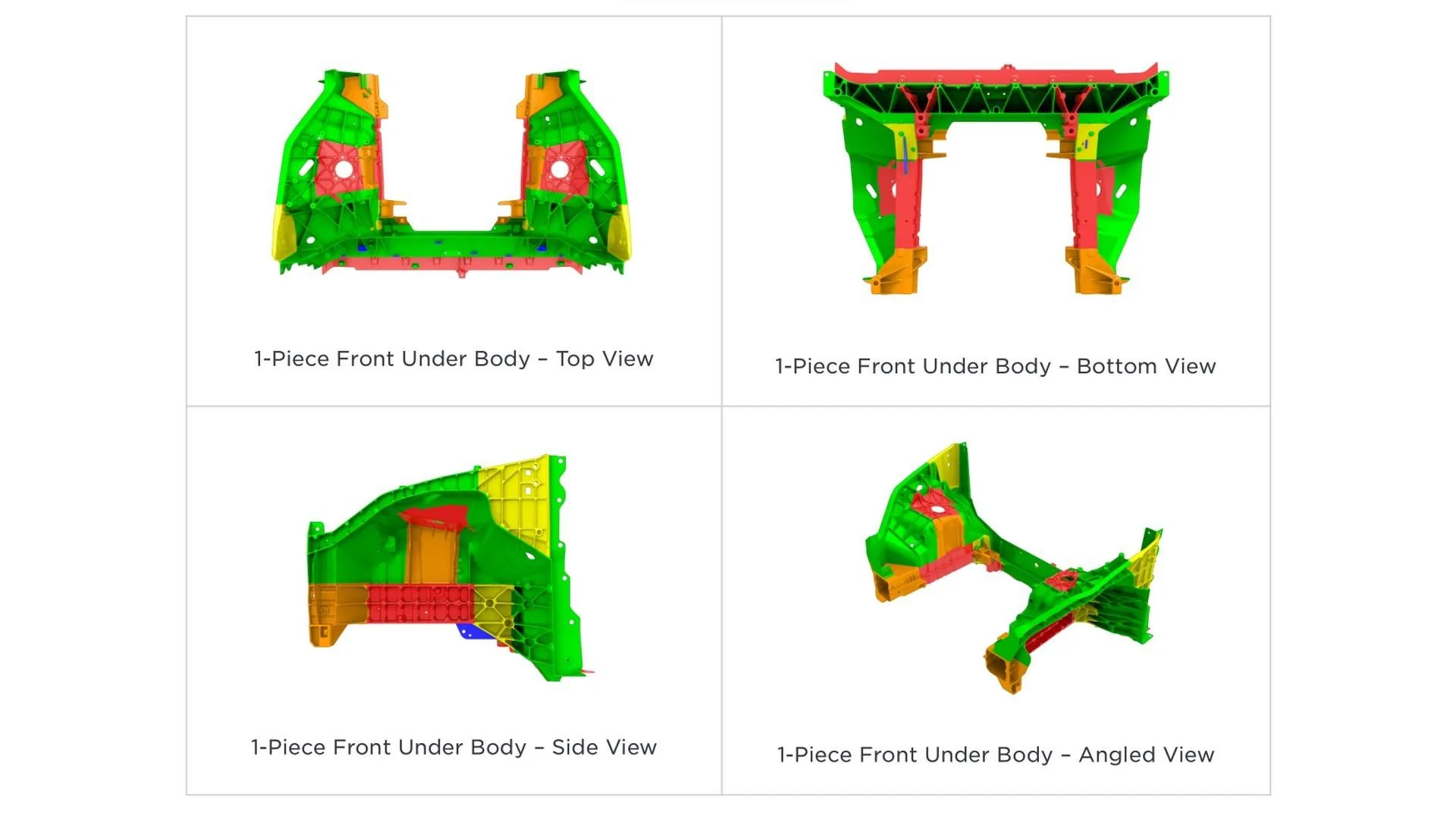

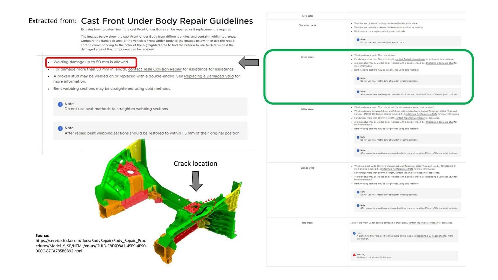

Is anyone else concerned about all four upper control arms mounting directly to the gigacasts? If these crack from a higher sideswipe or t-bone, then the cast is toast; these high-stress areas cannot be repaired. The center and inboard portions of the rails cannot be sectioned on Model Y's; neither can the strut towers, Cybertrucks will be the same. I wish Tesla did massive front and rear cradles that uppers and lowers attached to. Hopefully, they've engineered those uppers to collapse if impacted laterally. The repairability of these trucks is my biggest concern of all; everything else should be gravy... Can't wait to see the teardown and how they hold up during moderate accidents, should have about a year of production to find out before my number gets pulled... lol

This is no different than any other modern unibody vehicle. Even trucks wouldn't be immune to this; frame damage is lethal. At least to modern safety standards.

EXCEPT that Tesla has already said the castings are EASIER to fix than the OEM welded parts. They make jigs to cut the casting at a given location and there are already cast replacement parts to attach and go. Don’t think like the OEMs, think outside the box.

Yes and no, there are subframes out there that incorporate the mounting locations for the uppers. I'm not sure what lethal refers to, but frame damage is repaired on a regular basis (see Tesla's procedures for M Y). As mentioned, there are high-stress areas that OEM repair guidelines do not allow to be repaired. The upper control arm mounts will not be repairable as far as I can see. I work with Tesla's body shops on a frequent enough basis and will get to see how these trucks are holding up in real-world wrecks. Seeing these in the shop and at the auction yards will be extremely interesting. Crash tests simulate only a small portion of the scenarios that happen in the wild.
