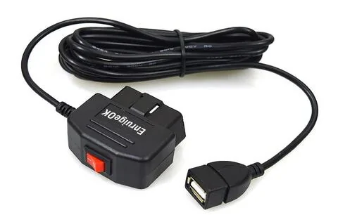

I was intrigue with the dual mode OBDII step down power cable that is included in the TSportline MagSafe kit. It has two modes: ACC and Surveillance. Supposedly, ACC Mode (position 0) powers the charger on when the truck is "started", and off when it's turned "off" in order to save battery. Surveillance mode (postition 1) provides continuous power to the charger, or other USB device, e.g., a dash cam or surveillance camera.
I was intending to use one of these ACC step down OBD power cables to automatically turn on my aftermarket side view cameras when driving and have them automatically turn off when not driving.
Tesla Cybertruck TSportline Magsafe Wireless Phone Mount (Install & First Impressions) Screenshot 2024-09-20 at 7.32.49 PM
As far as I can tell, these OBD 5Vdc power cables won't work on the Cybertruck, nor any EV, only cars with alternators. I was hoping the one that TSportline includes in their MagSafe kit would do the ACC function since they were installing it on a Cybertruck and specifically talking about this behavior.
So, I tested the OBDII port on the Cybertruck. Tesla's OBDII port does not maintain 12Vdc on pin 16 per spec. When the truck goes to sleep, power is lost. When the truck wakes up power is restored.
I measured the output voltage on pin 16 at 15.6Vdc whether the truck is parked or being driven. There is no way the ACC mode can detect which state the truck is in.
I asked TSportline about this, but the person responding couldn't give me an answer.
If Sentry Mode is off (like at home), OBD power will shut off 5 minutes after leaving the vehicle. Open the door and the power comes back on.
This not what I was hoping for. I'll have to include a manual switch on the step down power cable to shut off power to the cameras when Sentry Mode is on or suffer even greater battery drain while parked. This power cable will serve the purpose.
Tesla Cybertruck TSportline Magsafe Wireless Phone Mount (Install & First Impressions) Screenshot 2024-09-20 at 7.40.20 PM
At least I won't use up one of my USB-C ports.
Now the question is where should I mount that switch? I'm thinking out of sight under the steering wheel column.
If I'm missing something here, please clue me in. Thanks.

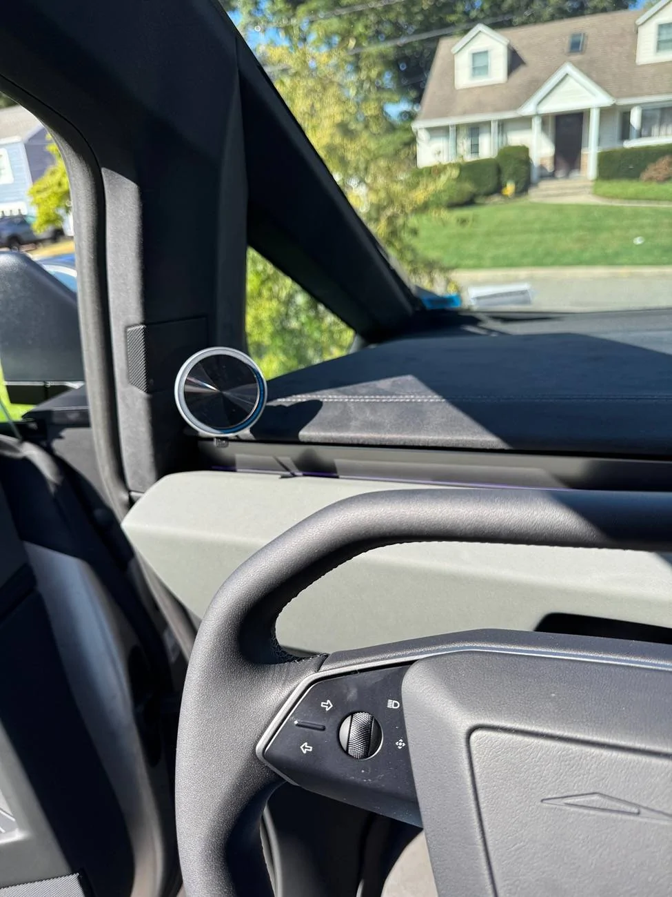

I just installed mine today. Took about 10 minutes and I too was also stuck with that first plastic piece. Yes pull hard enough on the 2 right places and I was able to take it off.
It looks great and right where I want it.
