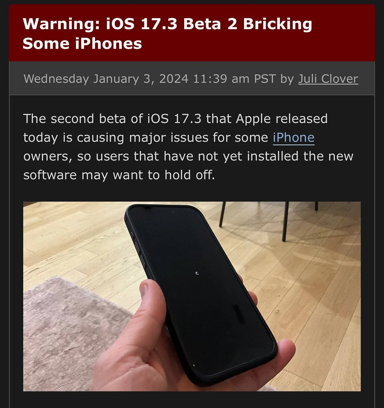

Tesla needs to allow external drive backups so you can reboot your Tesla like your phone.
Be an external drive or better just reboot over the air.
Would save a lot of trips to the service center.
But to brick the vehicle. Wow! And agreed a warning from Tesla would be nice.
Apple always tells users to back up their phones prior to update, just in case.
