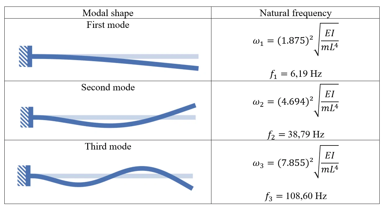

From a physics standpoint, makes sense. The natural frequency of the material can match with highway speeds. Adding weight would shift it.
Natural frequencies are wild, since you'll also have multiple for the same structure. Typically the first "mode" is the most impactful and it's the lowest numerically for Hertz. However you might end up hearing the others if they're in the audible range. The picture below shows the concept of modes but also how after the first one the frequency can skyrocket, well outside the audible range.
Tesla Cybertruck Updated Service Bulletin for vibrating front doors / driver side mirror 1760032109975-b6
An important thing to keep in mind with natural frequency is the equation:
Tesla Cybertruck Updated Service Bulletin for vibrating front doors / driver side mirror 1760031877547-qf
k is your stiffness and m is mass. The main thing that the butyl (or any sound similar sound dampening) does is to increase mass. This lowers the frequency, ideally down somewhere to where it blends in with the wind noise or is below the threshold for hearing (~20Hz).
