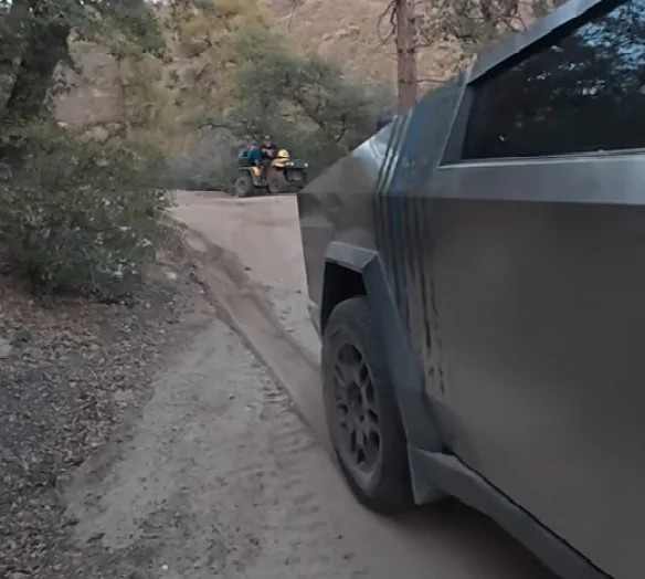

The owner claims it when into a unmitigated roll downhill. Brakes and regen were ineffective. They turned into the wall to avoid going faster and off a cliff. I cant imagine what would cause both brakes and regen to fail at the same time.
Edit: They stated in video that in offroad mode regen is disabled. Is that true?

In off-road mode, regen can be set to Roll mode. So regen will only work down to ~5 mph. Below that, it rolls like in neutral.
Trail assist prevents the problem. Can't imagine that was on in this case. Really helps control the roll from pedal to brake or brake to pedal. That gap in time can create roll and slip if momentum gathers and tires can't overcome. Trail assist prevents that gap in time.

Yeah, I was wondering HOW it lost its brakes
My brakes could have failed months ago, how would I know? lol
Agreed that total brake failure is unlikely, or at least no more likely than in any other vehicle; there's a brake booster, but it's a good-ol' fashioned hydraulic system that is not controlled by the computer nor electronics.
My best guess is that excess speed caused the overinflated tires to lose traction on the sandy surface, despite full braking.

My assumption is he was going 20 instead of 5 and just started sliding.
