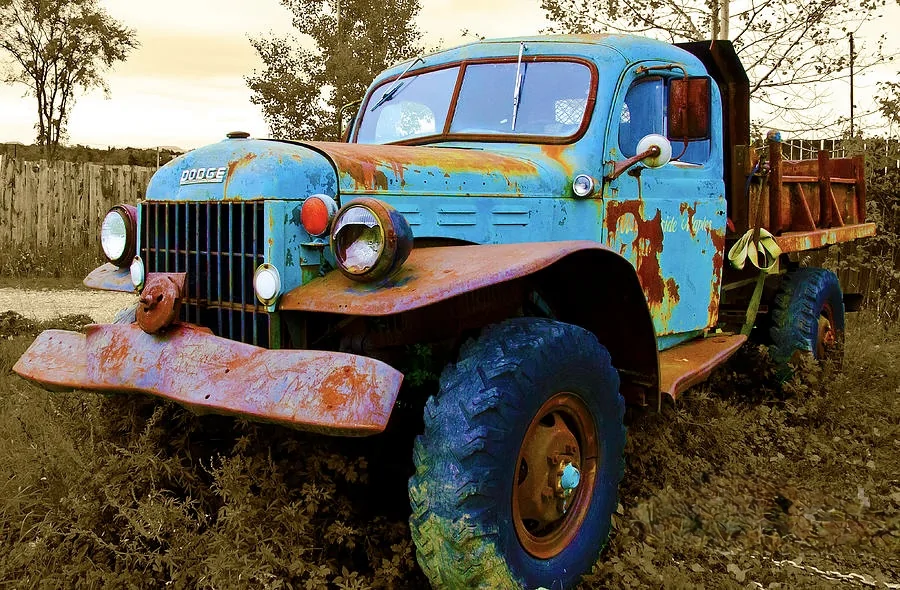

Just keep to the pavement or get a beater!
