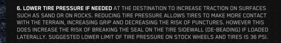

Does airing down to 36psi which is the lowest Tesla recommends really help that much or is it more technique? I don’t currently live near a beach but did when I was younger and if memory serves we used to de-air to a much lower pressure than that.
of course, those cars didn’t have a giant heavy battery pack in them.

36 psi is based on not unsealing the tire bead. Wes lost a tire at 25psi doing aggressive donuts.
When we went to Silver Lake Sand Dunes we aired the stock all terrains down to 15psi (park rules). That's right around the 2,000 psf value used for building foundations on sand.
But Tesla says, “hey, you’re like to lose a tire” if you do this. How did the car drive at 15 psi?
