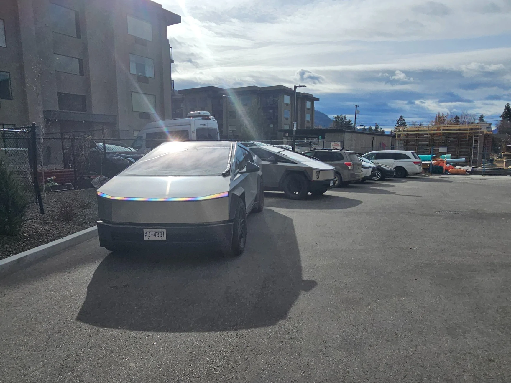

Update:
So at my last service centre appointment to fix a broken window button and a broken rear seat seatbelt button(🙄) I added my USB not charging the phone as an issue too. At the end of the day they handed me back the truck with the seatbelt and window button fixed under warranty but didnt really mention anything about the USB not working, nor did I bother to ask, I just wanted to get home.
Well two weeks later I got a message from Tesla saying I've been approved for a mobile service appointment at my residence! And today he came and replaced the charging module located under the cup holder. He said he was repairing my truck a few weeks back and when he plugged in his phone while working on the truck it wasnt working for him either!! Anyways long story short, dude was awesome, mobile service was awesome, and the phone charges like a dream now(finally)
