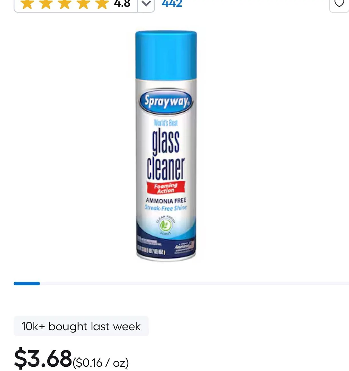

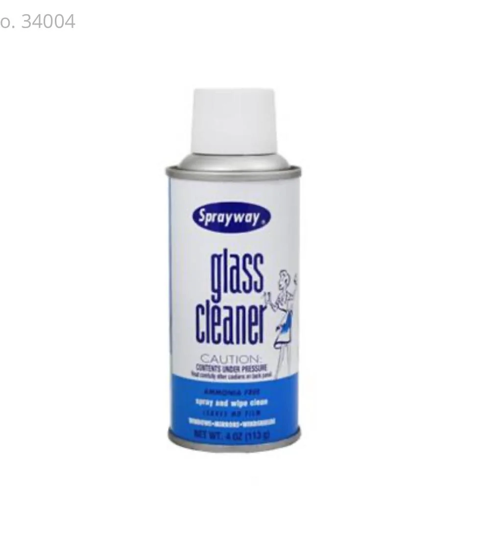

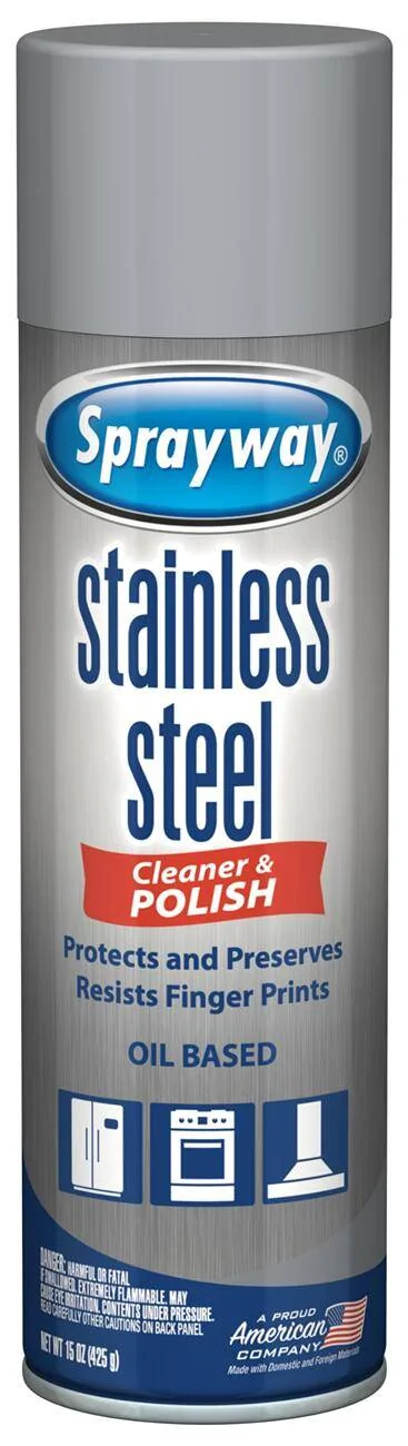

Which sprayaway do yall use? I saw a can at walmart but it said "oil based" exactly like the can below. I assume I need the one the says "ammonia free" ?
