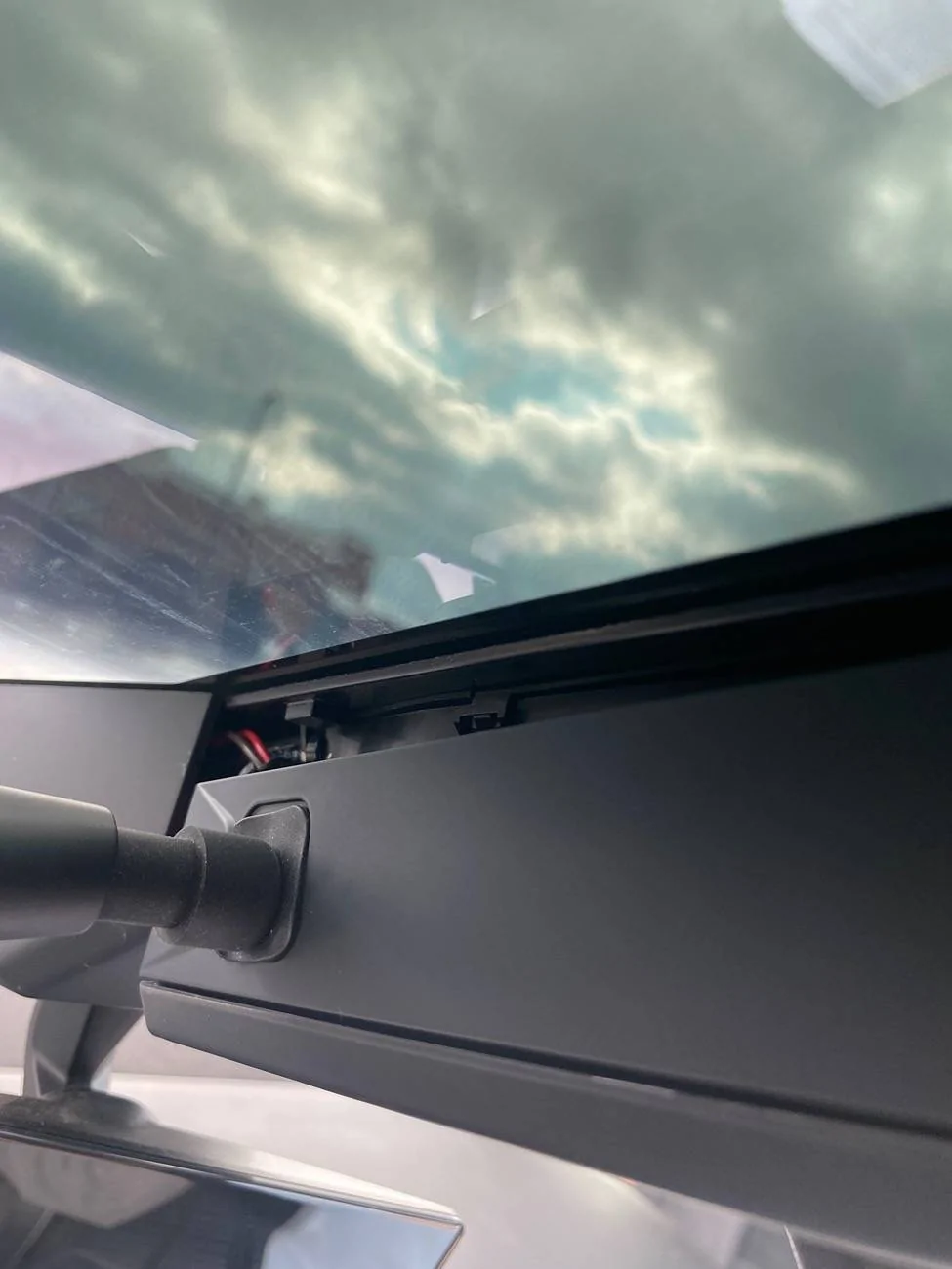

Yeaterday my wife wanted to move her visor to the door window to block the Sun. When she grabbed the visor and moved it the center box came off of its mount. When we stopped I was able to get it back in place but when the magnetic visor ends were placed back on it the weight of the visors pulled it down and off of the housing. I made a service appointment for the 24th. I can’t wait to hear from the service center how it was our fault. It’s just plastic and it came right down and now won’t stay up.

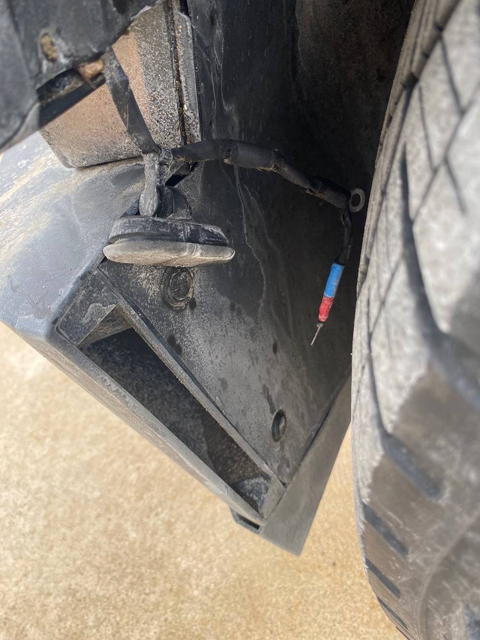

Ok. Now I found a sensor at the left front tire hanging. Just city driving sometimes in the snow but no off roading or mudding
There was an early service bulletin that fixed an assembly issue that didn’t let the console fully attach. Would have thought they were all fixed by now but maybe that’s it so I’d mention that to the SC.
https://service.tesla.com/docs/Serv...isor_Track_And_Windshield_Harness_Bracket.pdf
Not a sensor, that looks like the 9V/48V jump leads for a dead battery, just supposed to tuck away in the wheel well area.
Tesla Cybertruck Visor center box comes undone {filename}
The jump leads are behind a rubber plug next to the front-left headlight. It looks like yours got pushed through, you'll need to thread them back though this opening and re-secure it.
The procedure is here:
https://www.tesla.com/ownersmanual/cybertruck/en_us/GUID-4EC0FD18-0503-40FD-8C97-0F6BB39DA79D.html
