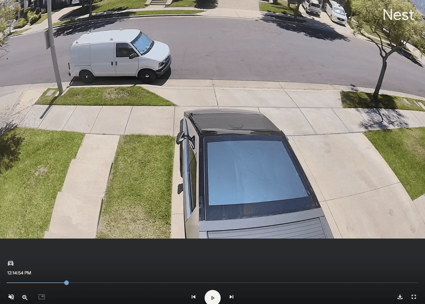

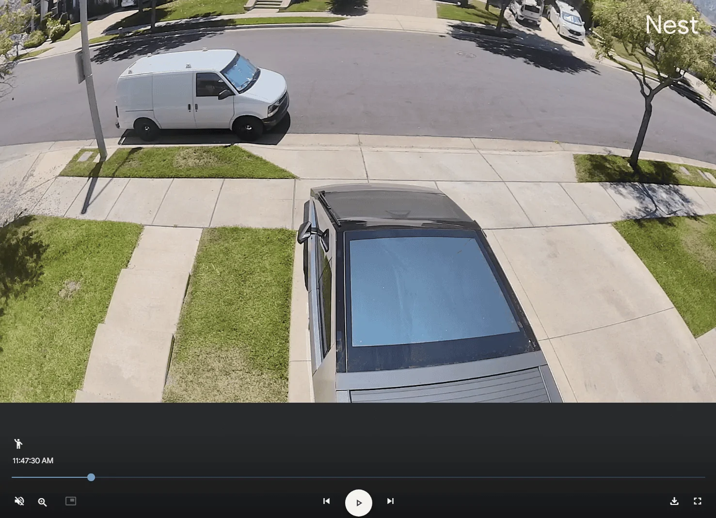

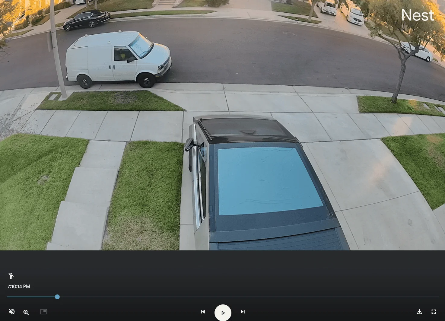

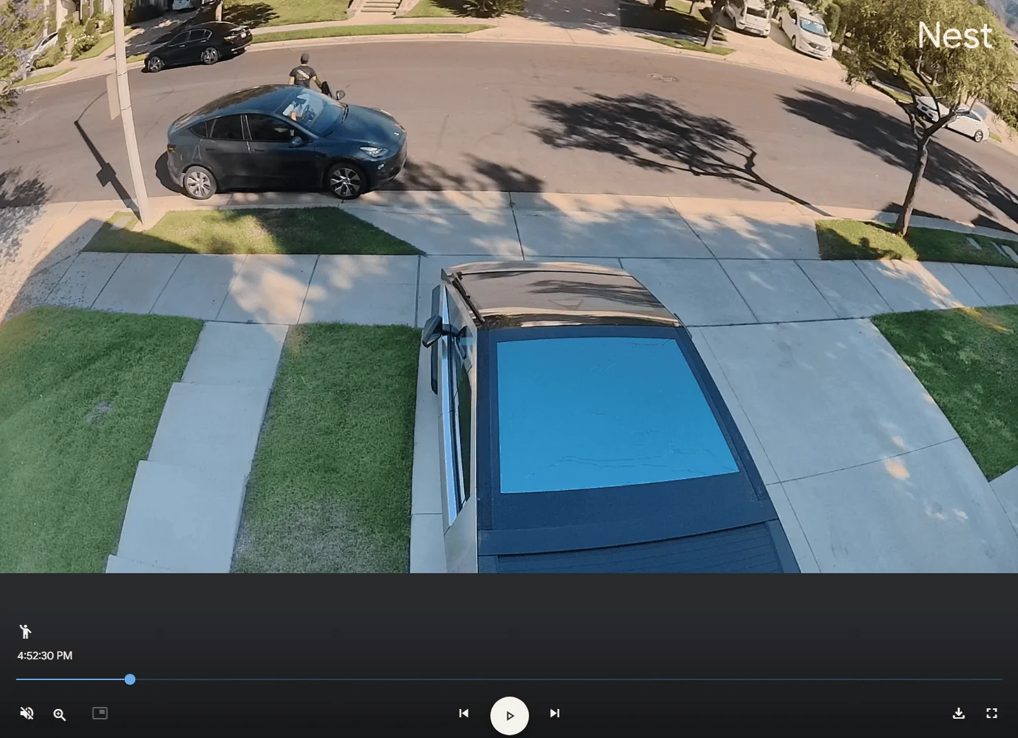

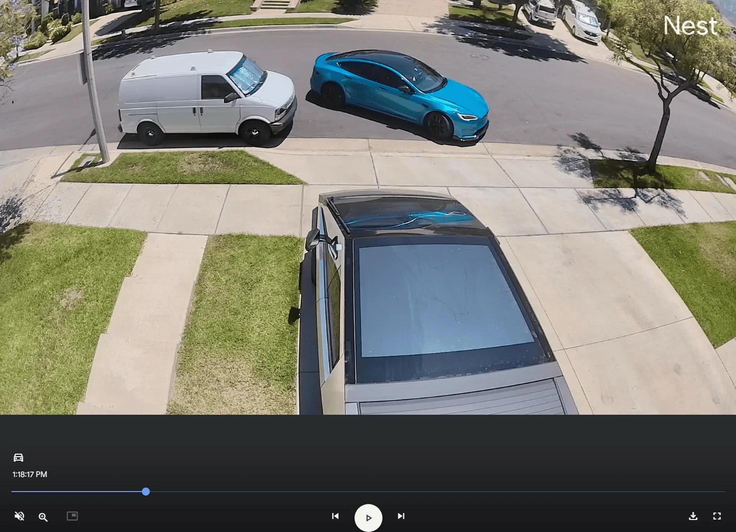

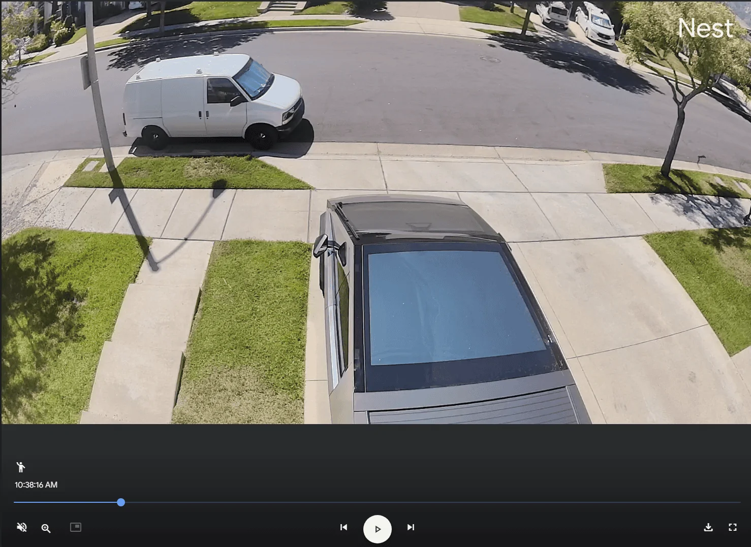

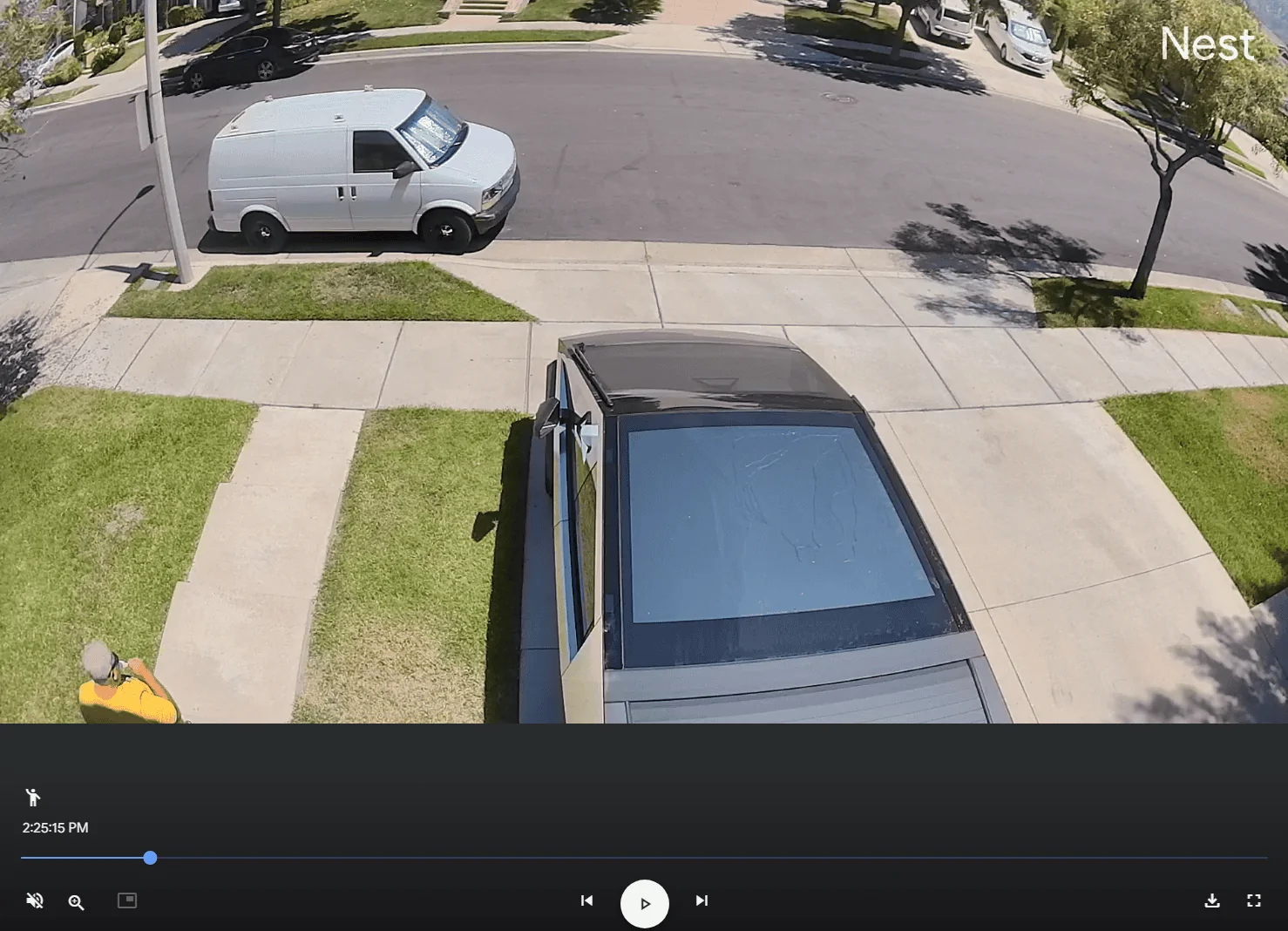

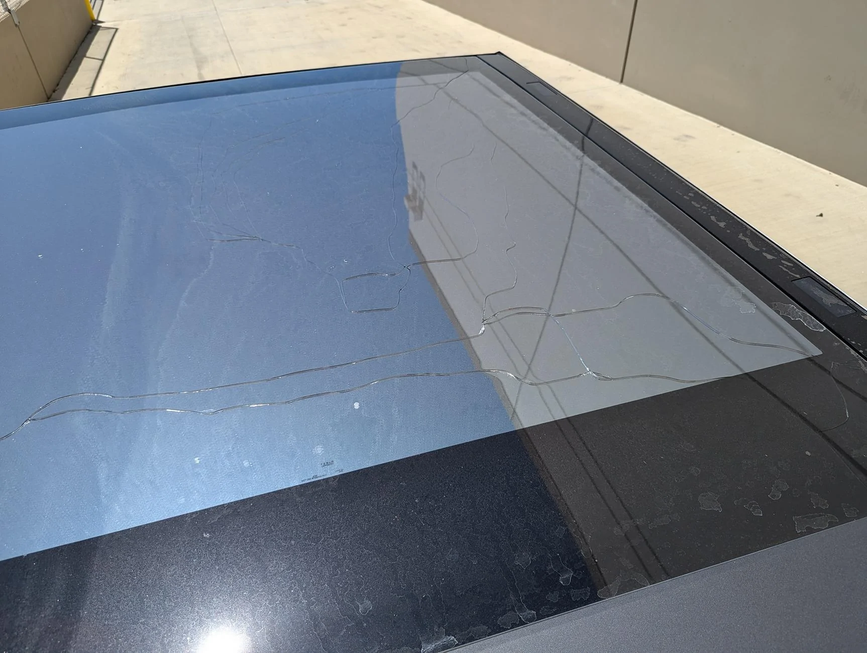

So I went to go pick up a new TV this afternoon and while loading the TV I noticed my ceiling glass had completely shattered. There was no impact anywhere and it spread all over the entire glass. I park in the driveway and have a camera monitoring events so I decided to go back through the footage and noticed that it happened yesterday. I don't have 24/7 recording so I only got footage every time someone walked by, but it was enough to see the whole progression throughout the day. It was a pretty hot day (about 100F), but my CT is parked in the driveway every day so this wasn't unusual. No one, and no water touched my car that whole day.
At 10:38am was the last time there was no crack in the glass. In the next photo you can see the crack starting in the top right corner. It didn't seem to have any predictable flow to it.
With each timestamp you can see the progression of cracking. Around 7p it had fully cracked as much as it was going to crack.
Not tinted, but I did install the mesh headliner sunshade thing it came with.
How it looked when I noticed it today
Must be a bad batch of glass

Did you have any extra tint or the sunshade installed? I am wondering if reflecting/rejecting more heat into the glass can increase the chances of this happening. Regardless this should be a warranty issue.
What’s with all of you? The guy clearly said it wasn’t tinted.
